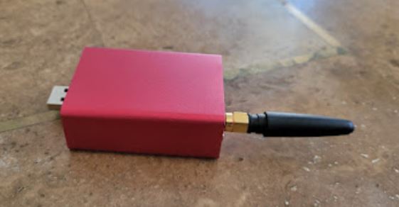

Victory is mine. (Thanks VERY much to @aaiyar for the case!).
Freshly customized case w/sensor inside.

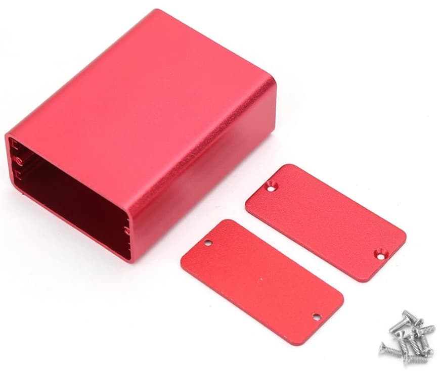

@aaiyar what case is that?
https://www.aliexpress.us/item/2251832867134088.html
What did you use to cut the holes in it for the usb?
I broke the one that I was given. So I bought 3. I ruined the first one by using the wrong dremel bit. Then I got metal cutting dremel bits (harbor freight), and cut the USB opening to be about 2 mm larger than needed. For the other end, I just used a metal drill bit. I’m using this one. I sent the third to @danabw.
You can also find this on amazon, albeit for a lot more.
LANTRO JS Frosted Red Aluminum Project Box, 23x44x60mm PCB Junction Box Aluminum Enclosure PCB Instrument Cooling Box Electronic Project Case https://a.co/d/fLd4knh
I did the same thing that @aaiyar did, sort of. :wink:
I used a metal bit to drill the hole for the antenna.
Then I was going to use a larger bit to drill a starter hole for the USB connecter and finish w/the Dremel. Then I realized that I also lacked the right Dremel bit, but I was not patient enough to wait until I could buy one, so I used the same bit to drill a second hold right next to the first, and using the drill "adjusted" the opening until it was sufficient for the USB connector. Not terribly pretty (really quite ugly), but my handiwork is well out of site in the case's mounted position so only I know. (Well, we all know now, I guess, but I trust you guys.) :wink:

It is easy to DIY it if you have a drill/metal drill bits and a vice to hold the case. Having a Dremel w/metal cutting attachments would allow you to do a neater job, but if you aren't picky about how it ends up looking (i.e., it's going into your glove box, or attached to the bottom of your dash or something, then you can do the whole process w/a drill and a couple of drill bits.
