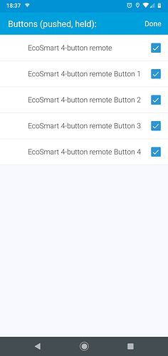

I was able to pair a remote to ST & sync it to HE using Hubconnect. ST gave me an option to sync it as 4-button remote or as each button individually. I tried it first just with 4-button but when I got into creating a rule, I wasn't given an option to assign a button:
So, I went back to trying one of the Ecosmart ST buttons individually and use that in a RM and I was able to turn on/off a light with Hubitat. That seems to indicate it will work but that I might need 4 rules/remote. Of course, I could be doing something wrong with the 4-button. I literally just did this less than 10 minutes ago.
