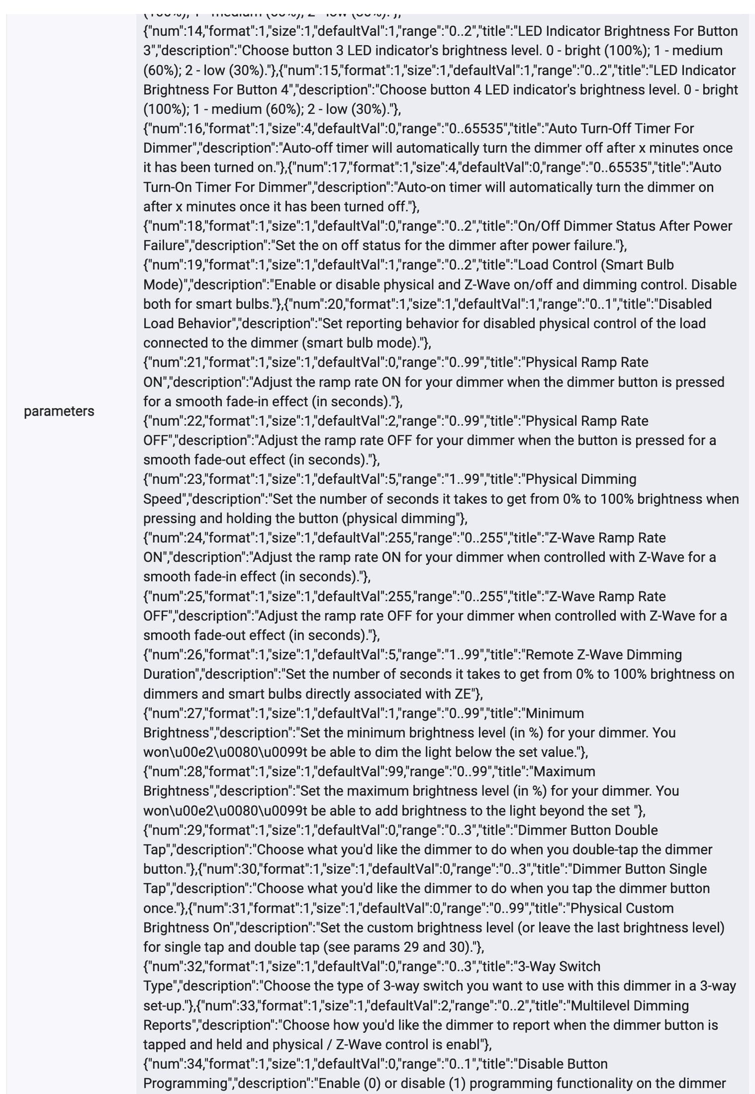

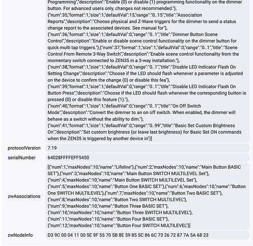

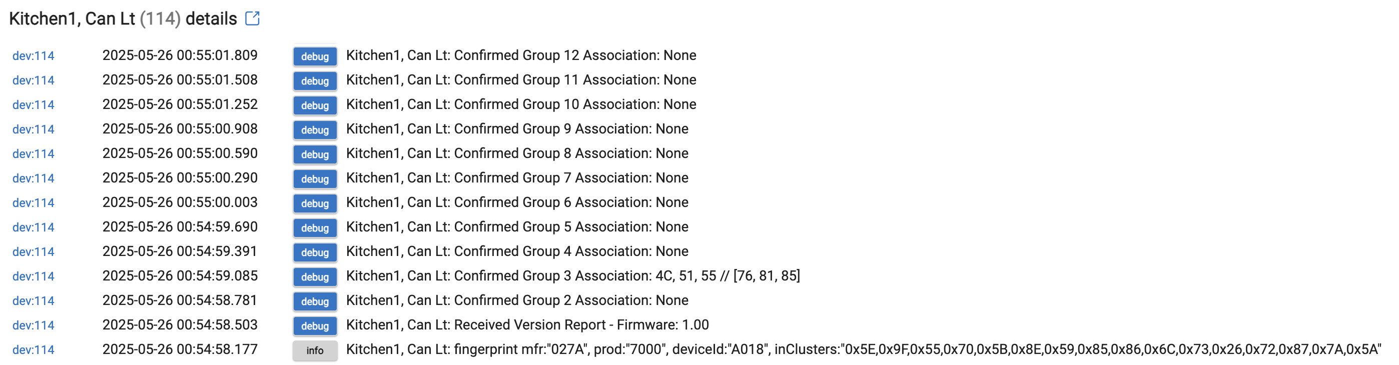

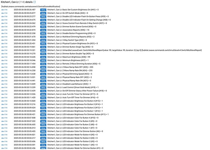

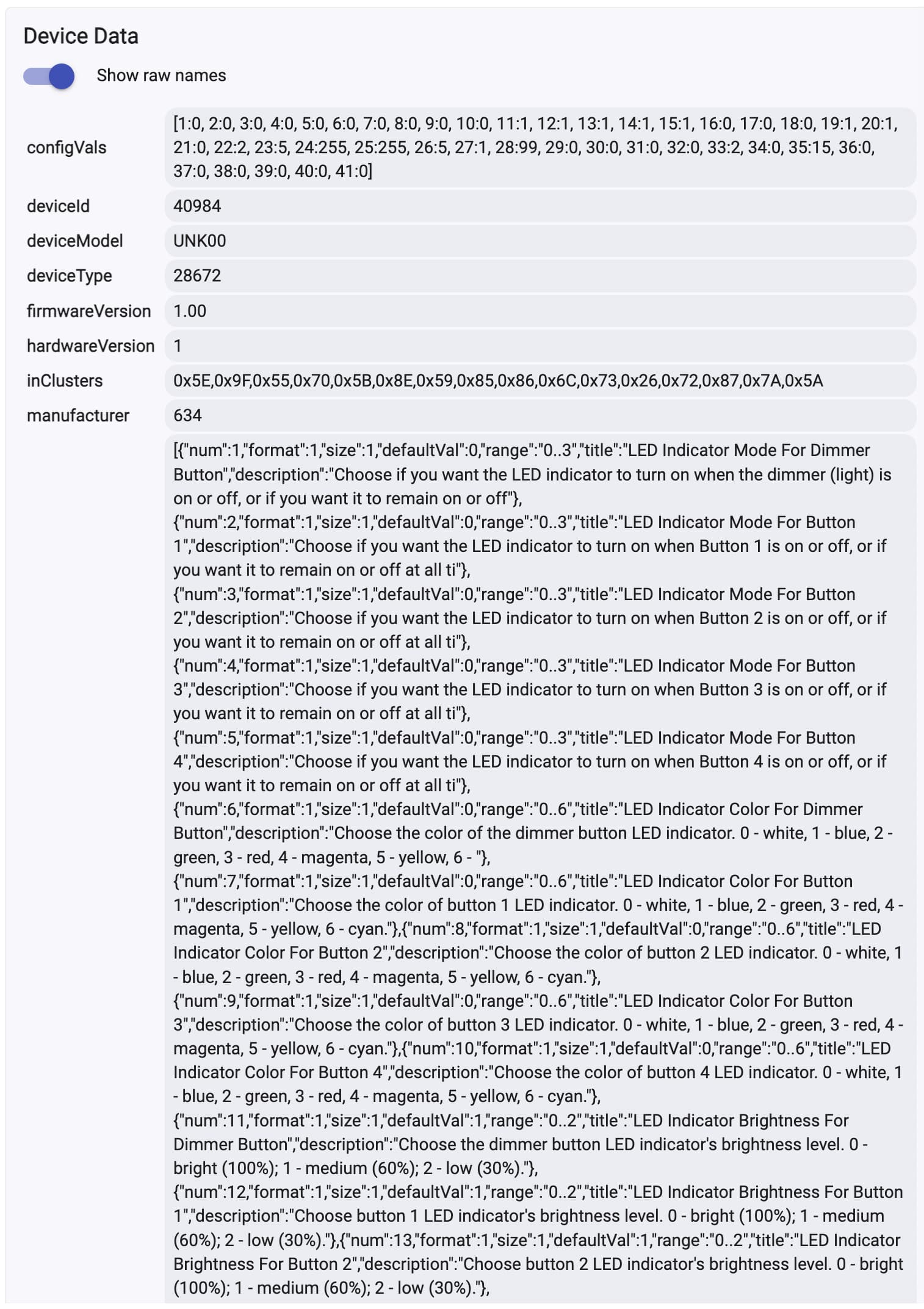

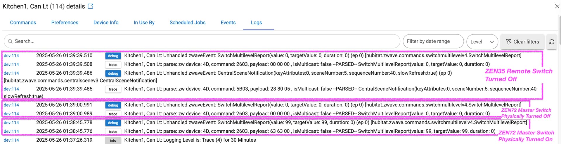

I have attached screenshots of:

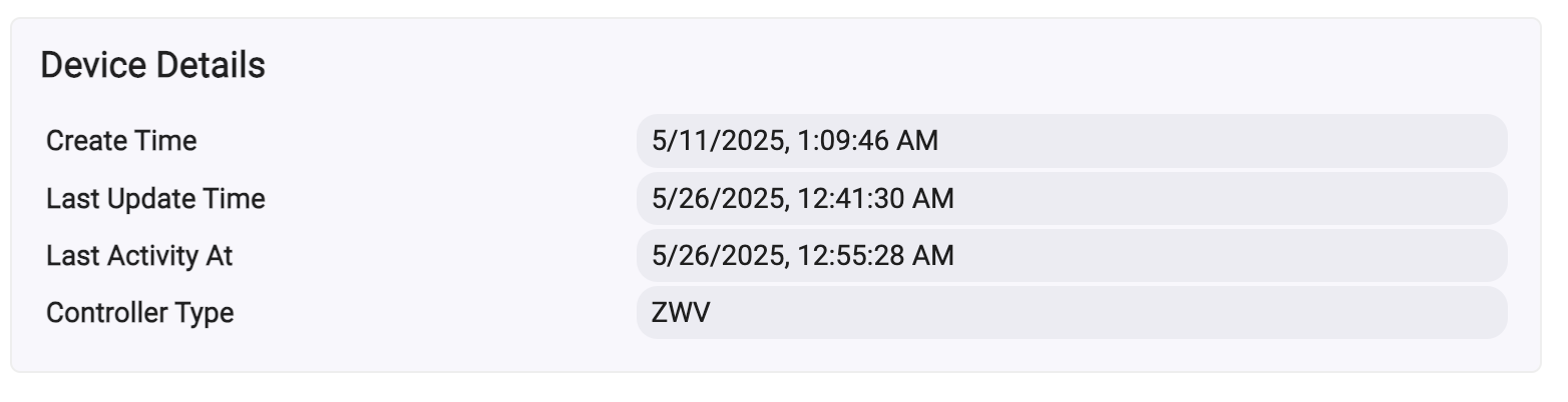

  • Configuration of the ZEN35, including parameters, associations, device data.

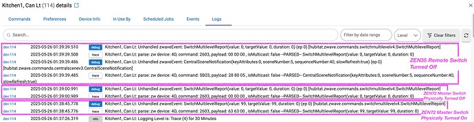

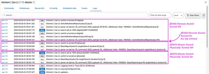

  • Logs from the ZEN72 master switch.
  • Logs from the ZEN35 remote scene controller.
    The logs include the scenario where I physically turn on, then off the light load from the ZEN72 master switch. Then, I turn on then off the light load from the ZEN35. Note that there are no log entries for when the ZEN35 receives a physical button press of the main button to turn the light load on.
All actions with the ZEN35 are with the main button (button 5); no other buttons (1-4) are used. No rules or other programming in the hub is configured for either switch or the other ZEN72 remote switches. I previously had a rule that synced them together but it was deleted hours before these log entries.

I have the ZEN35 driver in the Hubitat but have been using @jtp10181 's Z-Wave Universal Scanner to access the direct association groupings. And, from what I can tell, these are actually syncing into the device.

ZEN35 Parameters
ZEN35 Associations
ZEN35 Device Details
ZEN35 Device Data
ZEN35 Logs (during testing)
ZEN72 Logs (during testing)

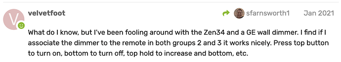

I wonder if parameter 40 should be 1, to enable on/off switch mode?
You're not dimming a light, you're associating with a switch.

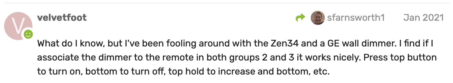

See Zooz ZEN34 associations for reference
Thank you @velvetfoot for suggestion.
Tried it, unfortunately no change. Still having issue. I am using the ZEN35 primarily as a switch (tap only) but theoretically could also use as dimmer (tap-and-hold). I'd settle for simple switch function only (i.e. Group 2).

So the main issue seems to be that the ON press on the ZEN35 does not seem to be sending any reports for ON, nothing to the hub or to associations.
I would first go through and change all the settings on the ZEN35 back to the defaults (except maybe LED setting could be left alone). I don't think any of the settings need to be set a specific way for your associations to work. For example I noticed you have scene control (35) disabled, default is enabled (1). Not sure what else has been changed.
I have personally tested the device on another hub so I know it does normally send the reports over. I am guessing one of the settings you changed has created a conflict and is a bug in the firmware. Could possibly be just having the association group 2 set is breaking it. With so many settings it is not feasible for me to test every single combination.
First thing to do is getting the on/off reporting working correctly for the device itself. Then I would add the associations and see if it still works. Then from there you can change settings one at a time and test.

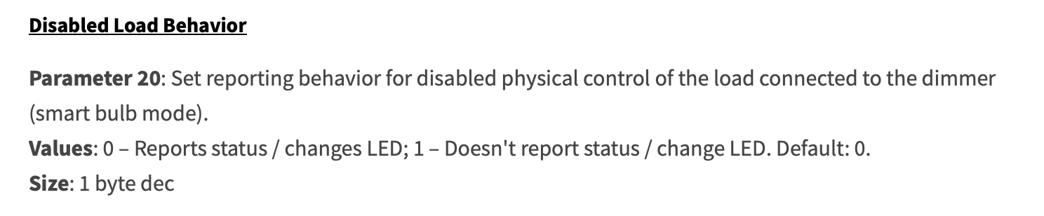

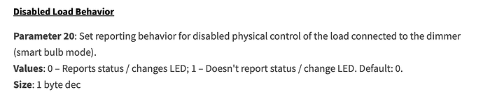

How about parameter 20?
You have it set to 1.
edit: That's probably not it either....physical control, although, maybe?
One last thing and I'll bow out, ( @jtp10181 is the guru, so listen to him), I came across this in an old thread: (that was dimmer related though)
What is that? Is that from the Lighting App (which I'm not familiar with)? Sounds like Zigbee.
