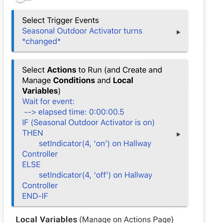

I got it figured it, learning curve with Rule Machine. And also wasn’t sending everything the SetLED needs. But a follow up question, is it possible to do this with one rule or do you have to have two rules?
Like this?
Yea something like that, how do you get Rule Maker let you directly enter code instead of having to use drop down boxes?
setLED() is a Custom Action for the Z32 switch device. In my post above, I linked to Robert's explanation for how to set up the custom action.
Use "Run Custom Action" in rule machine.
If you only want to turn the LED on and off I would suggest using the setIndicator command as I have shown, because it it will only send one command and does not change the device settings.
setLED however will send up to 3 commands and also changes the device settings.
