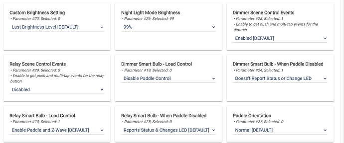

The screenshot below shows how I have parameters 19 & 24 configured. (19=Disable paddle control; 24=don't report status or change LED)
