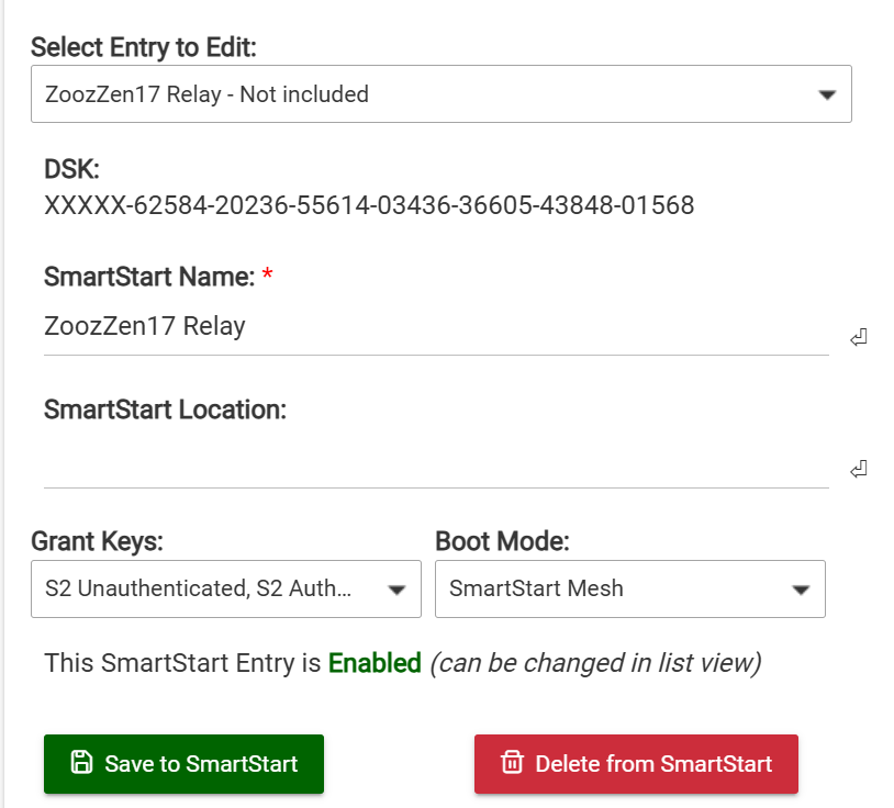

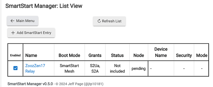

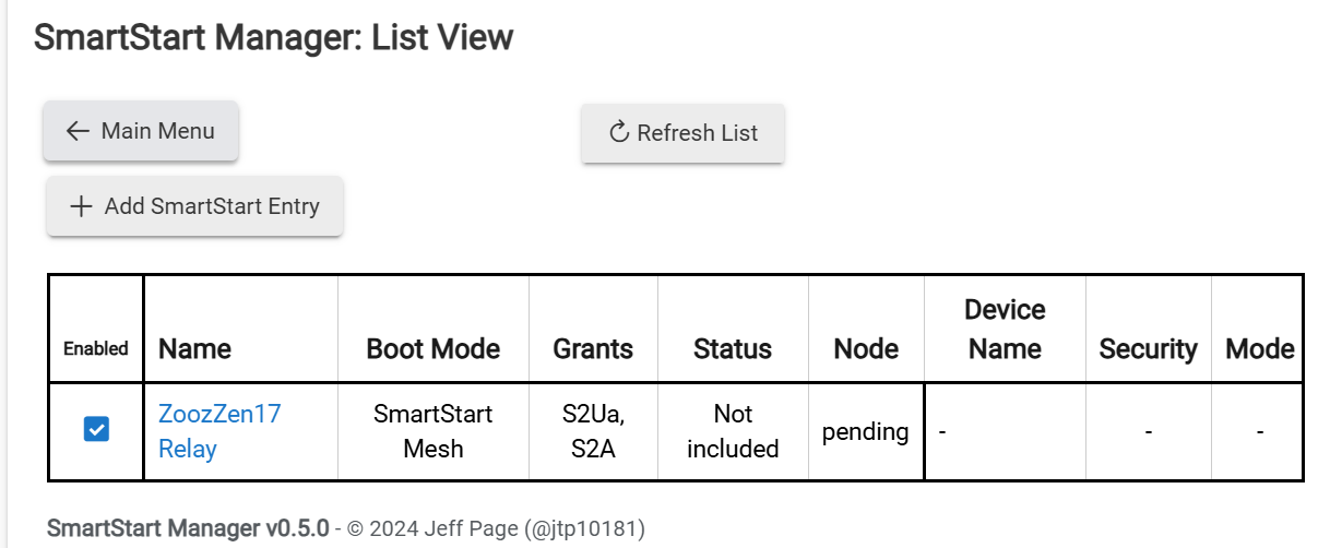

During upgrade from C7 to C8 Pro, my Zen17 relay (working as a garage door opener) didn't successfully transfer over. Followed all the process steps to add it using SmartStart. The device is stuck on "pending" status for almost an hour. Screenshots below:
Any suggestions? Thanks!

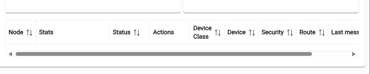

Do you now have a pile of ghost nodes on the zwave details? May need to get rid of some of there are. Or at least shut down the hub again and restart.
This is my only z-wave device. There are no others listed in the SmartStart device list

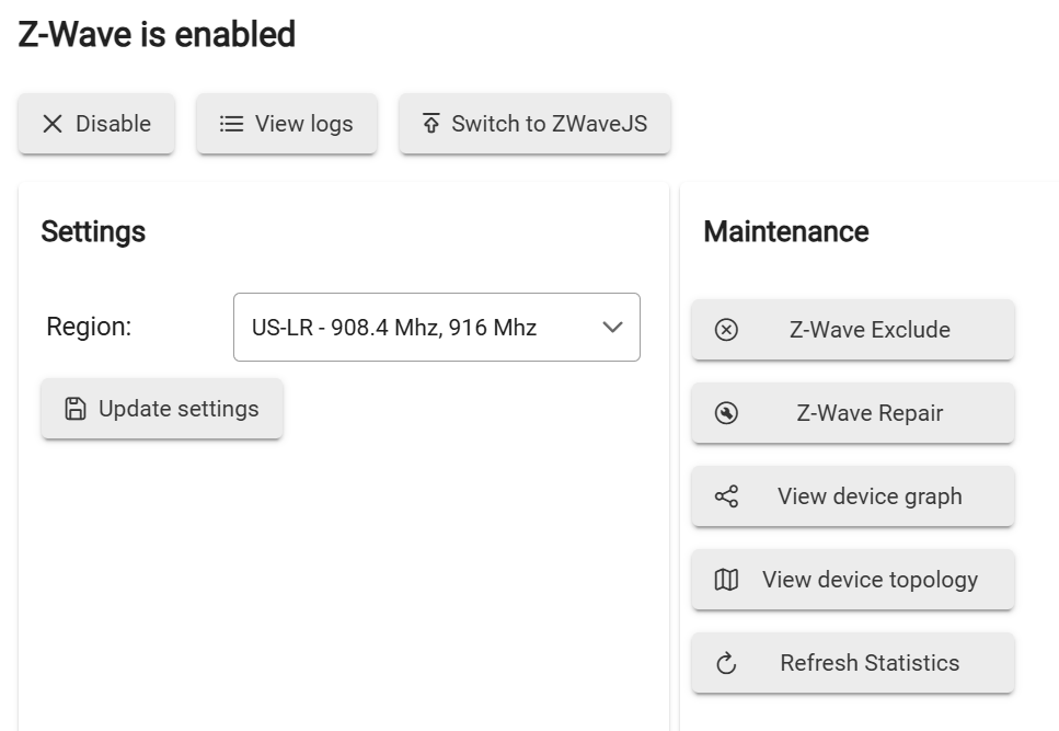

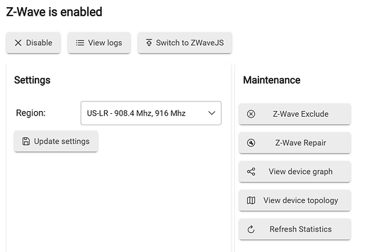

You need to look at the zwave details page. Smart start is just for pairing, not devices on the radio

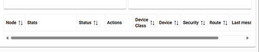

To check for ghosts, go to "Settings" then "Z-Wave Details"... Are there any entries in that table? If so, post a screenshot of them here.

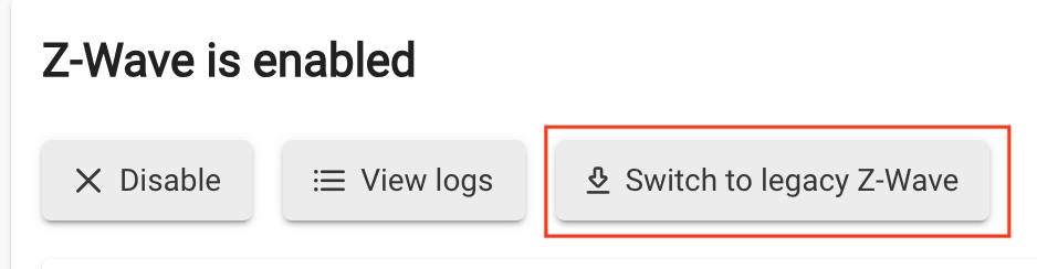

At the top of that same Z-Wave Details page, if you're on JS (new option just for C8-Pro), you'll see the same button as shown below. If your on (legacy) ZIP, that button will say something like "Switch to JS"
I checked the Z-Wave settings page. There are no entries in the table (no ghost nodes), and the "Switch to ZWaveJS" button is visible ( already in Zip mode)
Screenshots:

I reset the Z-wave radio using the hub diagnostics, then attempted the smartstart pairing (sequence I used is below). Same results - pairing times out and status of the device in the SmartStart list never changes from "pending". Here is my sequence:

  • Added Zen17 QR code to SmartStart using mobile app & camera
  • Opened new logs window for hub. Verified new entry in SmartStart device list with pending status

You could also try switching to ZWave JS using the button on the Z-Wave details page, and then try pairing it that way (either pairing method). If that works you could switch back to legacy ZIP since JS still has some issues right now.

I will try switching to ZWave JS ...
Switched to ZWave JS. Same results. Neither z-wave device will pair with the C8 Pro hub. I have one last thing to try - I will shutdown the C8 Pro hub and power up my old C7 hub and try to pair the Zen17 to the old hub. If that works then I'll have to assume there is something wrong with the C8 Pro.
