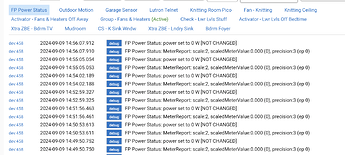

Setting P171 to 1 minute with no load and debug results a 0-watt report every minute:
Summary
This Z15 is an 800 model (paired mesh S2) on v2.00 f/w
Thanks, so working as expected and same as my (your old) 1.06 model.
