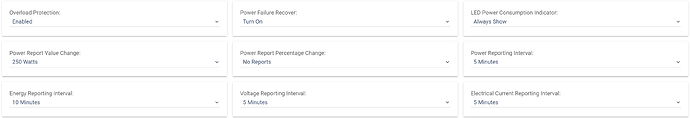

I've observed that if I set power reporting to occur at 250W change or interval of, say, 5 minutes, it does not report every 5 minutes if the value is zero. This may be true for voltage and energy as well. I'm using the built in Zooz Power Switch driver.

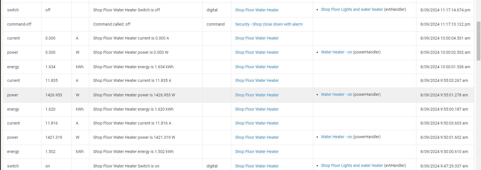

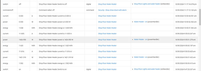

I also have one attached to a small water heater in my shop. It only gets turned on when I open the shop and it doesn't report anything when it is off. Below is a sequence when the water heater is turned on. It reports power at 9:50 and 9:55 and then at 10:00 when it is 0.0. The water was at temp. It never reported again and was shut off at 11:17. So as you have seen while it was 0 it reported nothing. I am also using the built in Power switch driver.

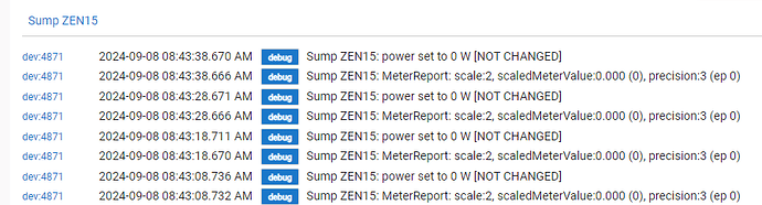

My driver will however log to debug, so I will do a little test here.

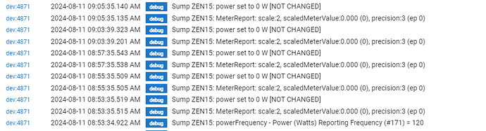

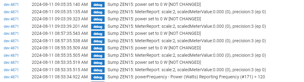

Here is current event log showing the same thing you are seeing, every 60 mins then stops once the power hits 0.
Power reports of 0 coming in every 2 minutes as I have it set.
Mystery solved, driver/hub event filtering.
So if you have the interval set to 5 and the power stays as 0 you can be assured it is still at 0 or else it would change in the UI. The hub is just filtering out duplicated events.

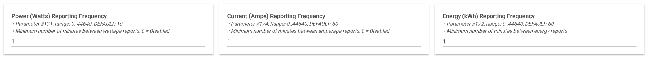

What FW version if yours and what do you have the 3 power settings set to?
I have a 1.06 model and will do a little testing here. It is possible the device does not send repeated reports when power is 0.

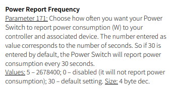

Well that was easy, I turned on debug and manually set param 171 to 10 seconds (below what my driver normally alllows) and I am getting a 0 report every 10 seconds. Since the report is coming in, I have no doubt in this case if I did the mod on my installed driver it would be posting to event history.

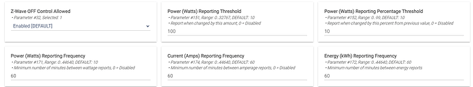

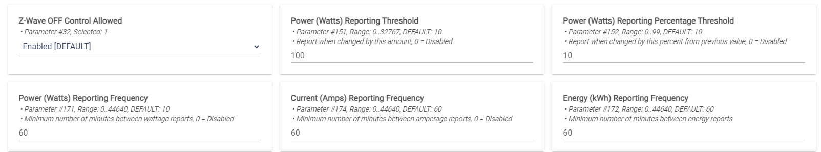

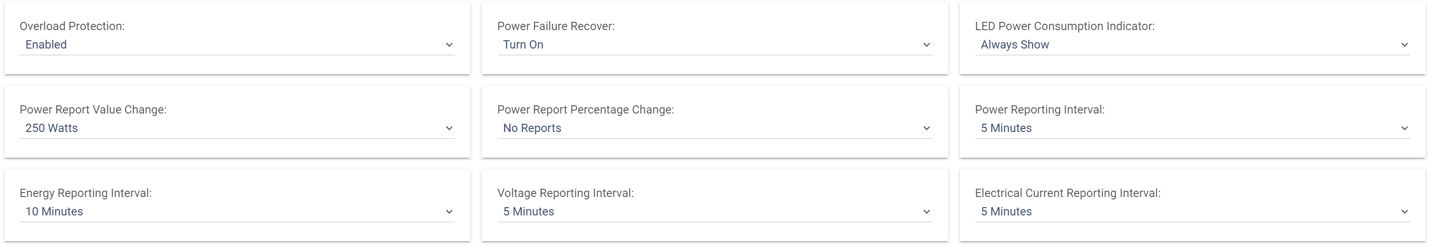

My FW = 2.00. My device setting are:
My Logging:

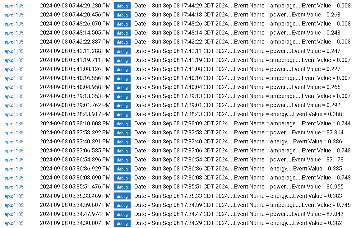

Please note that I unconditionally output to the log energy, power, and amperage and that is how the log started out but then the log only shows power and amperage. When I was looking at the device view at the time that energy was not logging I noticed that under Current States that energy was being reported as 0.388 but if I did a "Refresh Stats" and then a "Refresh" it showed up as zero. This seems correct because at this time the refrigerator was in the off cycle and the current indicated that (.008 instead of around 0.74). It was interesting that if I just did a Refresh the 0.388 did not change and I needed to do a Refresh Stats first.

Did you change the logging of my driver, that does not look like what my driver normally logs?

@hydro311 Can you set one of your ZEN15 v2 to report power every minute with debug logging on and see if it keeps reporting 0 every minute. (Would require a device that shuts down to 0 power obviously). Or manually set parameter 171 to 10 seconds if you are impatient like me.

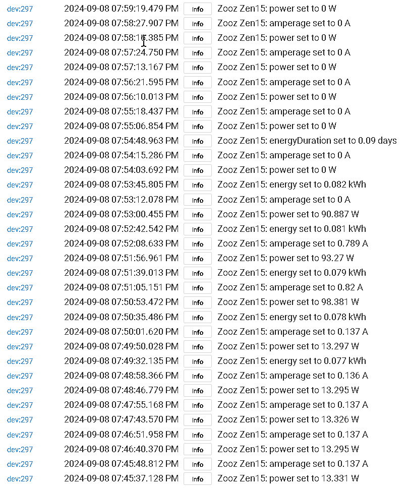

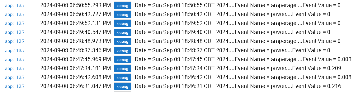

I unplugged my frig for a couple of minutes from the Zen15 and got the following:
The log shows the transition from plugged in to not plugged in. Note that energy is not present.

Your logs are from an app?
What about the logs from the actual device, with debug enabled?
At 07:53:12 you will see amperage is 0 A... this is when I unplugged the frig. Note that energy is not reported.
I see at 07:54:48 that energyDuration is reported and is different than what I remember it was about 20 minutes ago. What is that and how did it get set. Can I override this if need be?

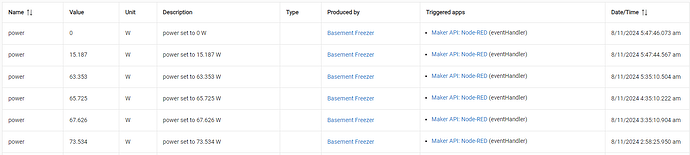

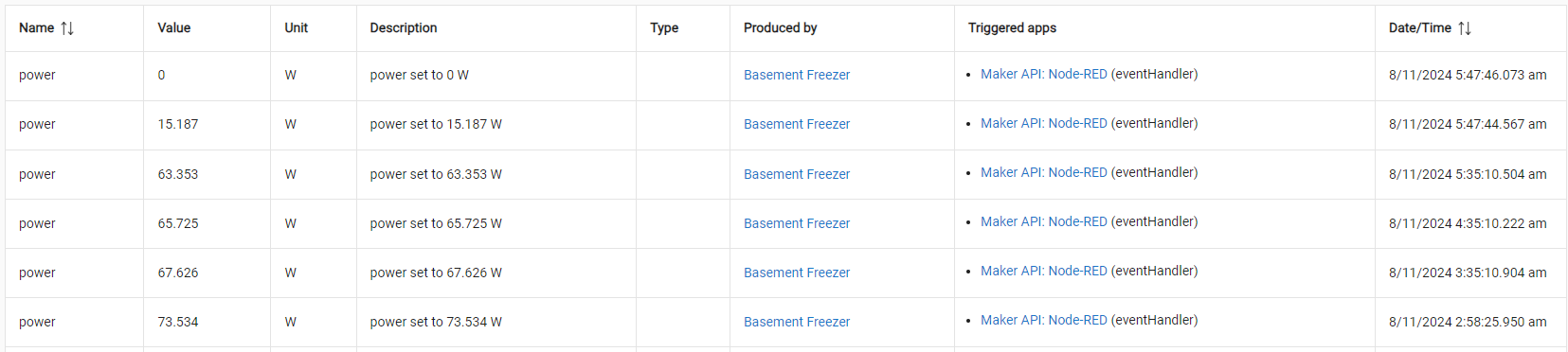

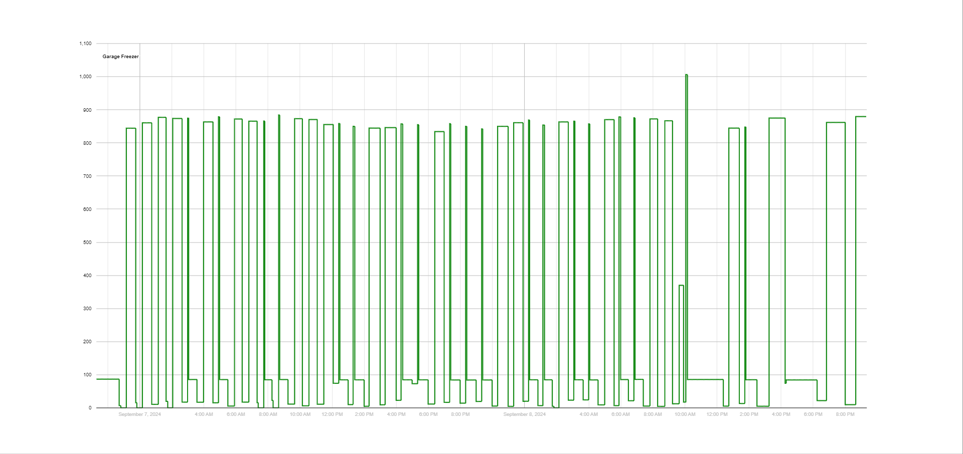

energyDuration will just keep going up, it's how long it's been monitoring the energy usage since last reset.. Energy consumption will only go up the longer the device stays on. What you want to look at is power not energy. Below is a graph of power usage for the freezer in my garage. This is with a ZEN15.
Makes sense. So it represents the integration time of power to give you energy. What you graphed is Power... that is just I want to do. Can you tell me what you used to graph that out. I am guessing that you are using the Advanced driver and you set the "Power (Watts) Reporting Frequency" in the driver to something like 1 minute? You wrote a custom app to do this right?
