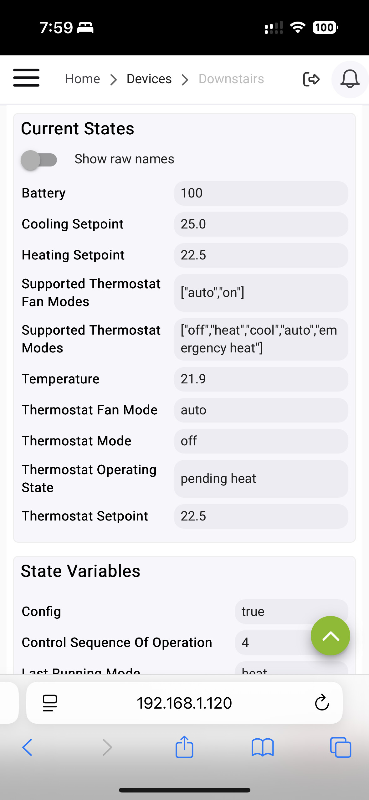

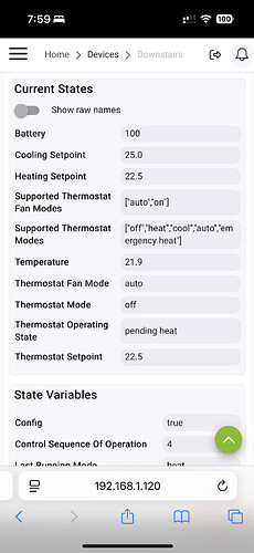

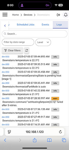

My 2 Zen thermostats have not been working right since 2.4.x, and I’ve finally found the issue, the drivers are not seeing the “mode” changes even with command retry enabled.

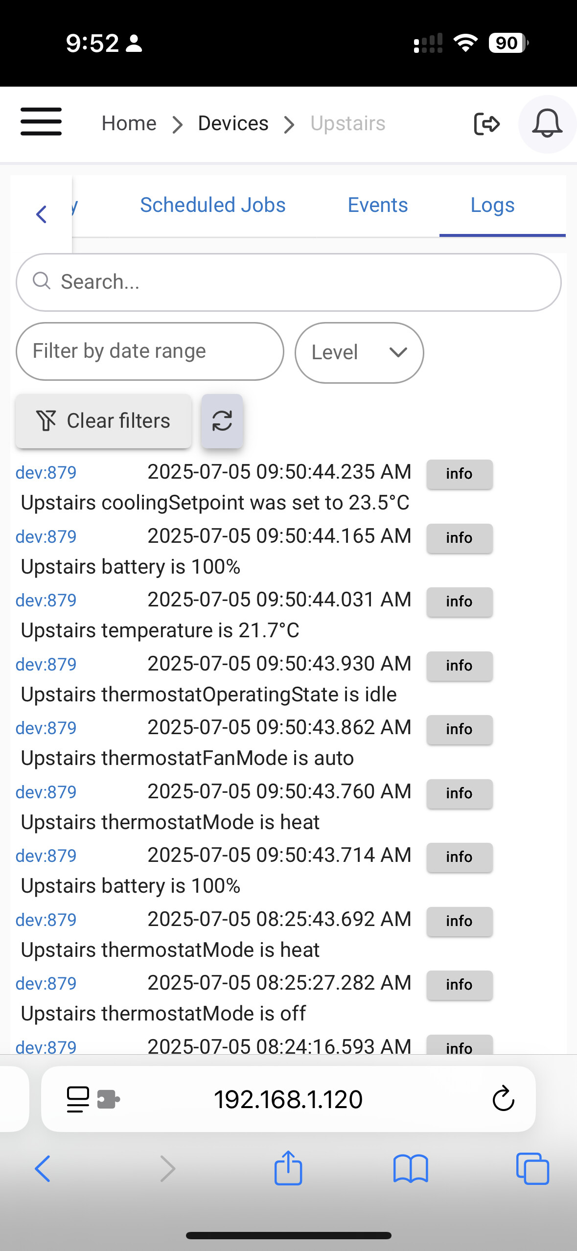

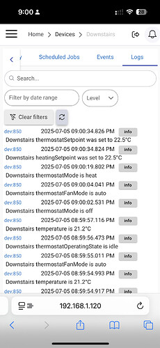

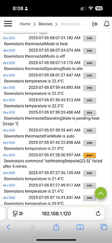

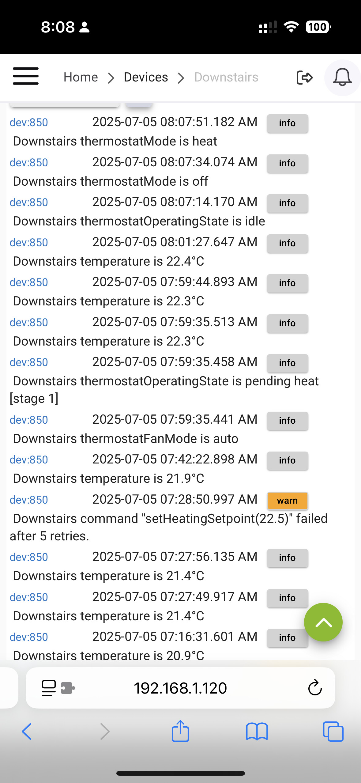

After checking the logs, I’ve confirmed this. You can see that operating state is working “pending heat”, but the driver thinks the thermostat mode is off.

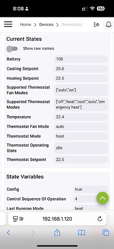

If I manually set the thermostat to off from the device itself, and then to heat, Hubitat recognises the state again. This is the only way to get it to resync tho, taking the batteries out and reinstalling them doesn’t work like it would normally.

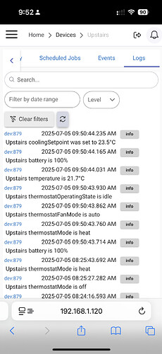

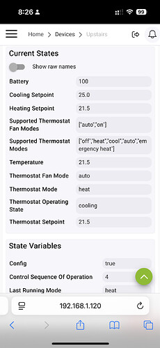

My upstairs thermostat driver is even more confused, I manually put it on heat, but Hubitat thinks it’s in cooling state, despite the logs showing it was put in heat mode.
I was able to fix the operating state on my upstairs thermostat by pressing the “heat” command button in the driver.
Weirdly it doesn’t show in the logs that I sent that command.

As far as I can tell yes that is accurate - it seems like it'll turn off the thermostats, but when it turns them back on, the mode doesnt get reported back to hubitat.
eg this morning, the downstairs thermostat was in heat mode, but hubitat thought it was off, even tho it was RM commanded it to heat and the 22.5c setpoint.

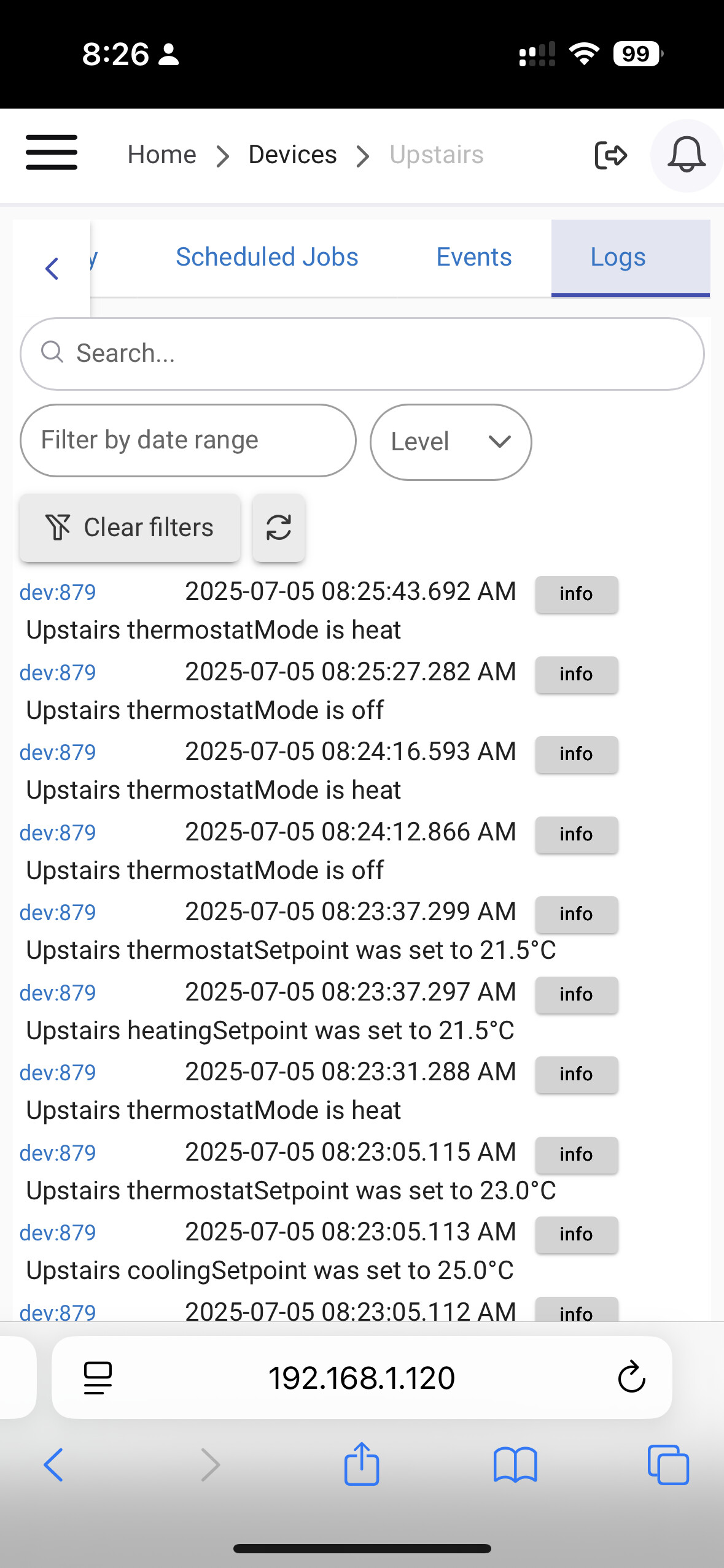

The upstairs thermostat behaviour had extra oddness, I was cycling through the modes via hubitat, and then from the unit, to try and get it to sync up, and it thought cooling state was active at one point while in heat mode. I suspect that is just a side effect of the states not updating correctly.

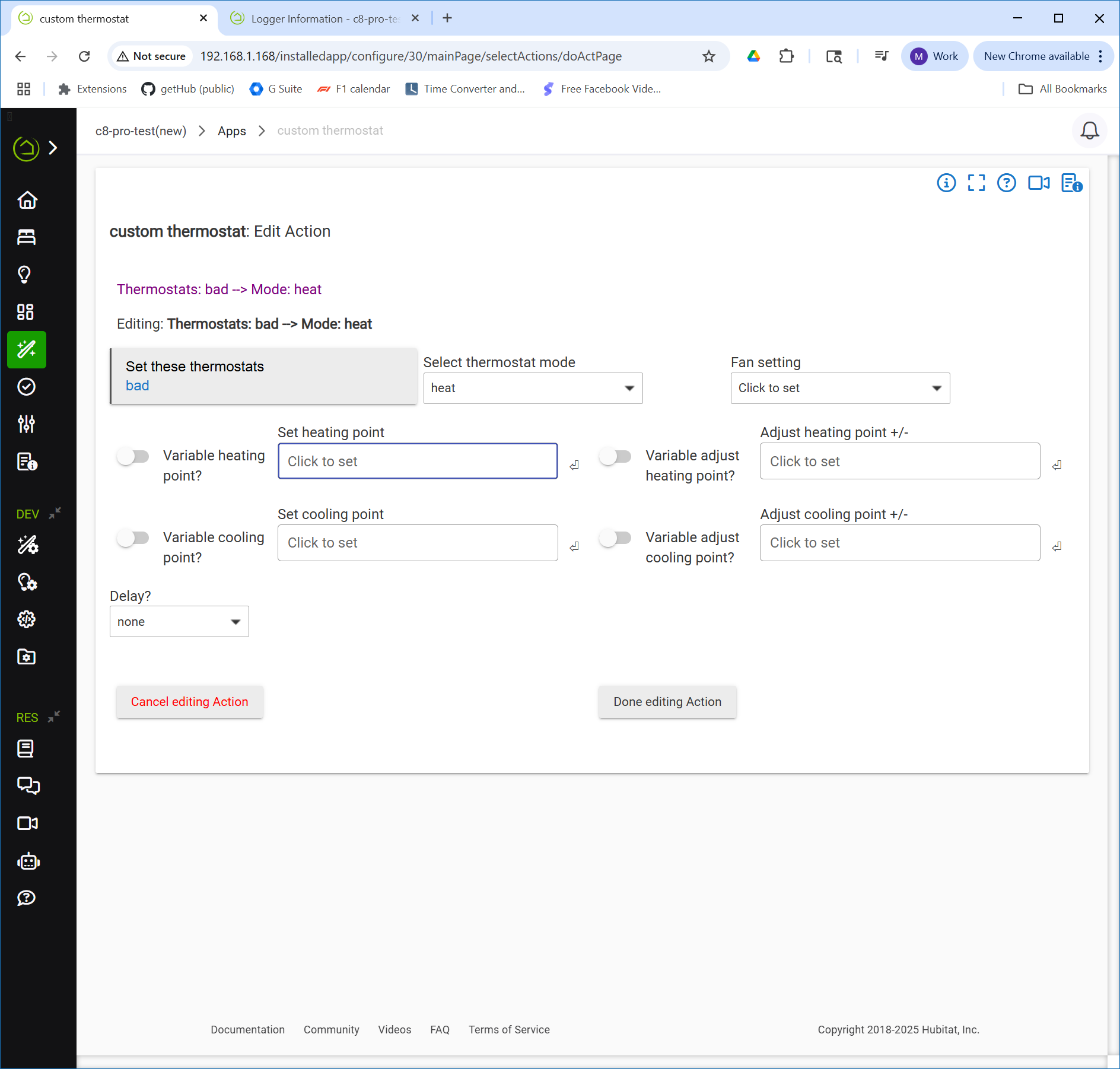

if CR is enabled and you set the Zen (eg via RM, device etc) to heat (from off), the status stay's as "off" even when the Zen is on Heat.
Are you using the actual off/heat commands?
Yes, discrete commands via RM

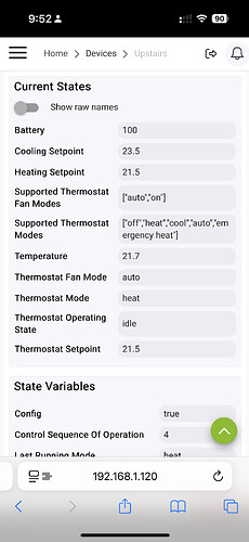

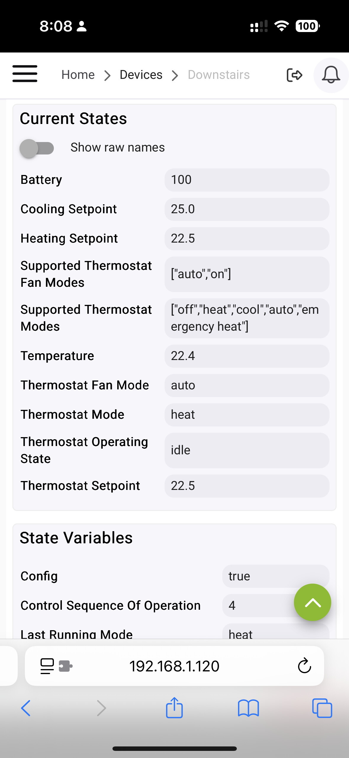

something like this?:
