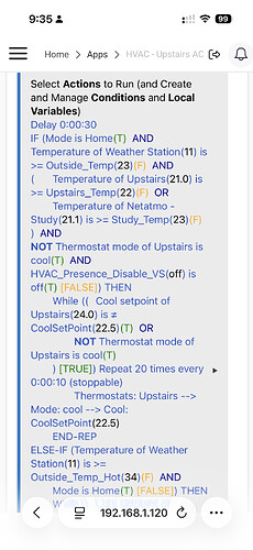

Good point, all of my HVAC rules send mode and set point at the same time.

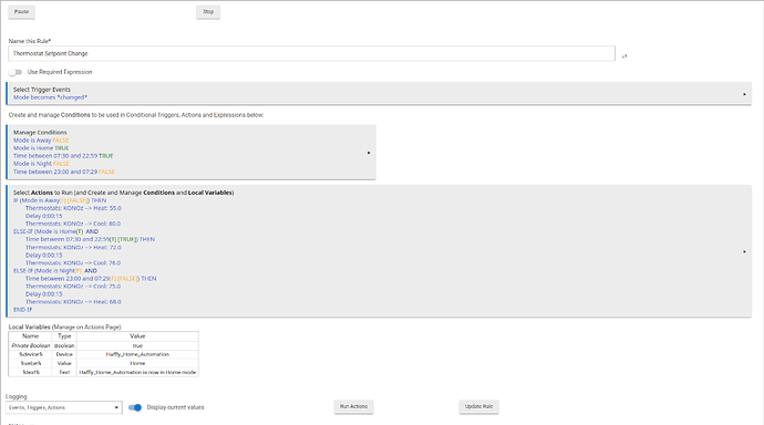

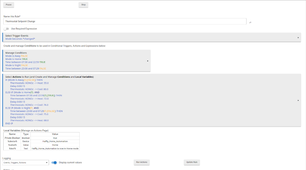

I had added a delay between commands in my rules. I not longer use the Zen thermostat, using a KONOz instead with the rules providing control not only for heat or cool, but for mode since the KONOz does not have an automatic changeover mode. The screenshot details the delay between commands.

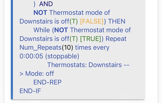

I do something similar, I use the RM “repeat while” function with a 10 second delay. It basically gives your own command retry in rules.
Command retry itself is great for changing set points manually, especially when you have unreliable devices like the Zen thermostats.

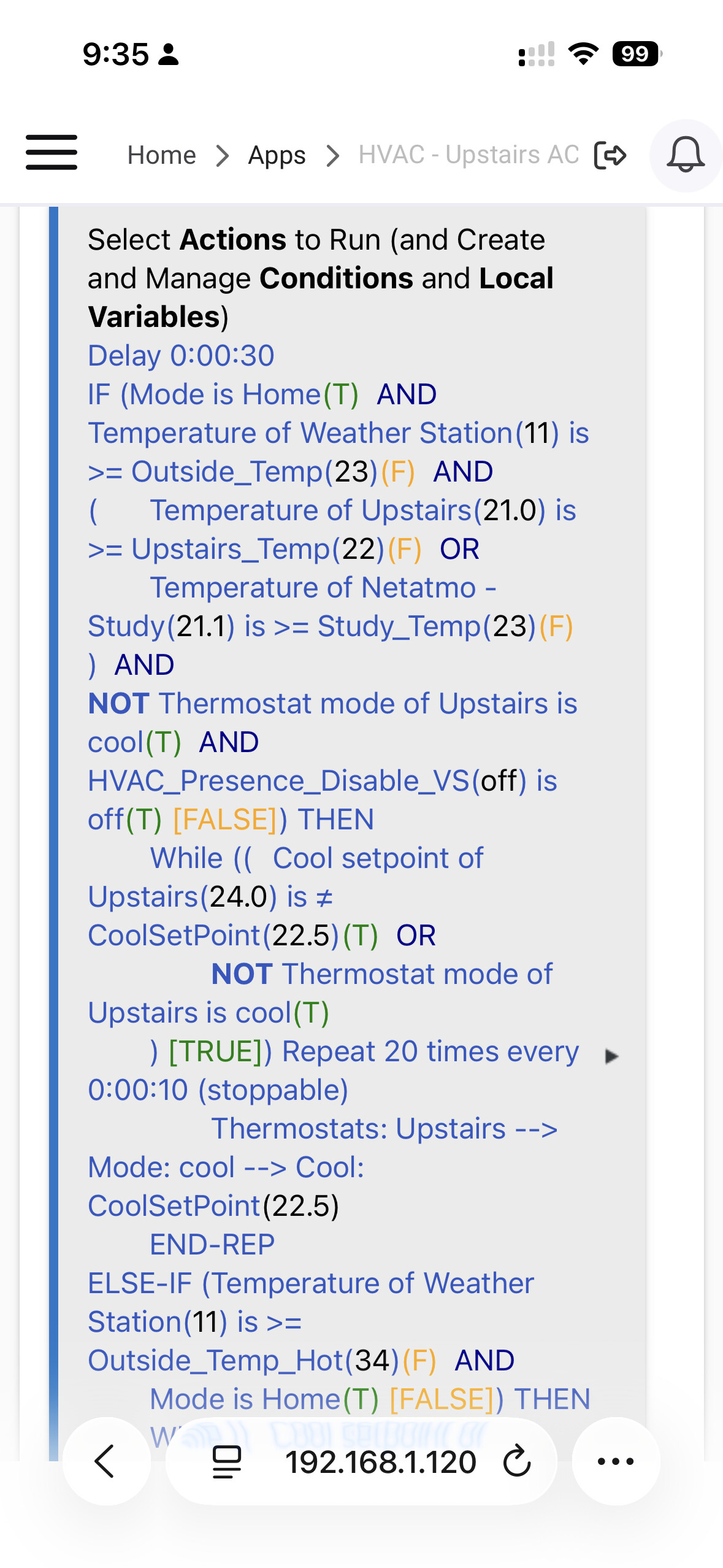

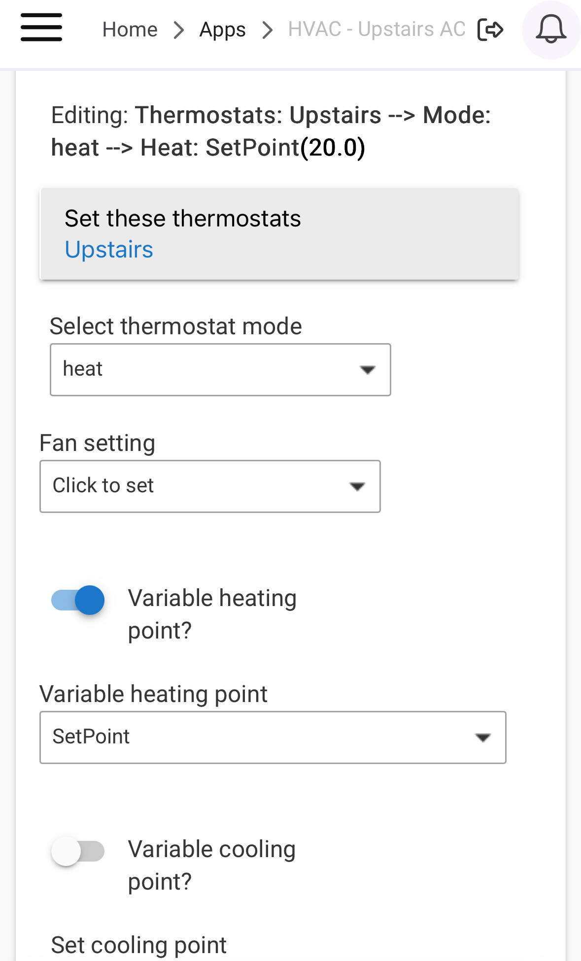

EDIT: I should have done this ages ago, but I finally got around to breaking up my rule:

And that’s despite me changing all my rules to break up mode commands from setpoint.
