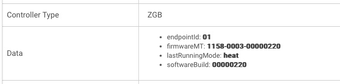

Notice how the thermostat setpoint now matches the heating setpoint and it didnt previously. The cooling setpoint also updated and I didnt touch that.
My Downstairs stat only controls heating, vs upstairs which does heating and cooling (reverse cycle AC) so I dont think it is a fair comparision.
We run our upstairs system in Auto mode overnight, when it's been a warm day and it'll be a cool night, with a min/max temp and im wondering if this has anything to do with it. As in, the driver isn't handling the changeover properly.
