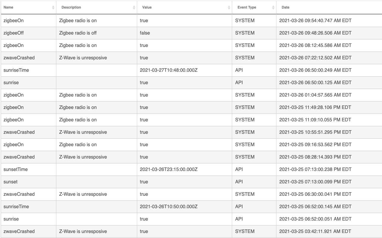

C7 device running 2.2.5.131 and 2.2.6.130 (no change between versions) is exhibiting z-wave crashing behavior several times per day. The symptom will be unresponsive switches, but it is shown in the System Messages as: "z-wave is unresponsive. shut the hub down, unplug it for 30 seconds, and plug it in." This power cycling brings everything back online and the system will usually be fine for several hours.
Generally, if I go to bed and the system is working, by the morning this error will have happened and I need to reset the hub. This morning I was working on the system until approximately 2:30am, and the system was offline by 8am, with no user interactions that I'm aware of precipitating the issue.

That would be... Disappointing... If their response was just a shrug. I searched the forums and only found two other threads that mention the zwaveCrashed event, and one of them was helpful in letting me know I can do a trigger off that. So now I'm adding a rule to power down the hub when it's detected and then node-red will bring the hub back online.

For anyone wanting the auto-recovery, I have a Rule Machine entry that triggers when it sees the zwaveCrashed event and shuts down the hub, and then a Node Red flow that is pinging the Hubitat and if it gets 5 consecutive timeouts will turn off the hub via Kasa wifi switch, and turn it on a minute later.
