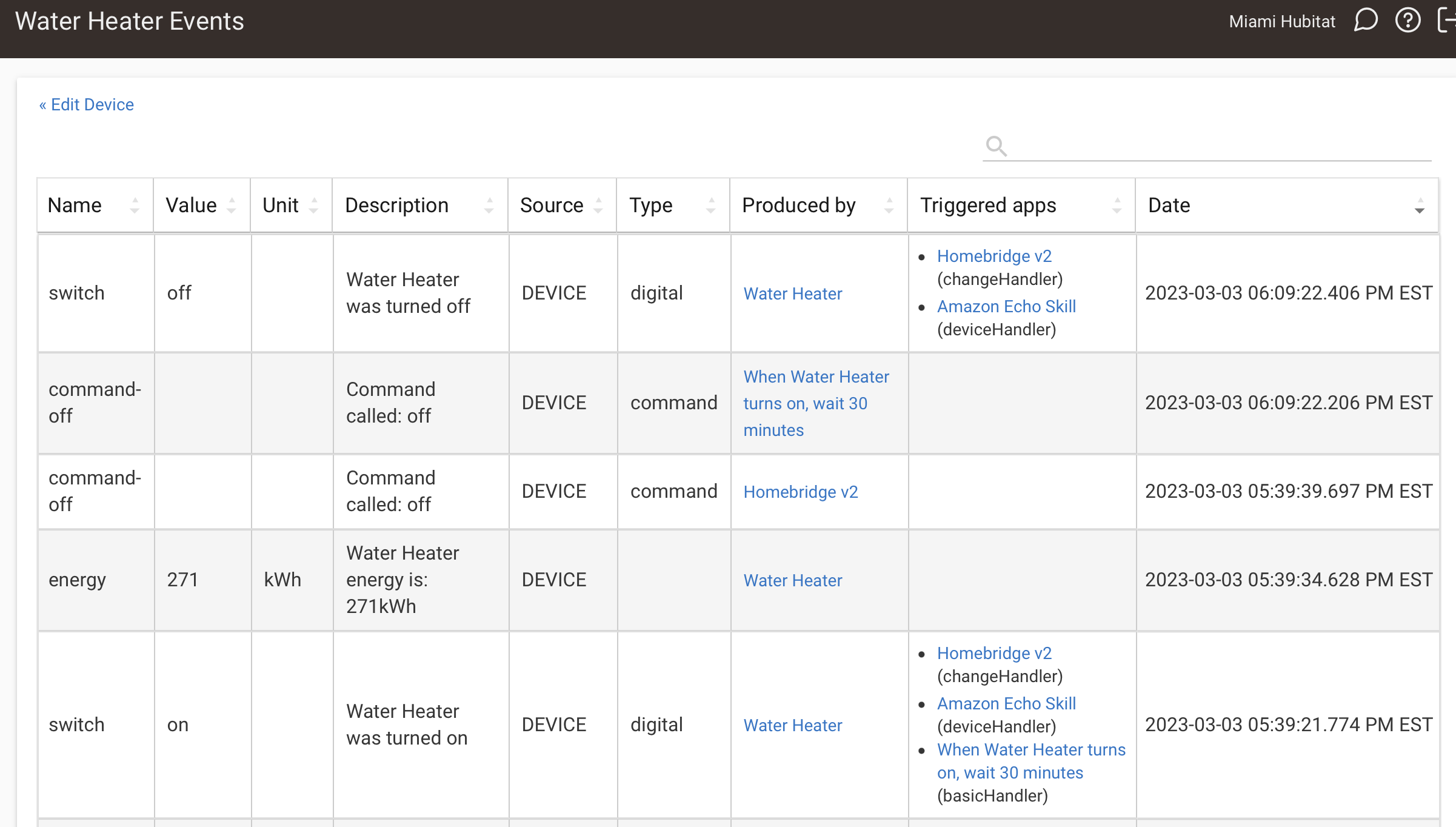

So in the screenshot attached, the "On" command was sent at 5:17 pm. Device status did not change to On.
Device status changed to "On" when I sent the Off command at 5:39 pm but device did turn Off.
Device status changed to "Off" when the rule to turn it off reached it's 30 min wait trigger even though it was already Off.
