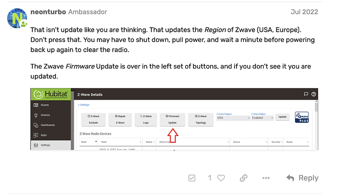

Is it a brandy-new C8?
edit: Does it have this?

But did it have that update box I referenced earlier?
Long story short, your zwave radio restore did not work. I would try the cloud migration again. If still blank you could try the full process again including another backup from the C7
I never saw an update firmware on the Z-Wave Details page.
