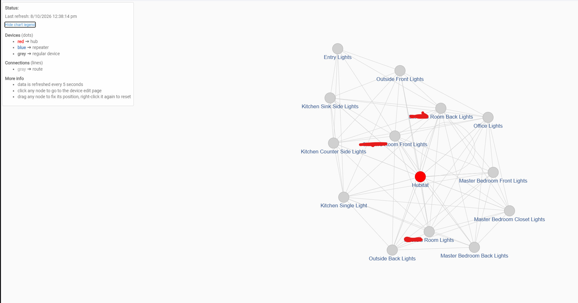

Z-wave network map all gray?
Why am I getting this...
Some more context would probably be helpful to others who don’t know everything you do about your local environment.
For starters, have you read the chart legend on that page?
What other colors were you expecting?
Is something wrong with one or more of your z-wave devices and the automations they’re a part of?
I think that's correct until you hover over a device?
Devices (dots)
  • red ➔ hub
  • blue ➔ repeater
  • grey ➔ regular device
Connections (lines)
  • gray ➔ route

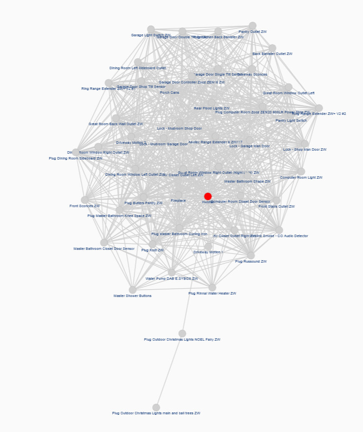

I don't have that many z-wave devices but the chart you show is normal.
Where have all of the colors gone? Surely I have some repeaters (blue).
That map has not been fixed since the update to Z-WaveJS. If you revert back to using Z/IP (Legacy), you'll get your blues!
So what is the best way to list all of my repeaters?

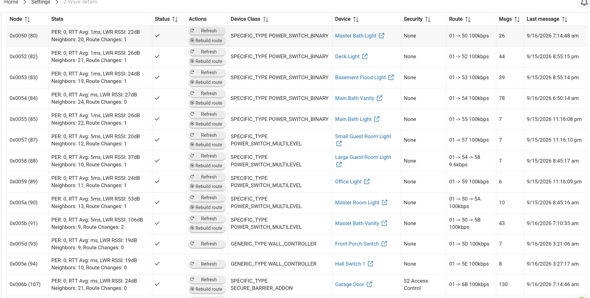

If you know what kind of z-wave devices you are using, you can easily tell without even looking. Anything mains powered is a repeater.

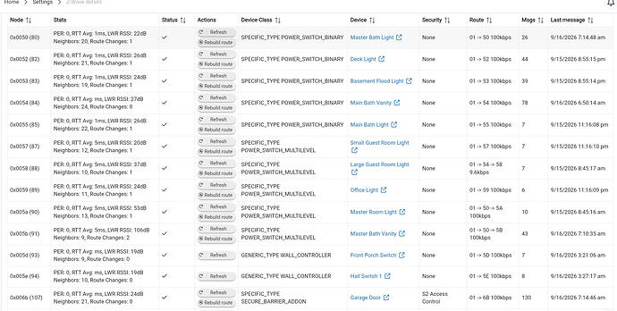

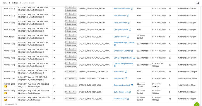

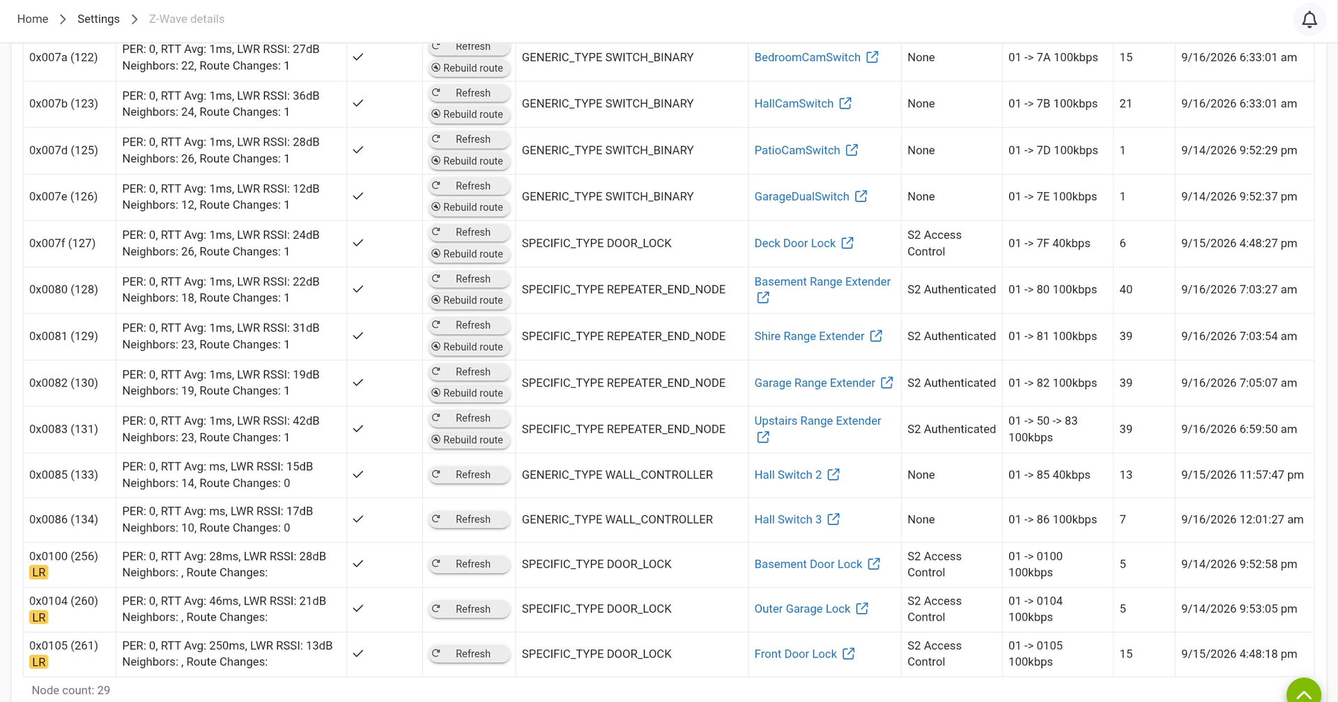

If you really need to know which devices are routing for your z-wave network, I believe you can review route information for each node in the table of devices that’s part of the z-wave settings page.

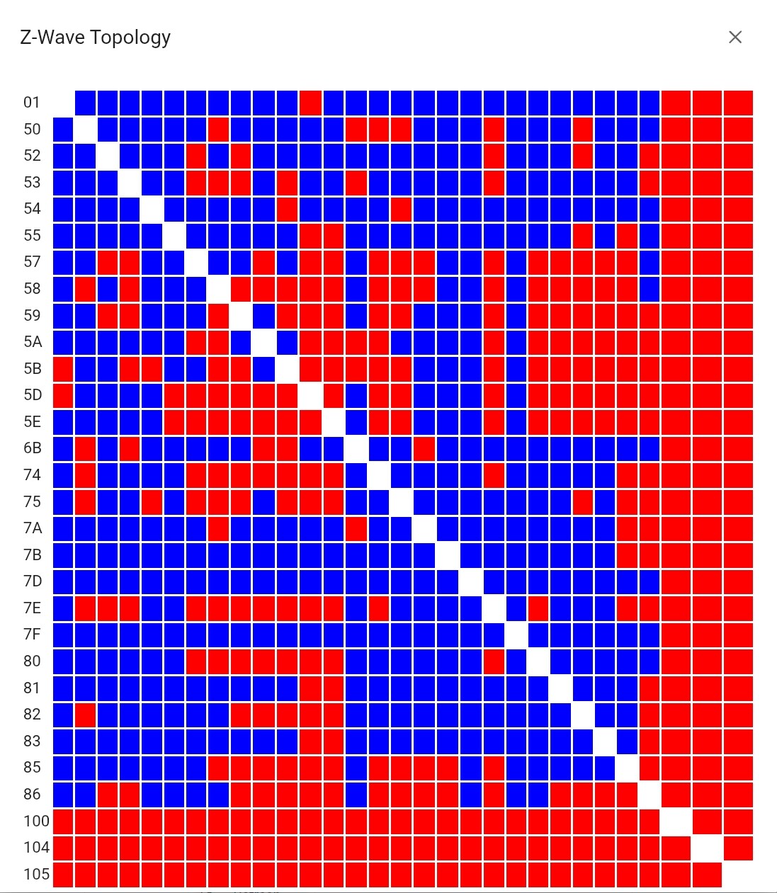

You can use the topology map as well ….

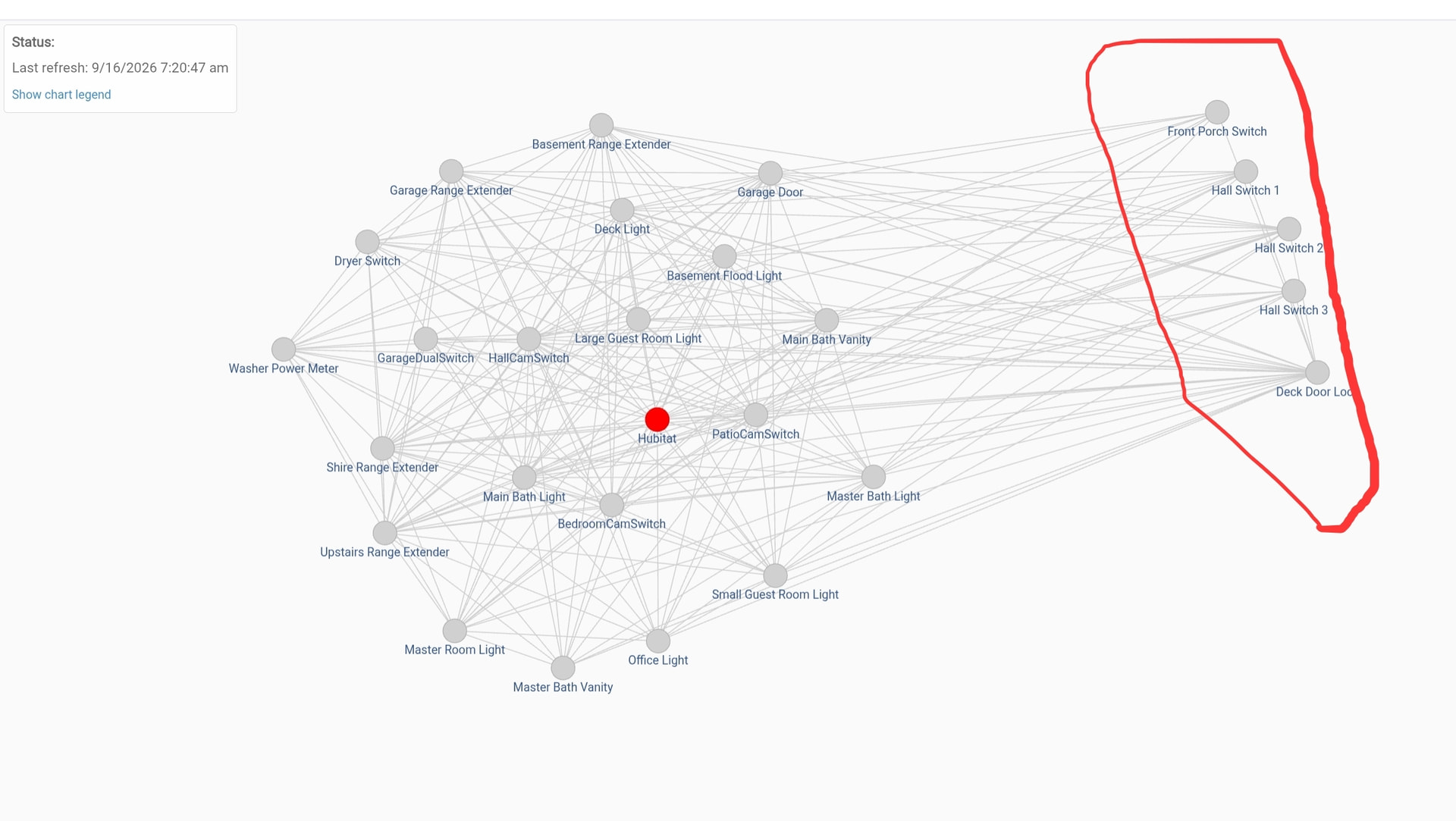

So, jumping in on a slightly older thread here. I just got my C8-Pro and started it up a week ago. My graph map is also all gray still, and I am not using Z-Wave JS yet. The 5 circled items are the only non-repeating nodes I should have. The rest should be blue (All are mains powered switches or Range extenders.)
Graph/Map
Topology Map
Details Table
Also having weirdness with the hub showing online on the registered hub page (Detailed here: Migrated to C8-Pro - Cloud Network strangeness ) that isn't getting any responses.
Not sure if either are issues I should be concerned with or not since everything appears to be working.
