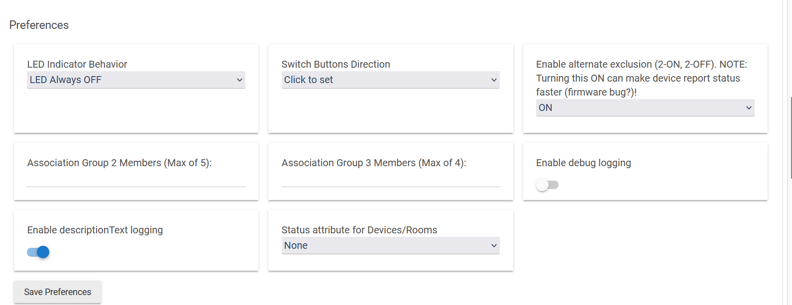

Here is a snip from a custom driver for my GE/Jasco switches:
The driver has tp be specially coded to be compatible with that app, so pretty much only Inovelli AFAIK.
