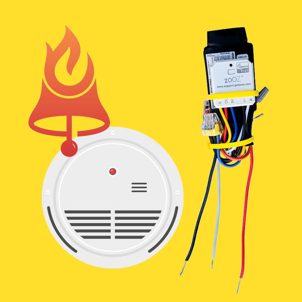

I am leaning toward to do a standard daisy setup detectors and hooking up a z-wave module on one of those detectors in the chain. With one module to learn and set up in rule setup would make it a lot easier to maintain.
I agree. And Zooz sell a premade module that would be suited for this.
