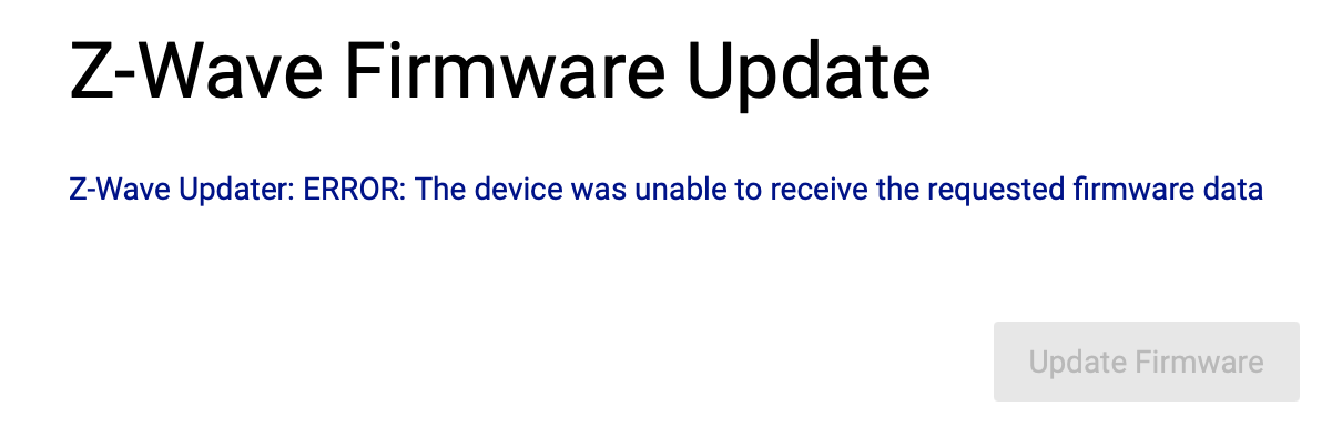

I am running 2.3.4.114 and started updating the Z-Wave firmware. It got somewhere past 44% and when I looked at it again I got this error message:
That is the whole dialog box. There is no "X" or "Close" button. (The Update Firmware button is grayed out and can't be clicked). So there is no way to close it!!
BTW, I tried closing the browser (Safari) and restarting it, but this time I instantly got the above error message.
What do I do now?

This time it crashed after only getting to 15% with the same error message:
So:
  1. Why isn't there any way to close the error message; and
  2. Much more importantly, why isn't it upgrading and what should I do now?

I air gapped the switch that Hubitat informed me had been giving excessive reports and then tried the firmware update again. It instantly gave me an error message that it failed to start. About 10-20 seconds later it gave me the same error message I posted at the start of this thread.
So I don't know why it is failing instantly or how to fix that.
I also still fail to understand why Hubitat would have created an error message that can't be closed. I have to literally close the browser to get it t go away. But at this point, I hope that is just an annoyance and a collateral issue. I say "hope" because that first couple of times I tried to do the firmware update it started but then crashed. (First time got past 44%, but very slowly, 2nd time it got to 15%, again, but very slowly). Since then I won't even start to run now.
