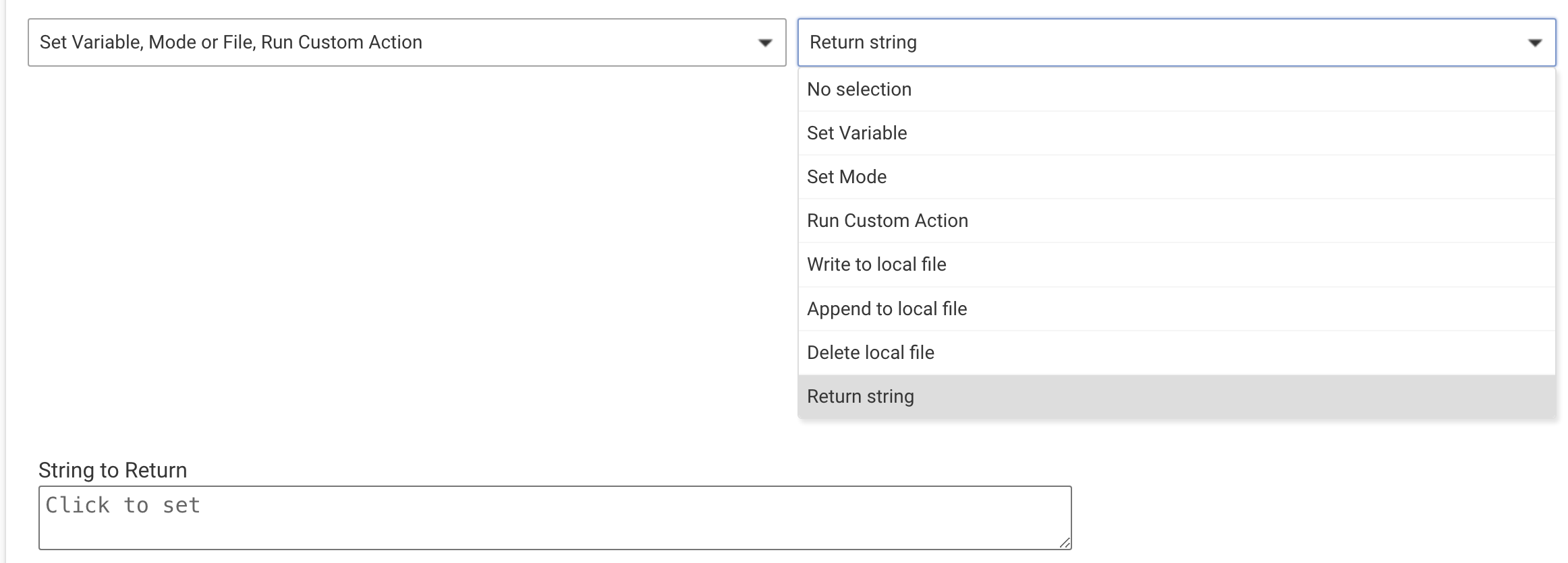

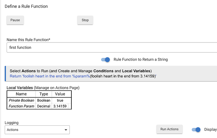

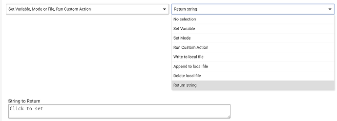

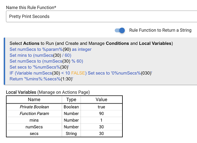

This idea has been rattling around in my head for some time now, but your post kicked it up a notch. I pulled a late night last night and came up with what for now I'm calling Rule Functions. A Rule Function is a special rule that is invoked by another rule, passed a parameter, and returns a string. It doesn't have Triggers or Required Expressions. Its parameter is the name of a Hub Variable; this makes it possible to pass in any Hub Variable type. The Rule Function runs its actions, and uses a new action called 'Return string'. This action passes a result back to the calling rule, and exits the Rule Function.

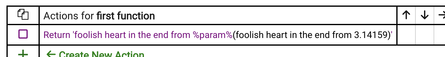

Within the Rule Function, the parameter is accessed using %param%, which pulls in the value of the passed Hub Variable. An example, where the parameter is a Decimal Hub Variable:
With this addition, it would be possible (even if hard) to create a Rule Function that does "Pretty Print" and passes that string back. Such a function could be used by any number of rules, so it only has to be written once. My small example:

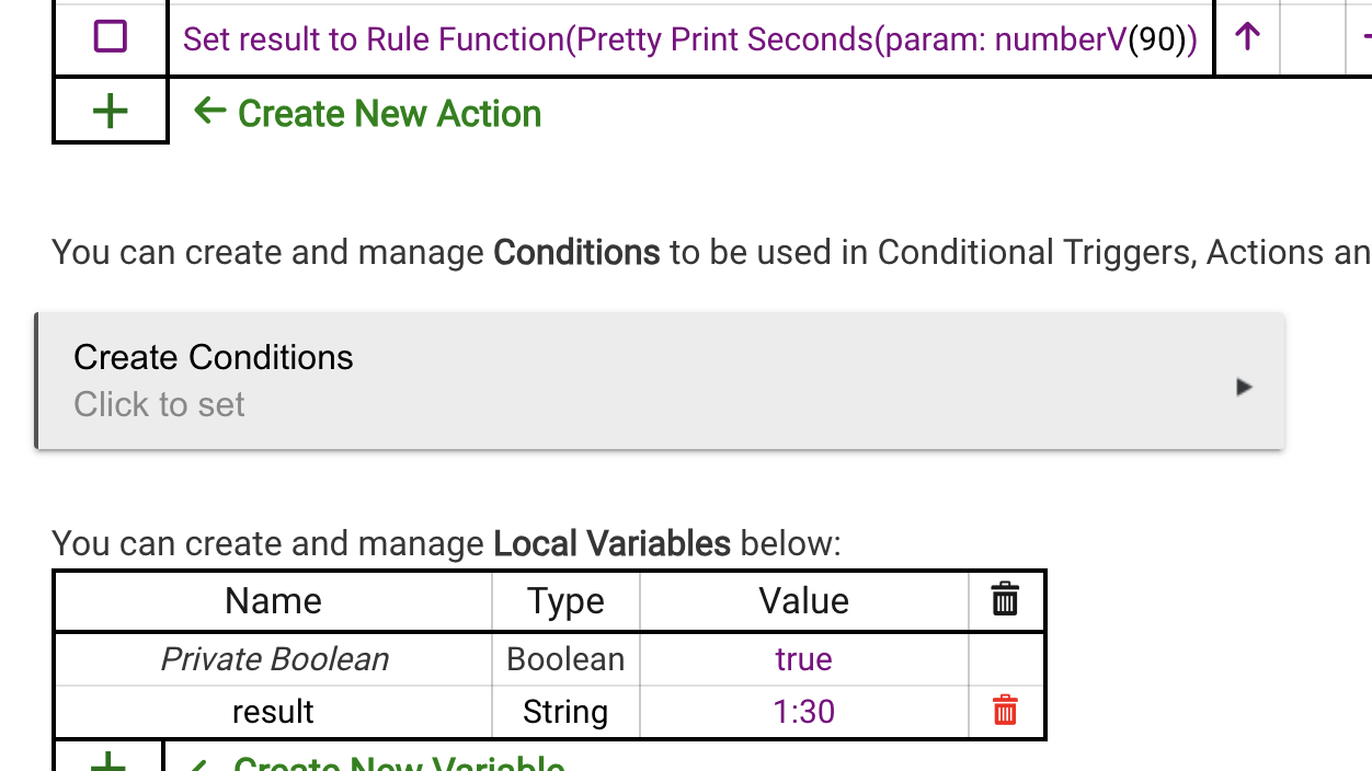

To call the Rule Function, there is a new option for Set Variable for a String variable, "Rule Function":

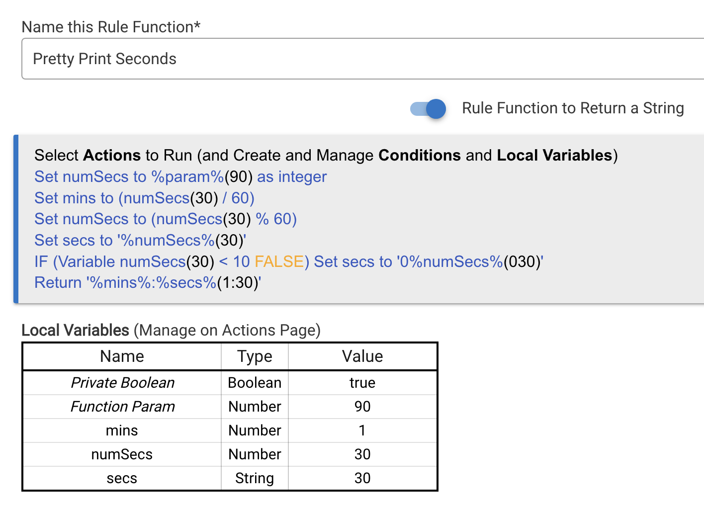

Here is an example of the original Pretty Print idea:
For 90 seconds passed in, it returns "1:30".

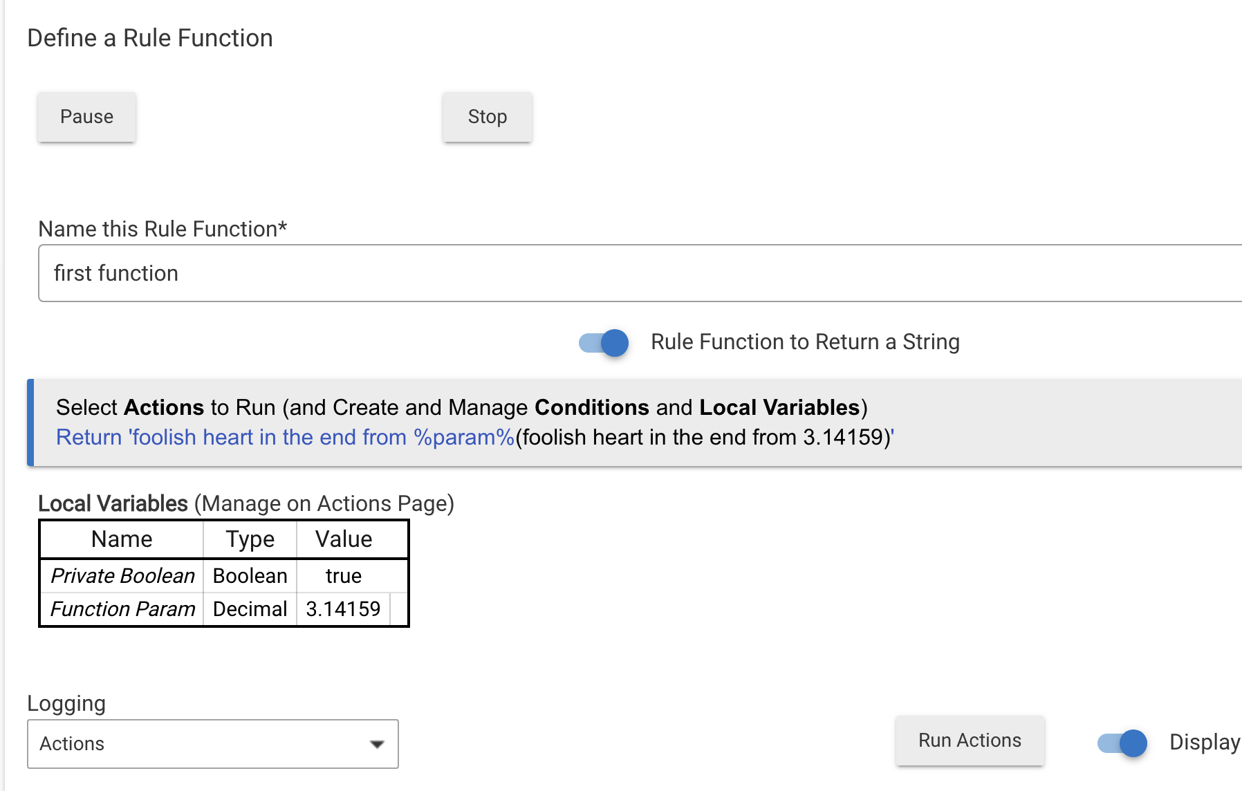

OK, please read above. These are RM rules with a selector that changes them to Rule Function (shown in screenshots above).

So the "Rule Function to Return a String" toggle turns a rule into a rule function, and changes the labels and such on the fly? That wasn't obvious, to me anyhow. I assumed that toggle just turned on or off the ability of the function to return a value.

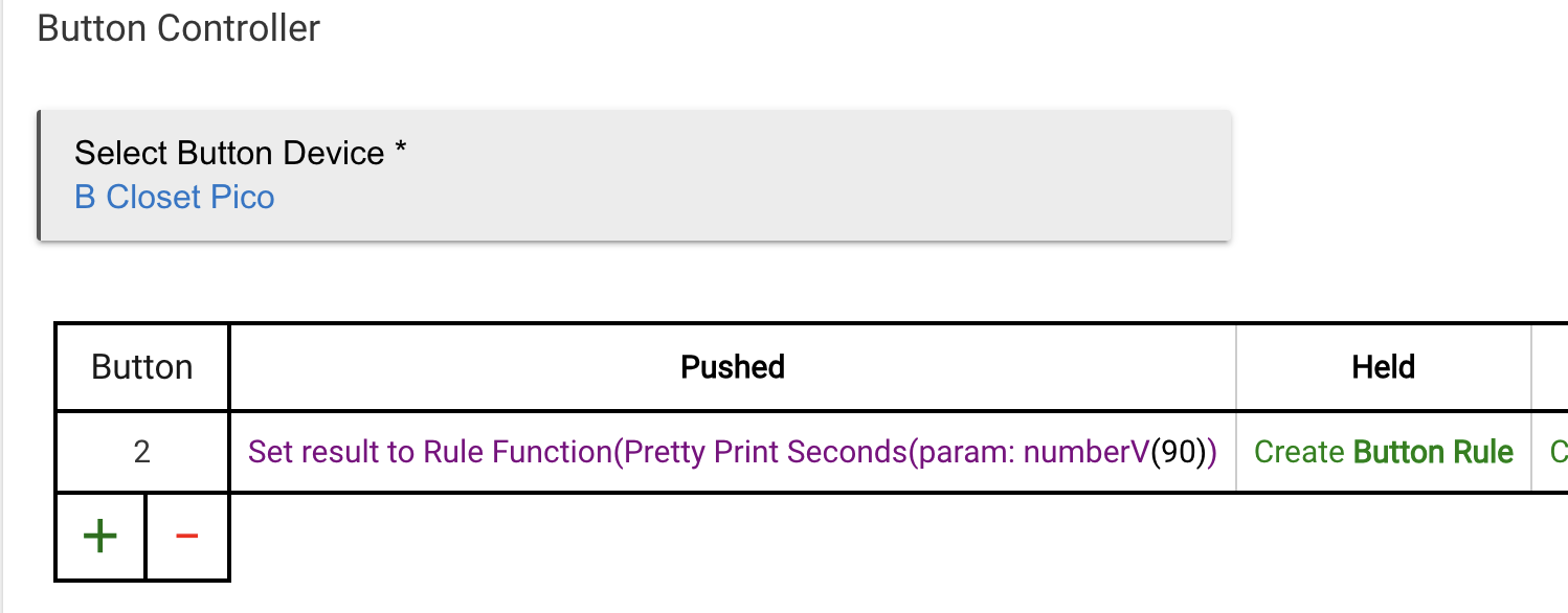

Here's a Button Controller example (not a useful one, but I did want to show it's possible):
