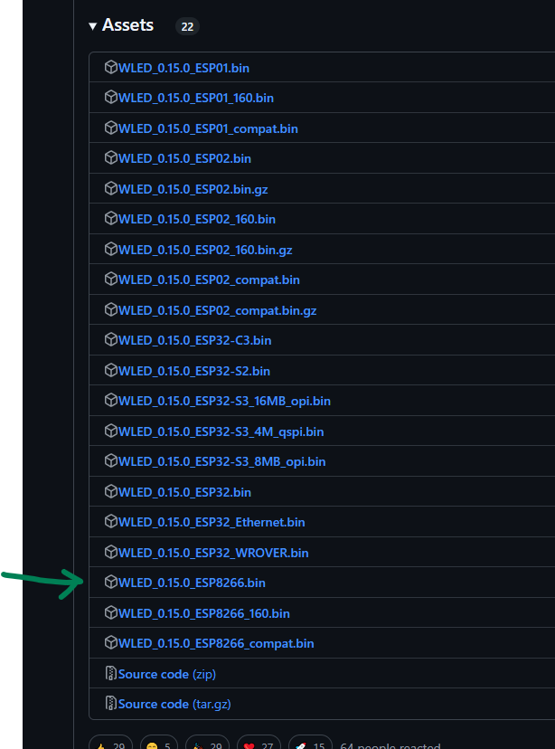

It can run on 8266. See list of installation files:
I have it running on one 8266 of the 7 instances and I always have to be careful when updating that one to grab the 8266 version.

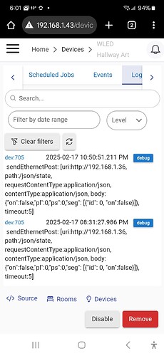

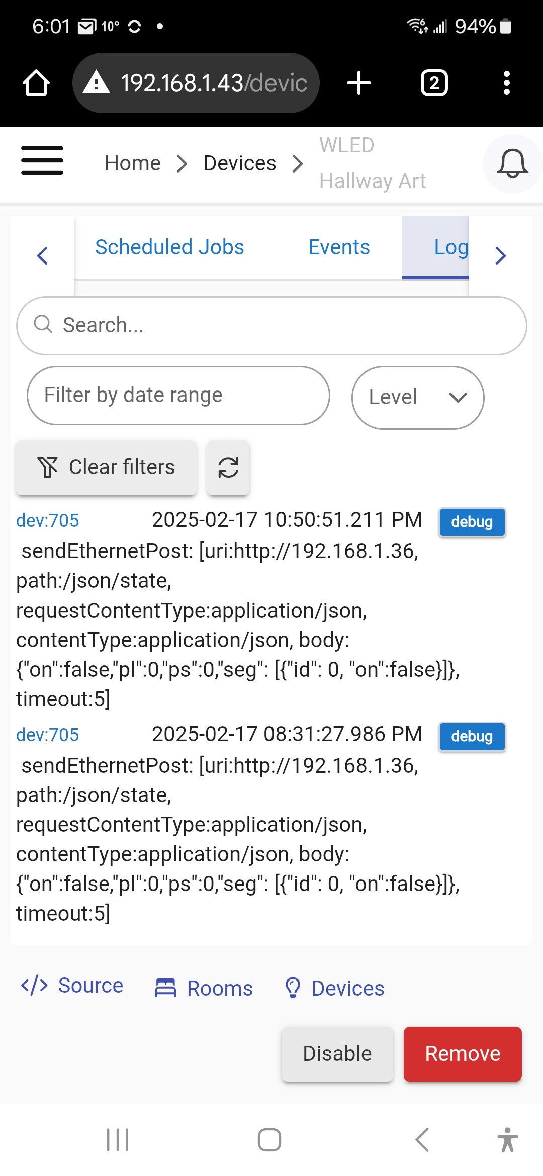

After all the work yesterday, the turn ons continued last night. The logs captured nothing at all.
The 8:31 instance is when i went to bed. The 10:50 instance was when i woke up and found the light on and turned it off through HE. About ready to ditch the WLED driver all together and just issue httpGet commands!!!

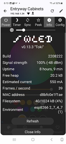

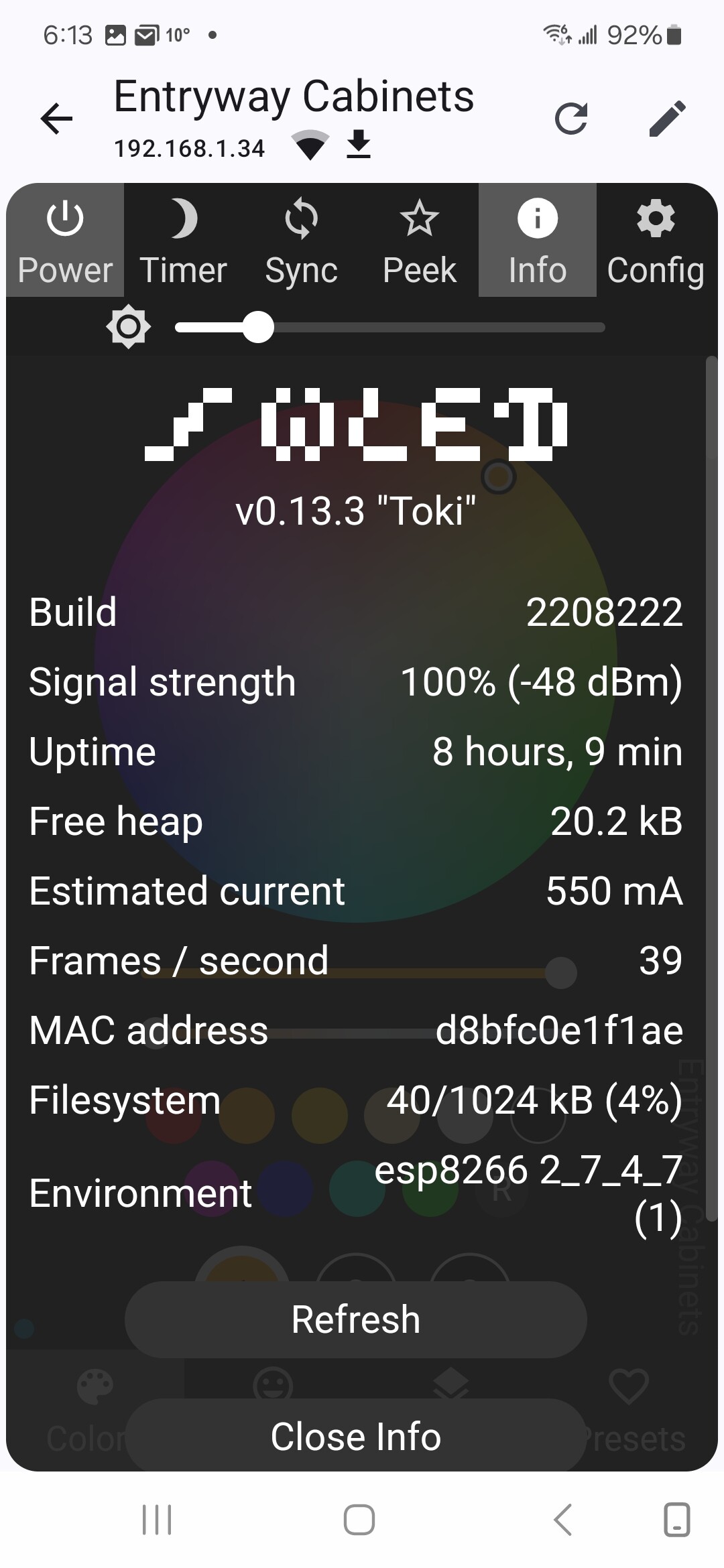

Heres what WLED is currently showing. All devices show approx same.
Thank you all again.
Is the 8 hour and 9 minute uptime correspond to the window on when the WLEDs probably turned on?
Yes....and now I'm thinking the problem is on the esp8266 side and not HE or driver.
Just did an experiment....turned on a set of lights, disabled them in HE. Sometime later, I noticed they'd gone out and checked WLED....Uptime was 33 minutes....prior it was 7 hours approx.
Your thoughts?
I already thought that. I had you enable that debug logging to prove that the driver was not sending anything to the devices (which I already thought was the case by looking at the code).

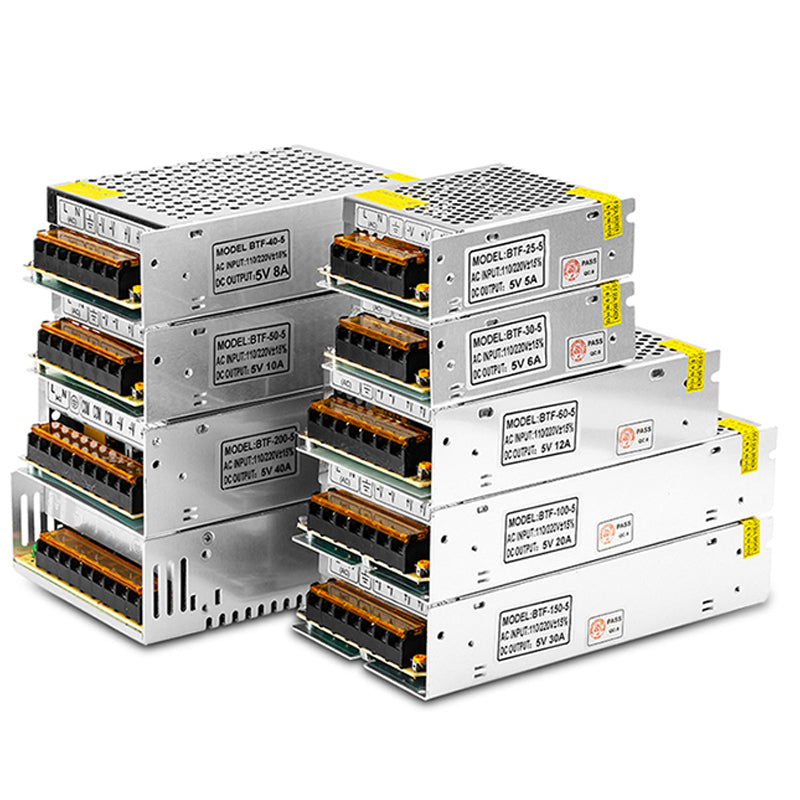

EDIT: @styxman What type of power supply are you using for how many LEDs?
In this case: BTF-200-5 power supply lighting only 98 WS2812B. Should be more than enough, however i have strands of 700 leds (different size power supply) that are acting the exact same way.

Darn, I was hoping that you were trying to use a simple plug to power the LEDs and ESP8266 and that was causing problem. Is that power supply powering both ESP8266 and the LEDs? I didn't find the specific power supply when Googling. What is the voltage and amps for it? Are all of your WLED setups using 8266s?
Sorry for all of the questions but this is a mind-bender.
Looks like 5VDC, 40A.
https://a.co/d/hDu5coM
All leds are using the 8266.
And the power supply is powering the LEDs and 8266? (grasping at straws....)
Sorry....yes, correct
