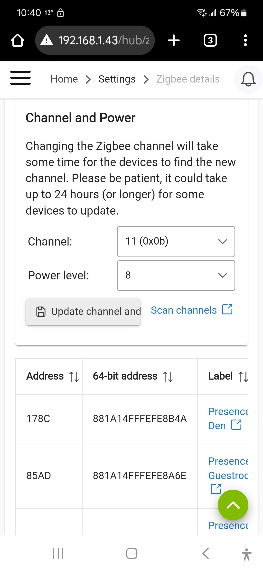

My router doesnt have a zigbee setting. My hub setting currently is:
Is this where you want me change the channel?
Also, my hub is directly connected to router. Where do i change the wifi channel you recommended?
Thanks for your help.
What 2.4 GHz WiFi channels is your router using? And is the channel width 20 MHz or 40 MHz?
If you look at @ogiewon's diagram, it reveals how 2.4 GHz WiFi can interfere with zigbee. So for example, if you use zigbee channel 11 (as indicated by your screenshot), you would be better off using WiFi channels 6 or 11.

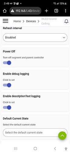

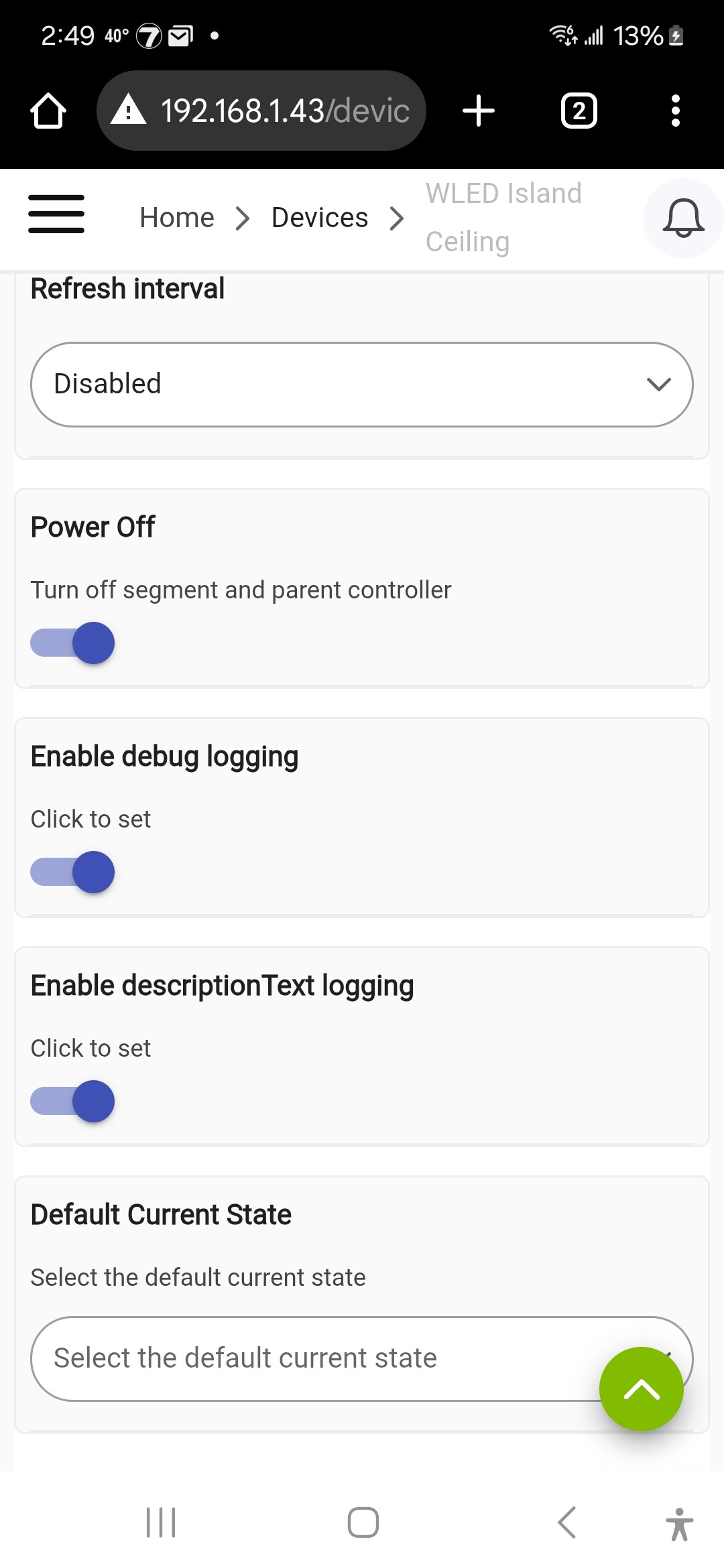

First go to the device page and confirm that the logging is still enabled, some drivers will shut it off automatically but I did not see that code in the driver you posted. You can check scheduled jobs after logging is turned on to see if it created a task to shut it back off later.
Then try turning the device on / off from the device page. Then check the logs again. If logging is on then surly something would have been logged for that simple test.
This is just to confirm that logging is working.

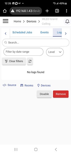

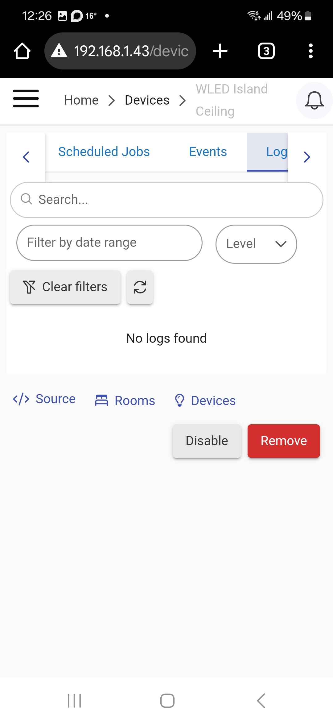

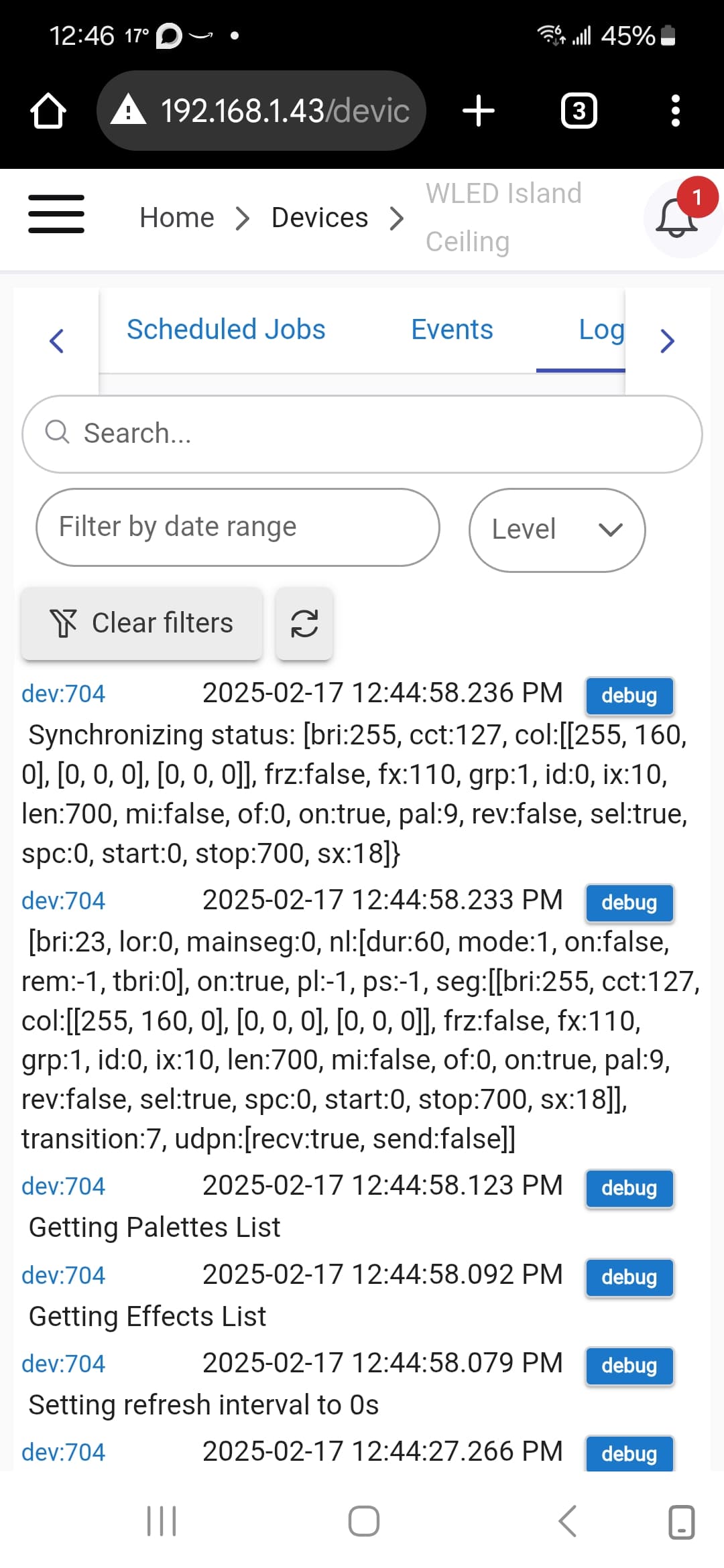

Loggjng was already enabled.

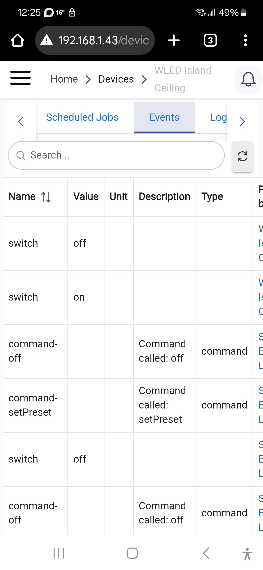

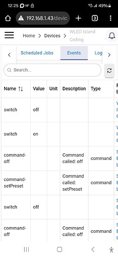

After switching the strip on and off a few times, the only thing populated was the Events tab which showed the command being executed.
Logs tab is empty. No scheduled tasks.
First try re-saving the settings to be sure it is enabled (and not just visually showing).
Then also check the full logs by going to logs on the left sidebar. You can even open it in a new tab and have live logs open while you do the test.

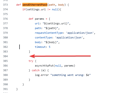

UPDATE: I looked at the code again, and it uses a fire-and-forget method. So when you run the ON command it just fires out the message to the device, and also at the same time updates the state assuming it will work. It never actually verifies the command worked from what I can see. There is NO debug logging in this chain either....
Looking further, this driver looks like a work in progress.
If you want to try and insert a debug line around here we could see what the heck it is doing I think.
Something like this should do the trick.
log.debug "sendEthernetPost: ${params}"
I don't think any private info will be revealed with those logs.

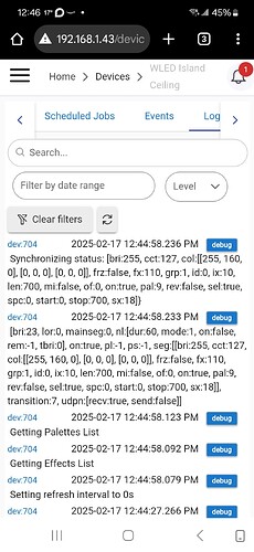

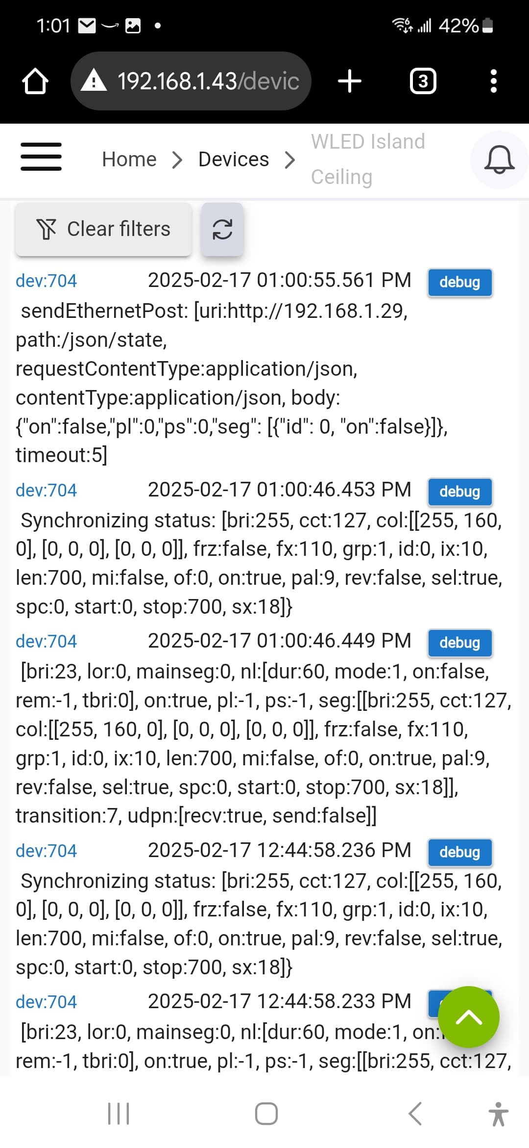

Ok....as soon as i resaved the Prefernces, logs started working. Hubs logs showing the same.
On/Off only showing up in Events. No scheduled jobs.
Yes, see my update above. Its not the logs "started working" again, its that this driver is not as great in the logging department as I originally thought. Only certain things get logged, like a refresh should for example. But not on/off.

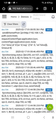

Edited the driver as suggested. Saved driver and returned to device. Pressed Off....logs generating new stuff (3 at 1pm):
Ok that should do the trick then.
Now we wait. If the driver sends ANYTHING to the device, it should be logged I think. The other code which was sending had debug logs in the data response handler already.
