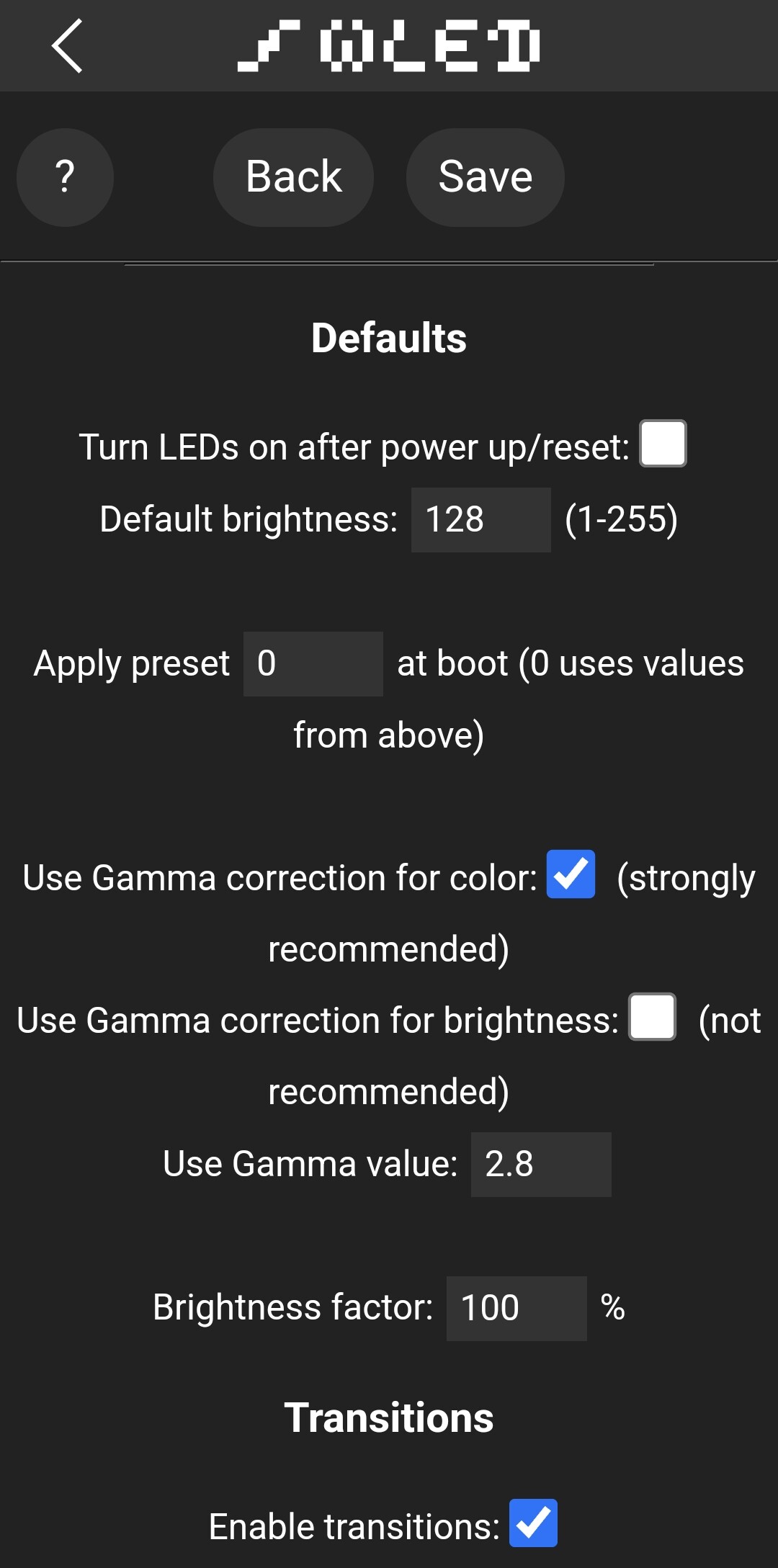

Do you have "Turn LEDs on after power up/reset" checked" in WLED's LED Preferences.? This is not in Hubitat but using WLED app or IP address in browser. I believe that is default option when installed.
Yes, i do.....should i have it turned off?
Last night, i woke up and all devices were on!!!! One thing i noticed was devices are set to wifi channel 1 in WLED app, but router is set to auto. Would this be causing this problem?
Yes uncheck it! I've read that some ESP32s with USB-C have less than reliable power and might cause device to reset and affect WiFi connection. Something else could be causing it but I bet changing that setting will stop the LED lights from coming on. It's not stopping the cause but it's stopping the result.
