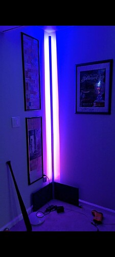

AWESOME!!! My latest WLED project wasn't quite so complicated. I created a DIY version of Govee's Floor Lamp that's 7'-11" tall (I have 8ft ceilings) instead of the 50-something inches of the Govee.
Govee's version:
Mine:
It's two LED strips wired in parallel on an 8ft aluminum angle iron pointing toward wall controlled by a dig-uno. That's not its final resting place. Currently, I am brainstorming the best way to create a dashboard that will allow me to control features of each of my three WLED projects from same dashboard. It is probably easier just to put a dashboard link to the WLED GUI though.

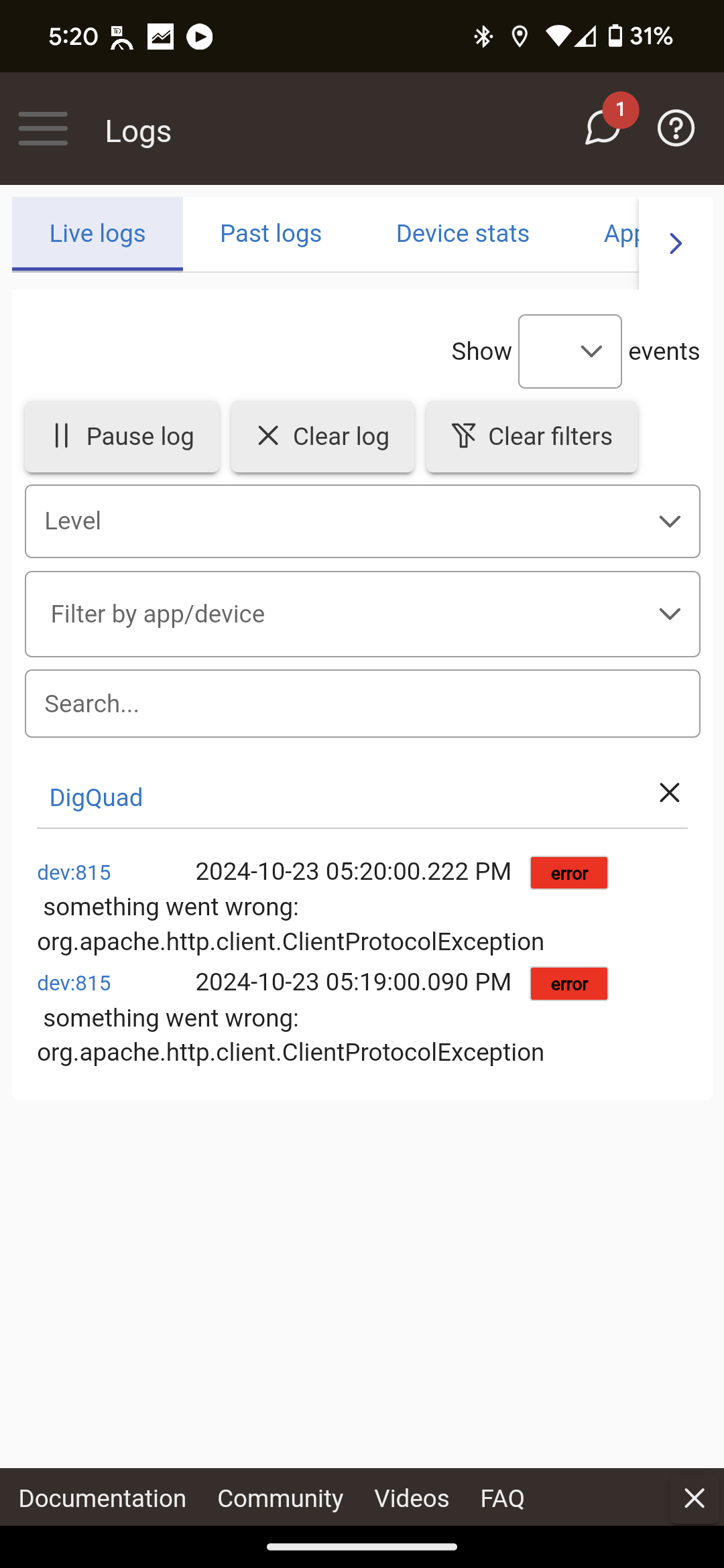

Is there a way to prevent the WLED integration from generating this log error when it's offline? I have logging off for the device.
Answered my own question. The driver gives a 1hr interval for Refresh by default but seems like on initial setup, even though it says 1 hour, it refreshes every 1 minute. Disabling the refresh interval removes the error in log/scheduled refresh.
