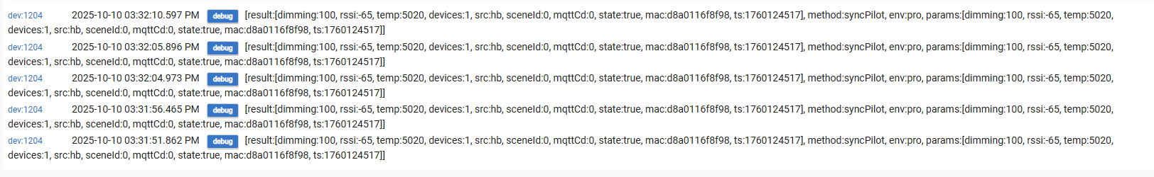

turned on debug logs for the device... seems pretty chatty for a bulb

When including logs, a screenshot is prefered. They are easier to read than an copy/paste.
no errors, i will keep eye on it
