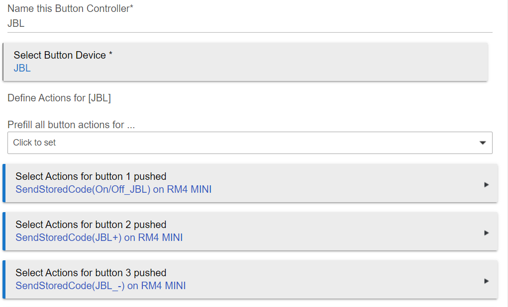

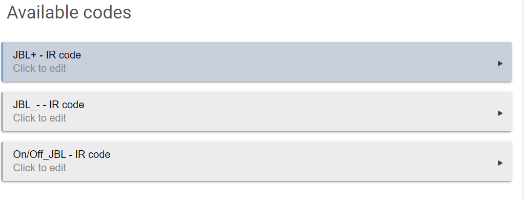

finally bring my RM4 mini to HE, and start to add the button from JBL SB250 surround, but i have some problem , learn ON/OFF button, Volum UP, Volum Down
The button "JBL ON/OFF" is working OK ( ) but "Volum UP/Down" do not send nothing....i check the led from RM and seems to receive the command (led is blinking) but nothing happend.
I tested the code direct from app and nothing happened.
