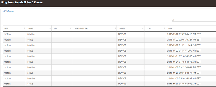

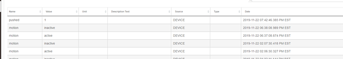

It seems to be setup right, I get motion events just fine on this device and my other devices but not seeing any push button events when doorbell is rung on several tests.
Instead the kind is "ring". If you update your IFTTT applet to have a kind of "ding" instead of "ring" it will fix. I've already corrected the instructions on the app's IFTTT page and pushed an update.

Your suggestion worked to change the JSON body in IFTTT to ding and verified it's showing correctly now on your instructions on the app now too after updating the app just now too.

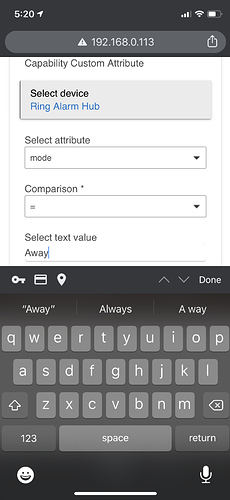

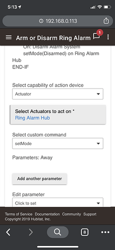

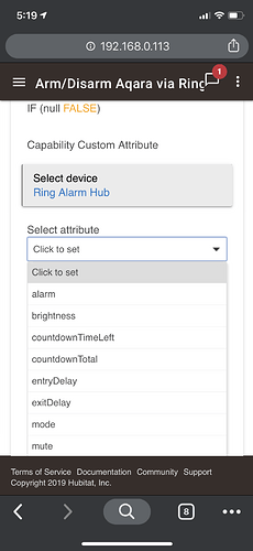

I have a question: in an earlier post, you mention that the Ring alarm can be armed through the RM. I tried, but can’t yet figure out what action to run to do this... I would love to get some help on this if possible.

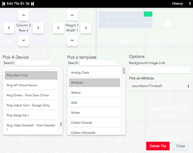

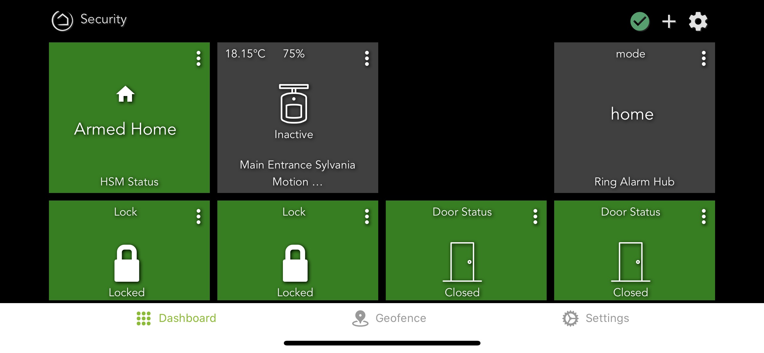

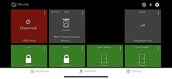

Now my next question... is there a way to add Ring alarm in a Dashboard? This could be to view its status or to change it if that’s possible... I’ve tried all the templates that I could see, but to no avail...
Select 'Ring Alarm Hub' then select attribute in the template list. You can't change the Ring alarm mode from there, that I know of, but you can view countdown timers and status. You could sync HSM to Ring and change Ring's mode from HSM.
Thanks @JNS! I’ve tried the “mode” attribute and that does allow me to see the mode status, which is what I was primarily looking for.
As for syncing, I’ve got HSM synced to Ring, but will wait to synch the other way around. I have a monitored alarm, so don’t want to accidentally have it trigger on me...
