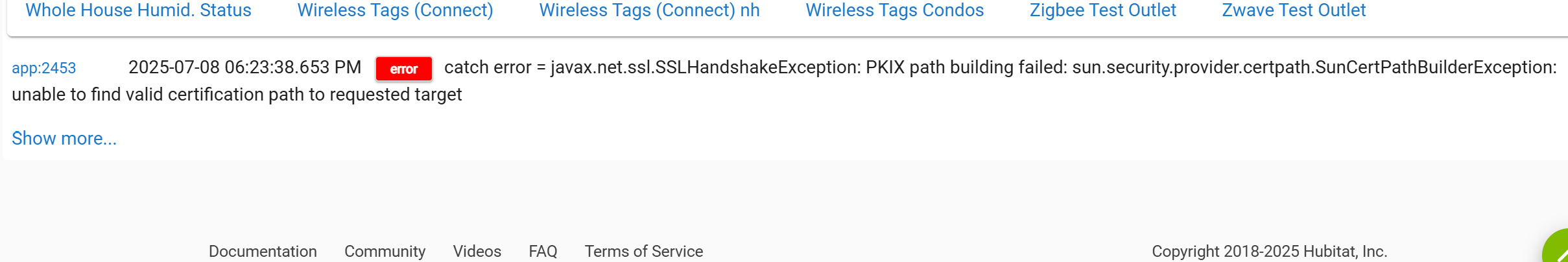

Wireless tag drivers stopped working on all my hubs with this error
already tried removing reinstalling same error ... any ideas. looking up message was not helpfull. lookes like some java key in the hub may need updating.
@bobbyD
it appears the code breaks down at this point the swaptoken api call to the hub is just hanging
http://192.168.1.109/apps/api/96//swapToken?access_token=xxxxxxx-8772-47ee-a3b0-7c9aea4f8810&?code=96aa4c7a-f09d-4a90-80b1-xxxxxx&state=47e92ea7-e615-4b90-8f48-xxxxxxxx
Looks like self-signed or expired certificate somewhere in the HTTPS request.

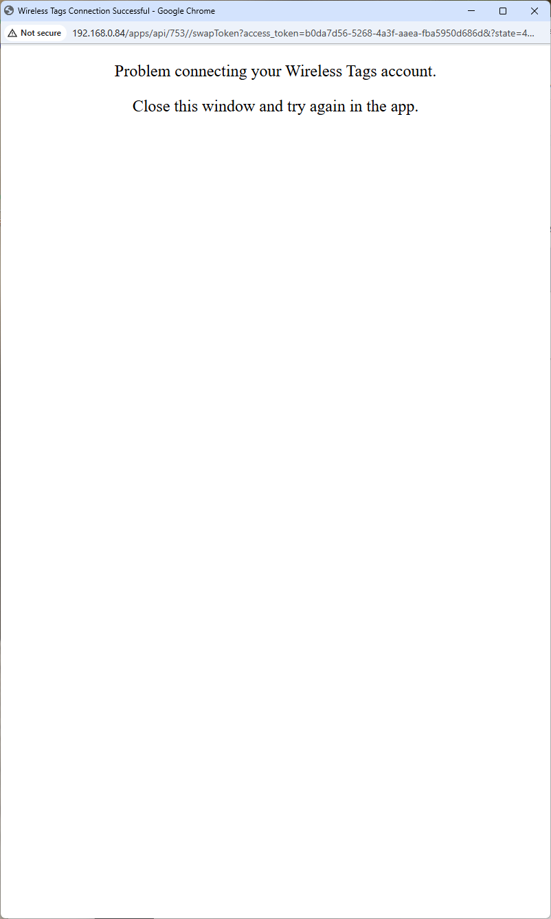

My wirelesstag integration recently stopped working. I tried reinstalling the code. That works well. Adding the app fails when attempting to "Grant access to Hubitat." That generates the error "Problem connecting your Wireless Tags account. Close this window and try again in the app." Have others reported the same issue? Suggestions?
Details follow:
Hub: C8 Pro
Platform: 2.4.2.129
WirelessTag Integration installed by Hubitat Package Manager had been working flawlessly for years. It failed recently. The WirelessTag developer and community claim the API has remained the same for years. The Package Manager no longer supports the WT integration, so I installed the code from Github. Both the driver and the app code installed successfully. App OAuth succeeded, and the WT site shows access granted. Subsequent attempts to install the program failed at the authorization step with the "Not secure" error message.

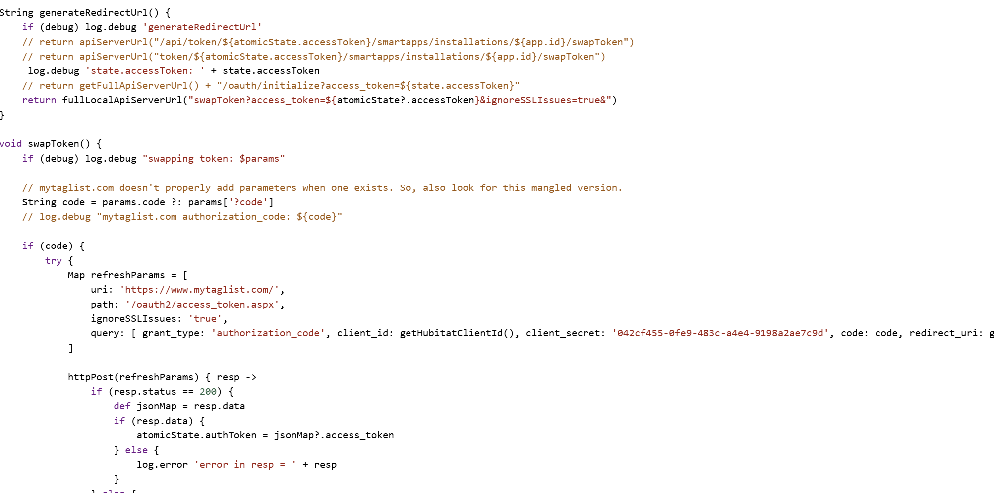

How is http call made?
For regular httpGet/httpPost/asynchttpGet/asynchttpPost calls, there is ignoreSSLIssues: true flag in the request parameters. It will turn certificate validation off entirely.

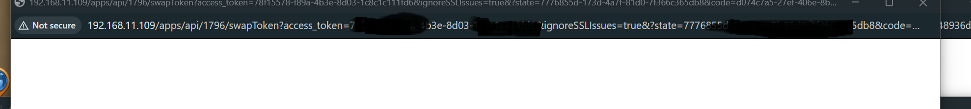

here is the call. i added your ignore ssl issues to the params i assume that is the correct way but it still hangs aon the swapaccess tokens call with the same error. am i doing it wrong?
in addition, i also added it directly to the swaptoken redircect url..
Make it just plain boolean true, no quotes.
the quotes have noting to do that url is going external.. the return does have the ignore=true and has no effect
The ignoreSSLIssues: true parameter is something specific to the hub, and the quotes, or really the parameter value, matter there. It wouldn't make it to the external system (I'm not clear with what you mean about seeing it there), and adding it as a query string to the URL is not a valid approach (I guess you would if you did that?).
Thanks for the help.. got it working eventually

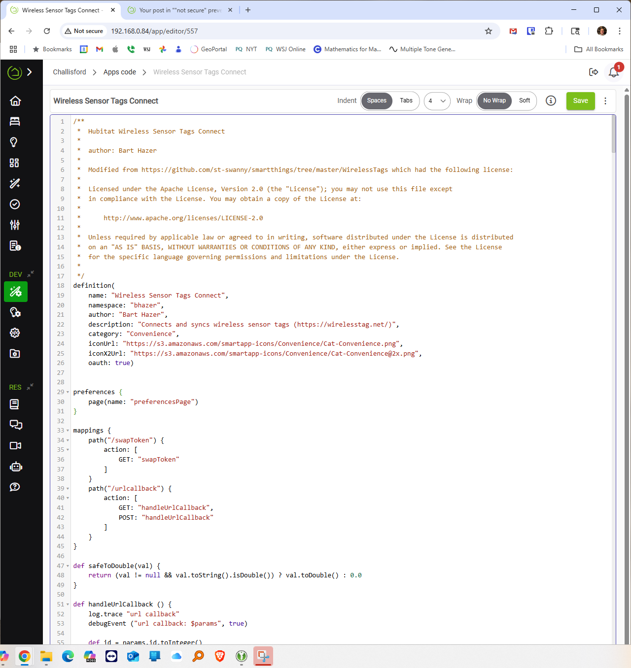

For anyone that wants the changed code it is here:
You may have to remove and reinstall.. i did.
Remember to enable oauth in the app source code before adding the app instance.
