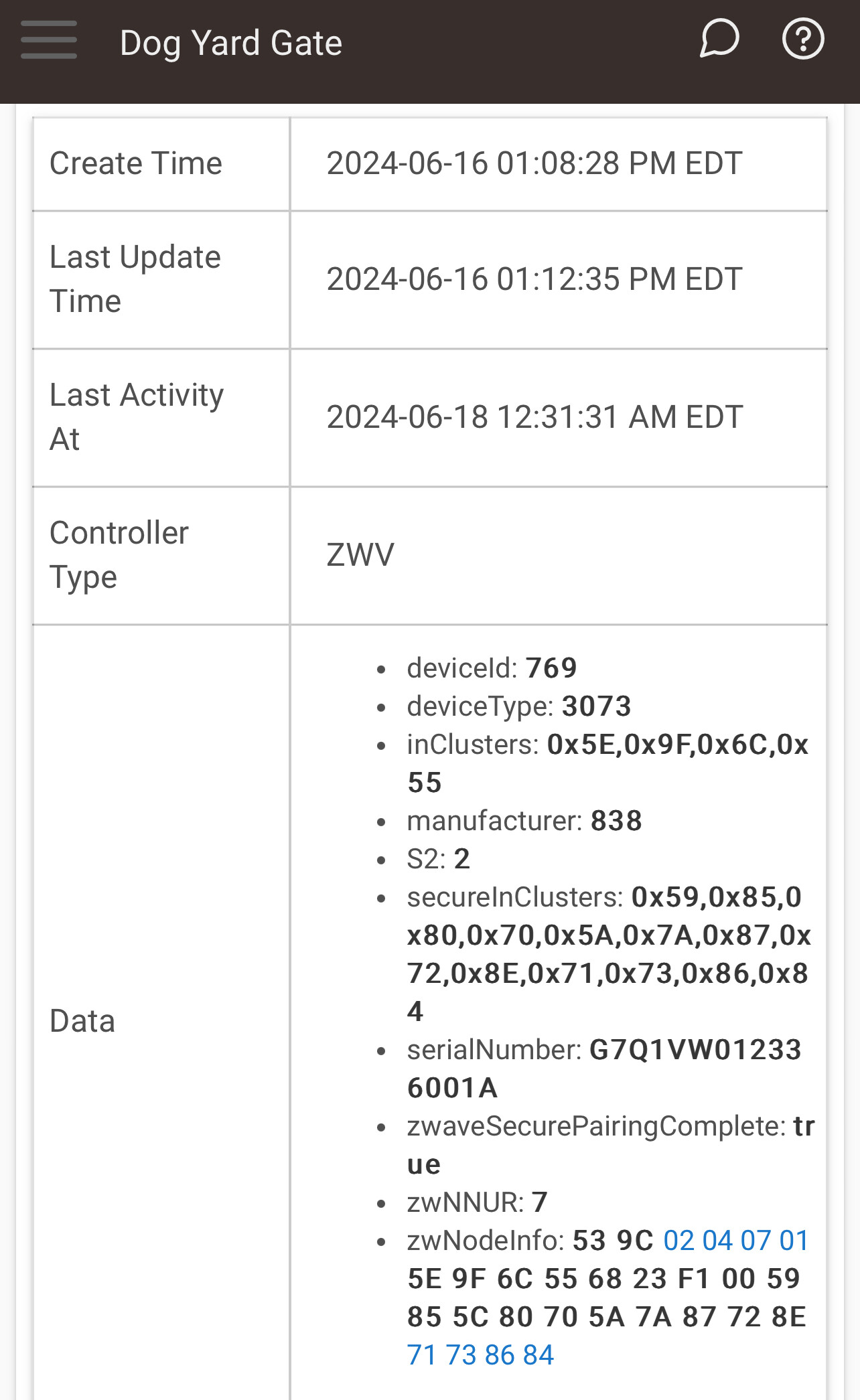

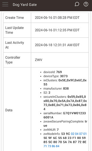

So I have an outdoor ring contact sensor for a gate o the other side of my house furthest from my ZWave hub. I do have a 700 series repeater plugged in the wall about 20ft from the gate but the contact sensor is connecting to a ZWave MultiSensor in my 2nd floor bedroom instead. I’ve tried running a repair a few times to no avail as well as shutting the ZWave hub down and powering it off at the plug for a few minutes before bringing it back up again. Bottom line is when the contact sensor is on the gate, it loses signal. I bring it back into the house, it starts to respond. I have a C7 hub with external radio antenna and this is the only device I’m having a connectivity issue with. Curious if purchasing a C8 that support me ZWave long range will fix this issue?
Here is the details of the contact sensor.
