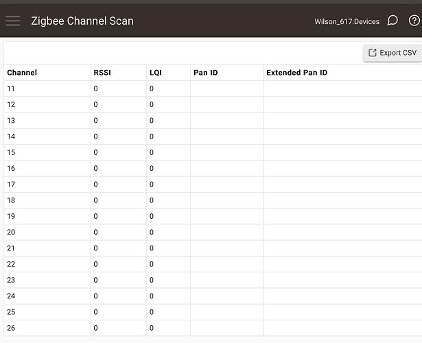

Also have you done a zigbee scan of the channels within the zigbee settings, you may find that there are more than one device on the same channel that your C8 is using. I had that issue with my C4 (before I changed it to a C7) and my other C7.
3 of 4 joined ok. The fourth refuses, but joined hue just fine. The res are “old” zigbeesemgled bulbs and hue motion centers.
No, I had t even thought about doing that. Forgot I even could.
This doesn’t look right either. I know there are at least three hubs. This one, a hue hub, and a C7 that I turned on last night to experiment with adding a motion sensor to. That added no problem to the C7. I’m tempted to just move all the zigbee to that C7and call it a day, I have my rules and most apps on a seperate hub any way, so it would just be feeding devices from 2 locations instead of one.

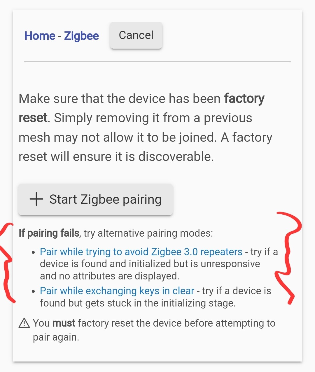

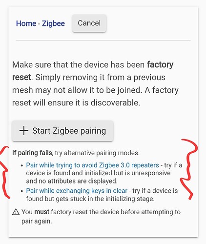

Have you tried the additional pairing modes for devices that are giving you trouble?
Yeah, I did both of those many times. They were still either not being discovered, or would get stuck in initializing, even doing the pairing in the clear.
A few times I even put it on the shelf right next to the hub , no dice.

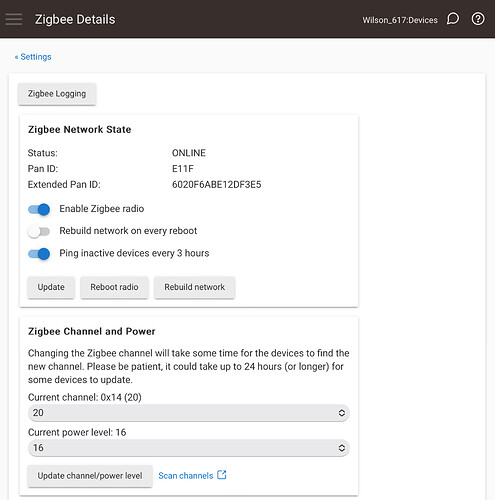

Can you change the channel to something else than 20? Try 21 through 25. See if that makes a difference.
Sure, that’s just what it defaulted to. Is 20 a problem channel?
I went to 23, we”ll see what happens.

I notice in comparison, my Zigbee power level is set to 8. I think that was done by one of the updates last spring when I (and others) were having some issues with pairing (my case was a couple of Hue motion sensors).
Not to sidetrack (we can put this somewhere else if desired) but @bobbyD - are there instructions for determining or tuning the Zigbee power level?
I'll need to check, I haven't touched the power, but I think mine may be set at 12. If so that is where the default was when I powered it up (replacement hub).

In terms of not being able to pair them, or something else? I have a few in my mesh and they've always been a pain to pair, but once they are in, they are rock solid. You can go up on power to see if that makes a difference. I keep my production on channel 23 with power 16. Going higher than 16 may make Zigbee stronger but may impact Wi-Fi devices. I don’t recommend going up to 20.
