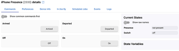

Looking at the Virtual Presence with Switch device now. Potential?
Yes that's what I'm using. The automation in Home:
  • When I arrive at 'my geofence' - turn on 'John' (my virtual presence with switch)
  • When I leave 'my geofence' - turn off 'John'
Excellent. Looks like I can turn presence on and off with Apple Home. On=Present Off=Not Present.
Yup that's it as I've just edited the post above to show an example of mine. The only hiccup I had was that I needed to set it up separately for my wife arriving/leaving on her iPhone even though she's in my Apple 'family'. I guess that's a privacy thing to stop me stalking her without her permission. If you use the generic 'Home' geofence I could do 'when anyone arrives/leaves' but once you create a separate geofence on a family members phone, that fence is specific to them.
