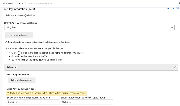

If you're there, can you tell me what user app does the voice to the HomePod? Thanks.
edit: Found it. AirPlay Integration (beta). Note: beta?

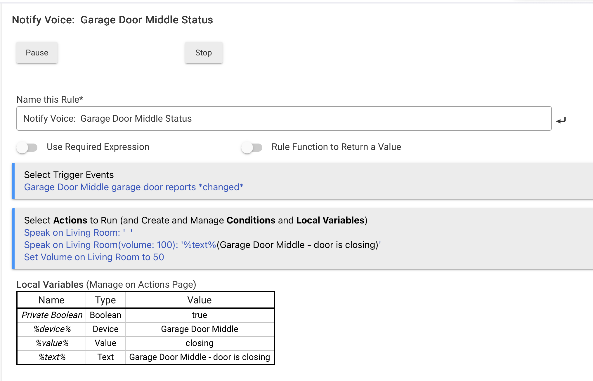

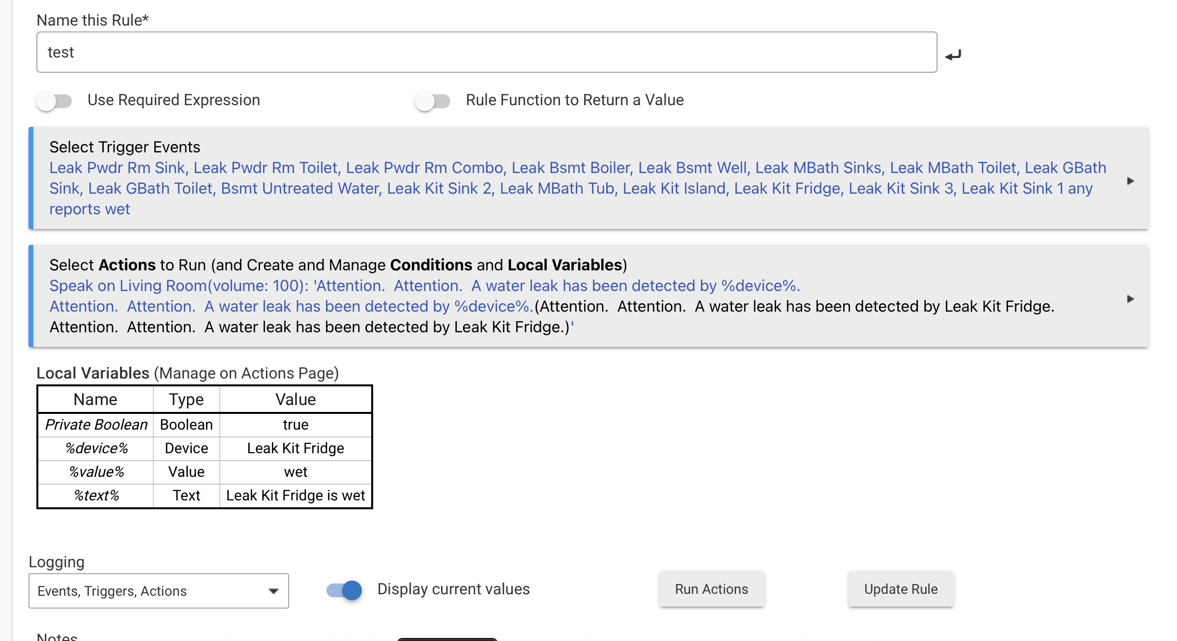

Got it to announce changes in a switch state. Next up: Leak sensors! Would be awesome to have more definition that the EcoLink.

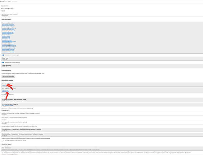

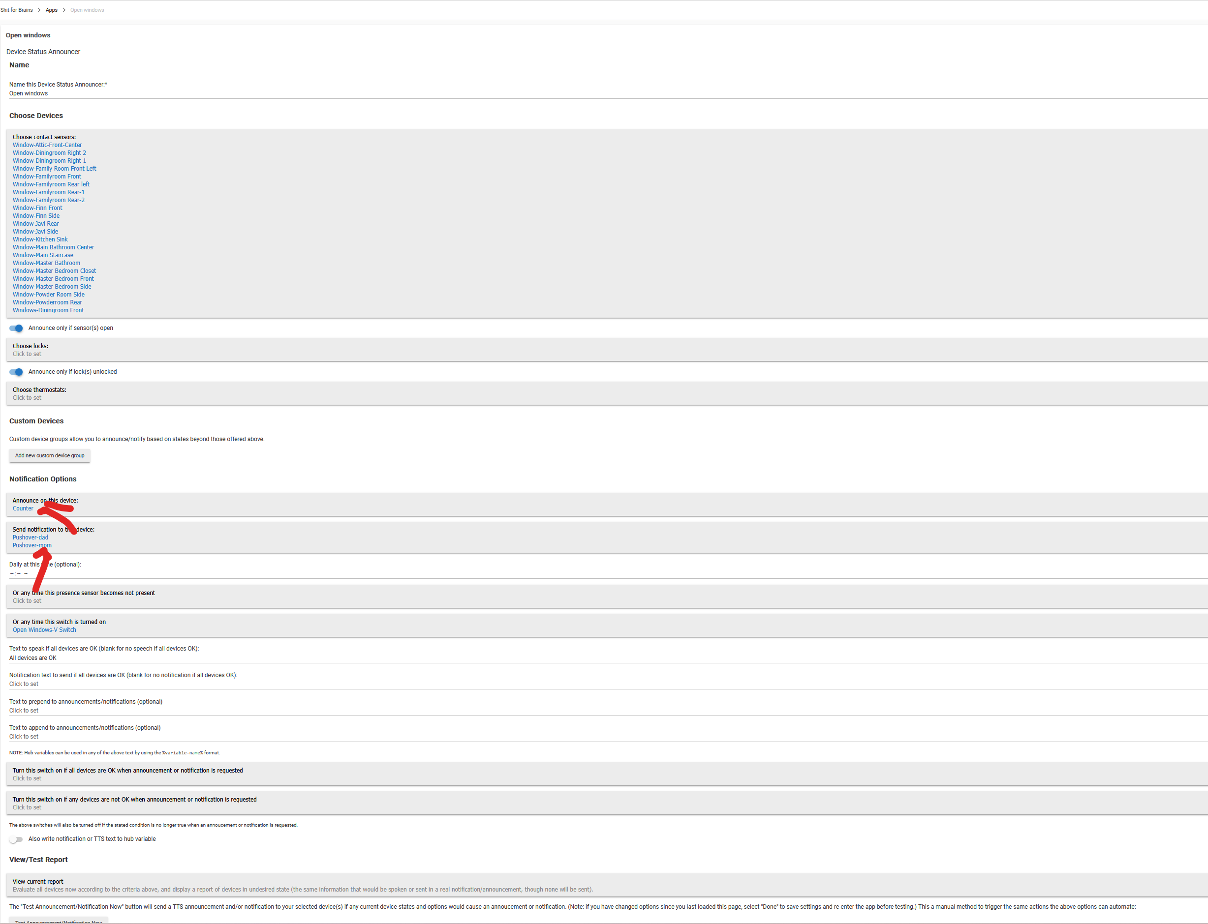

Device status announcer. You can modify this to suit your needs. In my example it handles all my window sensors.

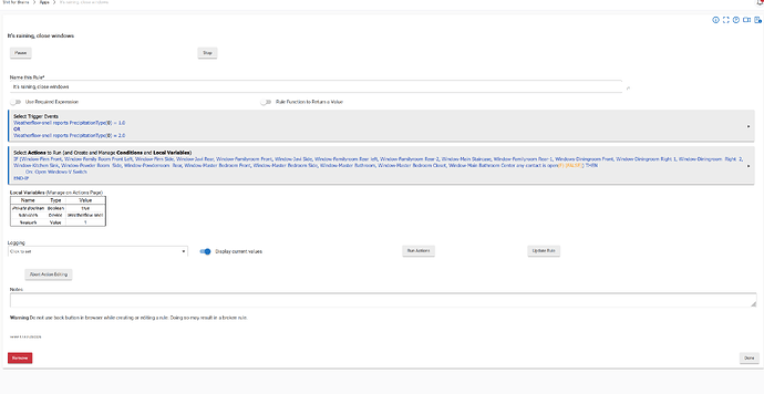

Rule activates virtual switch triggering device status announcer and telling me exactly which window is open
DSA
Thanks. I had never heard of DSA.
I used RM only, just now, for leak sensors; it seems to work.

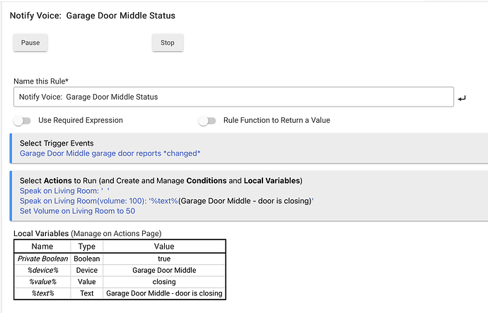

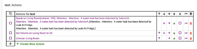

I wish I could resume HomePod mini playing audio and at a lower volume, but I've only been able to do that with manual (voice) intervention.
You can do it using a variable. Keep the variable populated with current volume. I have announcements at 100% then add a rule immediately after the announcement that sets the volume to the previous level present in the variable before the change.
Super. Is there a way to resume playing of media on the pod?
Honestly not sure, I don't think so.... @bcopeland Any way to add PLAY control to home pod devices in hubitat?
Unmute on the Music Player option doesn't work either.

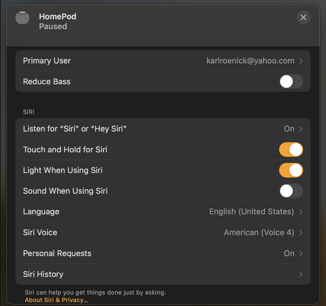

So, if one HomePod is voice receive disabled, couldn't that be use to make "Hey Siri" commands to another one that is still listening. Again, could open a new world of things that could be done-anything that can be done by Siri, which is pretty much. I'm not jesting as much now.
edit: Uh oh. It probably knows my voice.

Interestingly, It doesn't seem to work on the first 'wet' actuation.
It needs another one follow before it announces.
Pushover text still work the first time.
Hmmmm

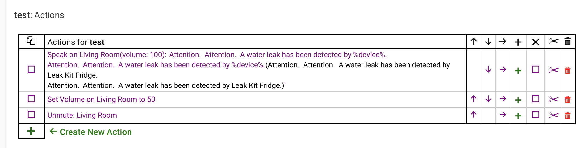

edit: An arbitrary 5 second delay at the start of actions seems to have fixed it.
Hubitat's built-in TTS engine can work locally, but not the first time a new piece of Text is requested. When the built-in HE TTS engine is called with a new text string, the hub reaches out to Amazon's Polly cloud service (IIRC). This returns the audio file which the HE hub then caches locally on its internal eMMC storage. If this exact same TTS string is requested again, the locally cached audio file is used without any need to reach out to the cloud.
Thus, if local TTS is desired, it makes sense to not include things like date, time, or numeric value of a sensor in the text string. If the string keeps changing, then the hub has to reach out to the cloud each time.
I just tested this. I can have all of my leak sensors be identified off line if they are activated once. Of course there are 15 of them.
I got rid of the 5 second delay and it seems to be working.
edit: I take it back-it didn't work.
This seems to work:
