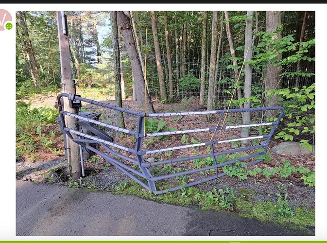

Questions: Do you have presence close the door? Have you ever had any erroneous door operations because of bad presence info? My car isn't 60k, but I did have the door come down once on the hatch spoiler-luckily it is robust. Then there was the crumpled farm gate caused by a departing heating oil truck incident. Both related to motion sensors and faulty logic, as I recall. The ST sensor would act up too and open the garage door in the middle of the night. It's made me cautious about automating the gate/garage door.
