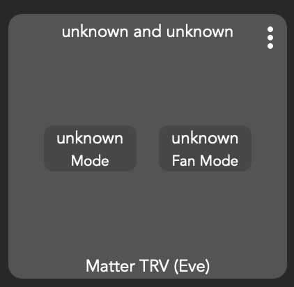

You’re right that this isn’t TRV-specific — proportional control thermostats exist in many forms.
What matters here is that Matter defines a single, standardized Thermostat device model, which explicitly covers heating-only and proportional-control devices, including TRV-style actuators (Matter Spec 1.x, Thermostat device type).
So what I’m asking for is not dynamic capabilities, but correct exposure of the standardized Thermostat/TRV-related capabilities already defined by Matter.
Dynamic or device-specific extensions would only make sense after that standard model is correctly implemented.
Ok, so really what you're saying is that the Generic Matter Thermostat driver is buggy and should be fixed?
Not sure — I don’t know whether this is a bug in the Generic Matter Thermostat driver specifically, or a more general limitation in how Hubitat maps Matter thermostat devices.
Conceptually, Matter defines a Thermostat device model with a set of mandatory and optional clusters/attributes. A TRV / heating-only thermostat typically exposes only a subset (e.g., setpoint, system mode like off/heat, and measured temperature). A compliant controller should handle that subset gracefully: it shouldn’t require “missing” clusters to exist, it should simply use what the device actually exposes.
From a user perspective, the expected result is straightforward: a usable device in Hubitat with (1) a setpoint you can change, (2) the current room temperature, and (3) an off/heat mode — and a dashboard tile that can control/show exactly those.
Right now, that’s not what I’m seeing when the device is shared into Hubitat via Matter: the standardized thermostat capabilities are not exposed/usable, and the dashboard can’t control it properly. So yes — something in Hubitat’s Matter thermostat handling (driver and/or platform mapping/UI) needs to be fixed for these devices to work as intended.

To be honest, I suspect part of the difficulty is architectural: Hubitat’s underlying framework was designed long before Matter, around a driver- and capability-centric model that works extremely well for Zigbee and Z-Wave. Matter introduces a different, more dynamic device model, and adapting to that without breaking existing logic is likely non-trivial.

All of this is nearly directly based on the ZCL (Zigbee). It's nothing new. The one thing that seems new is the feature map.
Note that ONLY the Thermostat cluster is mandatory !
Right, and we're back to the dynamic capabilities request (sorry! :smiley: ).
Here are the ways to handle "optional" clusters (capabilities) in a Hubitat driver which, as Robert explained, by design, has to declare those at driver compile time:
  • include only mandatory capabilities (e.g. in a "generic" driver)
  • create a device-specific driver that includes only those optional capabilities the actual device supports (and adress any manufacturer-specific clusters)
  • include all optional capabilities and "wing it" it at run-time. Some capabilities won't work, which may be confusing to the user, but those that the device exposes would work. Some community drivers work this way.
