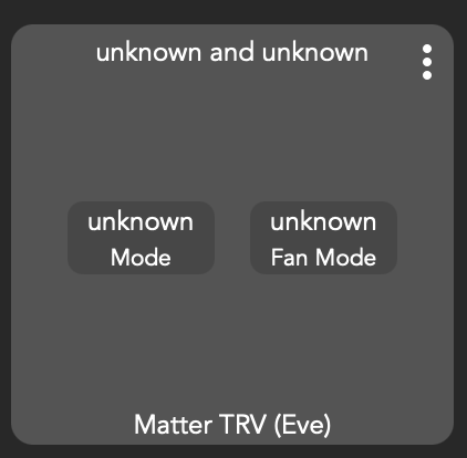

Let me clarify, because this is specifically about shared Matter devices, not direct pairing.
Hubitat currently cannot pair Thread Matter devices directly.
In my setup, the Eve Thermo (Matter TRV) is paired to Apple Home, and then shared to Hubitat via Matter.
The issue is what happens after that:
  • Hubitat receives the Matter device
  • but does not correctly identify the device type
  • the device appears as “Unknown / Other”
  • and none of the standard Thermostat capabilities are exposed
According to the Matter specification, a TRV exposes well-defined device types and clusters.
A controller consuming a shared Matter device should be able to map those automatically.
This is what I meant by “if Matter had been implemented according to the standard” — in this case, Hubitat’s Matter consumer side is currently incomplete for TRVs.
It simply does not work. Like previously explained.
Capture d’écran 2026-01-02 à 19.24.11
Being a true TRB is simply a big plus.
A programming interface is great — but for standard Matter devices, it shouldn’t be necessary.
The whole point of Matter is that device types and capabilities are defined and work out of the box.

I agree with you in principle.
The issue here is that in Hubitat’s current Matter implementation, neither applies in practice:
  • the device does not work out of the box
  • and there is no programming interface available to bridge the gap
So while the statement is true conceptually, it doesn’t reflect the current real-world behavior for Matter TRVs on Hubitat.

Some of this may not be the fault of Hubitat'. As below, none of the Matter thermostats that were tested exposed certain values. So if the thermostat manufacturer doesn't expose something, how is Hubitat to implement such things?
Are you sure that your TRV exposes these values?
Sure there is! What's stopping you from writing your own Matter driver for your TRV if you are not happy with any built-in options?
(Or an app to control it if you're just not happy with Dashboard, which really seems to be it.)
@pascal.nohl, @kkossev wrote a matter TRV driver about a year ago for the Aqara E1 I believe, you might want to reach out and see if he could help you get your TRV up and running.
Thanks to Hubitat now I have TRUE Smart Apartment. Everything is 100% automated over 5 years span. True Automation means you do not need any Button Push (well there are few Buttons around for things which is impossible to automate algorithmically), no Voice Commands, no Dash Boards. Everything is driven by sensors and associated RM Rules. Cloud-based integrations basically no go (only 1 or 2 left for none critical automations). And thanks to Hubduino project I can build any device I want if it does not already exist.
I don't know any other platform (it doesn't mean there is no other one around) with this huge capabilities and flexibility.
EDIT: you are correct, I read too fast. ~Not strictly true~
But again, this isn't really your issue, is it? If the device was correctly recognized when paired via another controller, would that work for you?
I didn't see anything specific to TRVs in the Matter specification, but could have missed it. In any case, I fail to see what you believe is special about a TRV, it isn't functionally different from a line thermostat with proportional triac control. Any thermostat, including TRVs, should expose the Thermostat and Temperature clusters.
Works for me, but, granted, I don't have any Matter thermostats, only plugs, switches, dimmers and a number of sensors.
You might however have found a bug for your thermostat (unexpected fingerprint? I hear Matter devices pick arbitrary endpoints sometimes...) and perhaps for Matter thermostats in dashboards. I saw some posts here about Matter thermostats not reporting thermostat operating state, maybe that's what's breaking the dashboard tile? Did you already try getting support to look at this?

I think this is an important distinction to make.
The TRV you’re referring to is not a native Matter TRV.
As Meross states on their own website, “Meross Matter Hub MSH450 is needed for installation.”
In that setup, the hub is the Matter device, not the TRV itself. The hub decides which capabilities are exposed to other controllers.
The same applies to older Bosch TRVs: they can be made available via Matter through the Bosch Smart Home Controller, but only the newer [+M] models implement Matter natively at the device level.
So comparing hub-bridged devices with true native Matter TRVs isn’t quite apples to apples.
My findings are specifically about native Matter TRVs and how their standardized device types and clusters are currently handled when shared to Hubitat.
Partially yes — and this is exactly where the conceptual difference lies.
Matter drivers are not supposed to be user-written or device-specific.
They are platform-level implementations of standardized device types and clusters.
The whole point of Matter is that:
  • the device type is defined by the standard
  • the clusters and attributes are defined by the standard
  • and every compliant controller implements those once, centrally
If users are expected to write their own Matter drivers, then Matter loses its purpose and effectively turns back into a per-platform integration problem — which is exactly what Matter was designed to avoid.
That’s why I see this as a platform implementation gap, not something that should be solved by user code.
