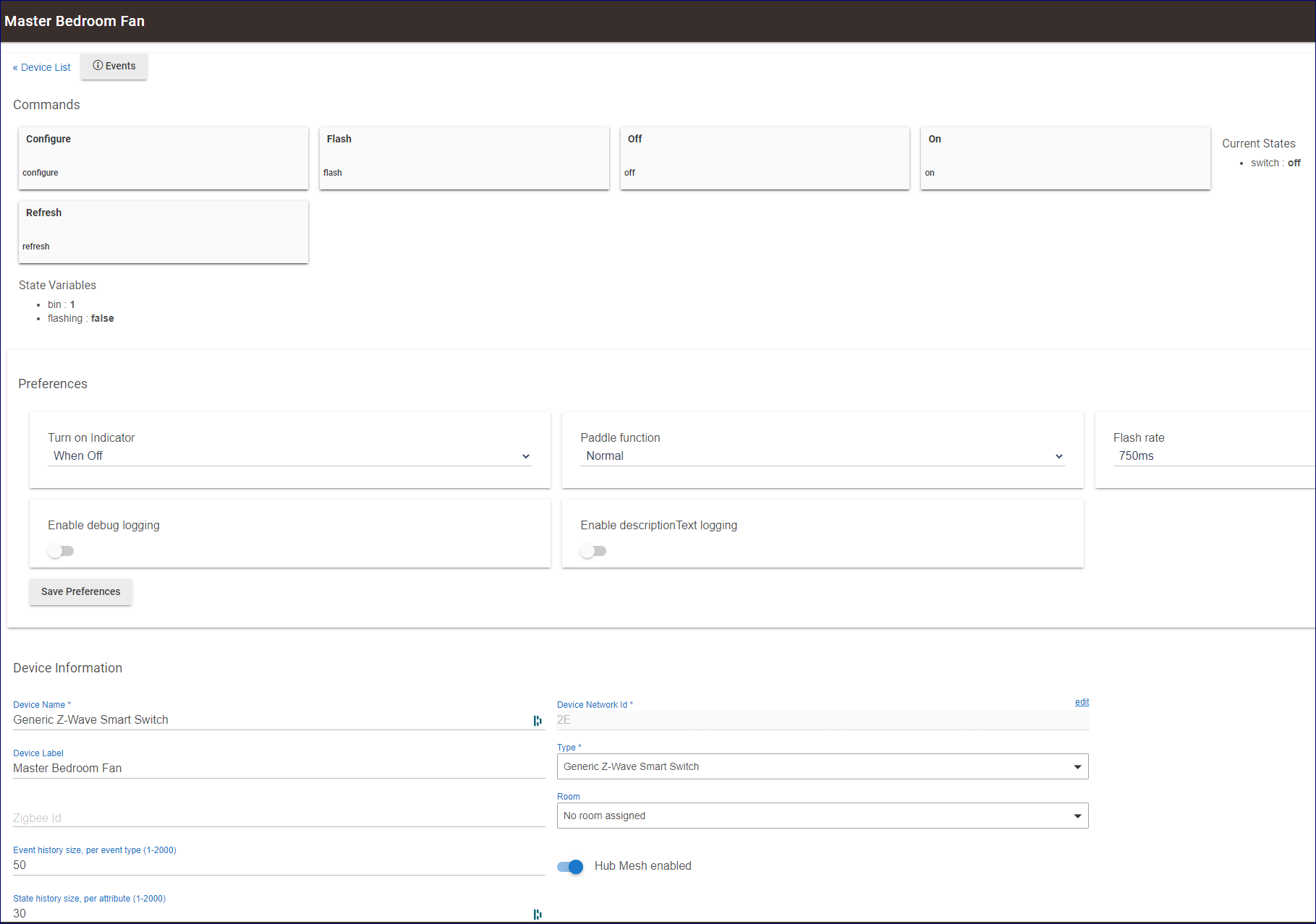

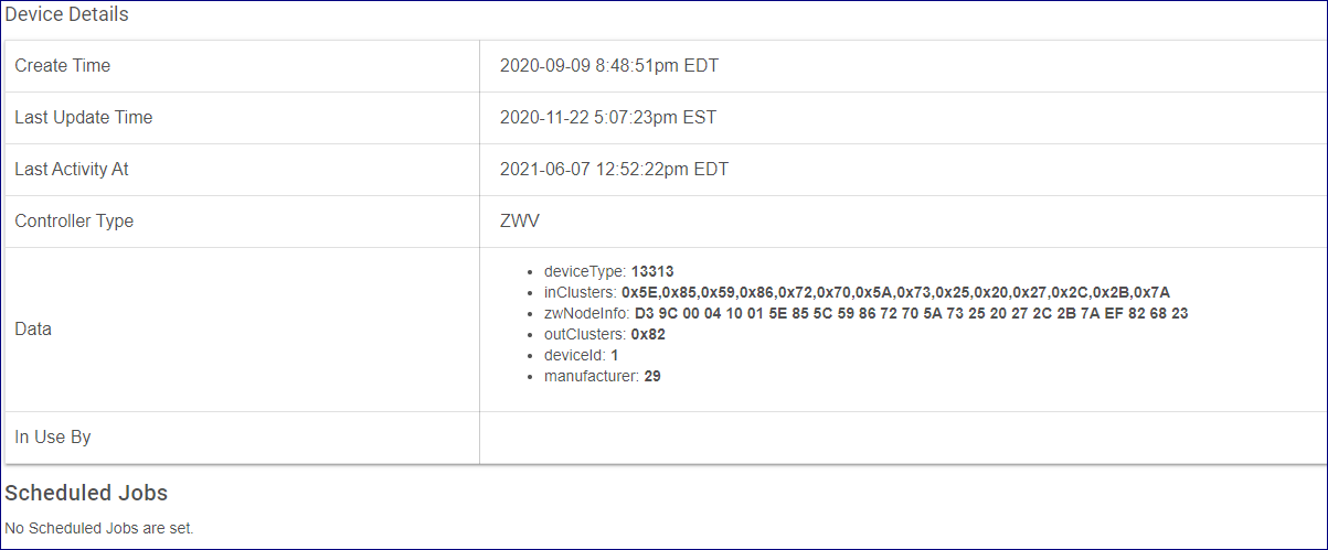

Question: I have a simple zwave plus switch(Leviton). Responds to the device page (on, off). However, it seems to have stopped recording events. Why?
Device page:
(Notice the last activity date/time. I just used it!)

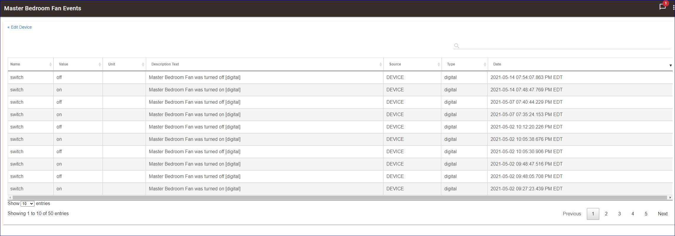

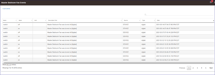

Device Event page:
C-7 running 2.2.7.126
Does anyone know why there is no recording of events?

Here is the switch:
Which is the driver used....

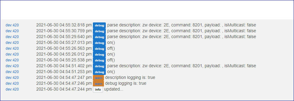

If you turn on debug logging, does anything show after a digital or physical event? If so, there's hope--perhaps the driver just isn't parsing it correctly. (In the logs, you'd probably see something like a BasicReport or SwitchBinaryReport.) If not, I'm guessing this is an older switch. Did you happen to have anything set up before that may have helped with at least physics events, like polling? Still wouldn't explain digital...
Turned on debug logging.

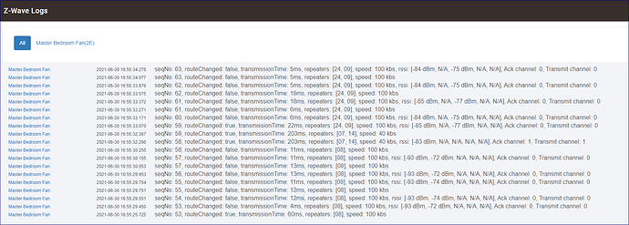

In the Zwave logs, we have action:

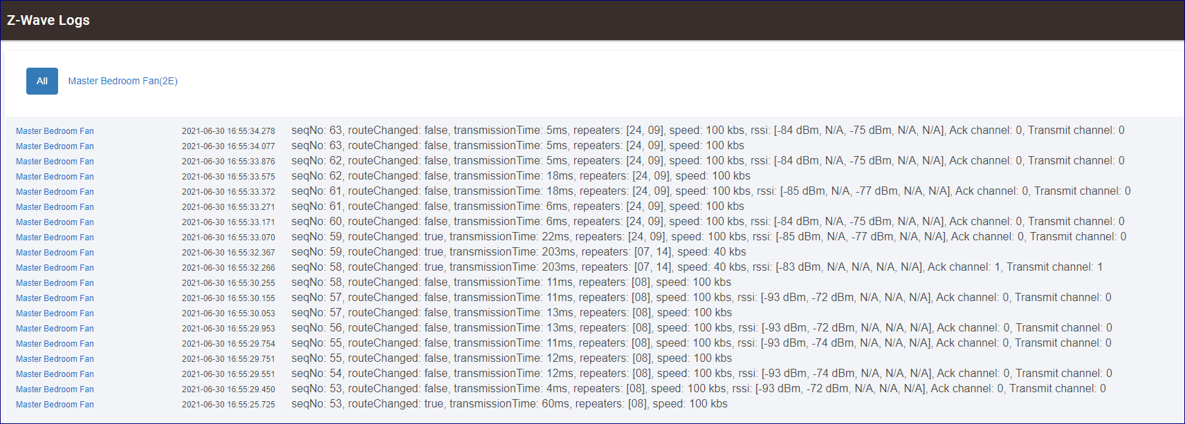

In the system logs we have action too:
Yet still nothing in the Device Event History.
Why not?

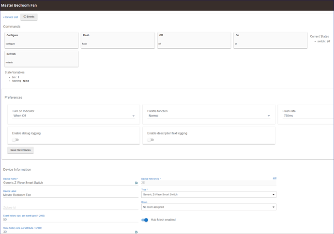

  1. I changed the driver to "Generic Z Wave Plus Switch", without any change.
  2. I did happen to notice that there are only 50 entries in the history. Could it be that when it reached 50 entries there is some sort of bug, and the device history doesn't "roll off" - I had specified 50 as the default (see my first screen shot).
    Could this be a bug?
    I changed the value, but it still hasn't "rolled off".

Yes, there's a bug with overly aggressive event cleanup, deleting events that are a week old or more. Similar bug exists for device states, although a referential integrity contraint prevents deleting current device states even if they're older. It is fixed in upcoming 2.2.8, and logic properly honors the value set with /hub/advanced/maxEventAgeDays/value endpoint.

Try switching to the Generic Z-Wave Plus Switch driver and hit configure .. Then try again..
That was the driver that I switched to. After switching I hit configure.
No difference. No history.
Still responsive to on/off, but not reflection of that on the device screen.

IF the ZWave action is there and a "Zniffer" shows the device is sending out messages when the device is pressed, then it would have to be the driver or the hub.
