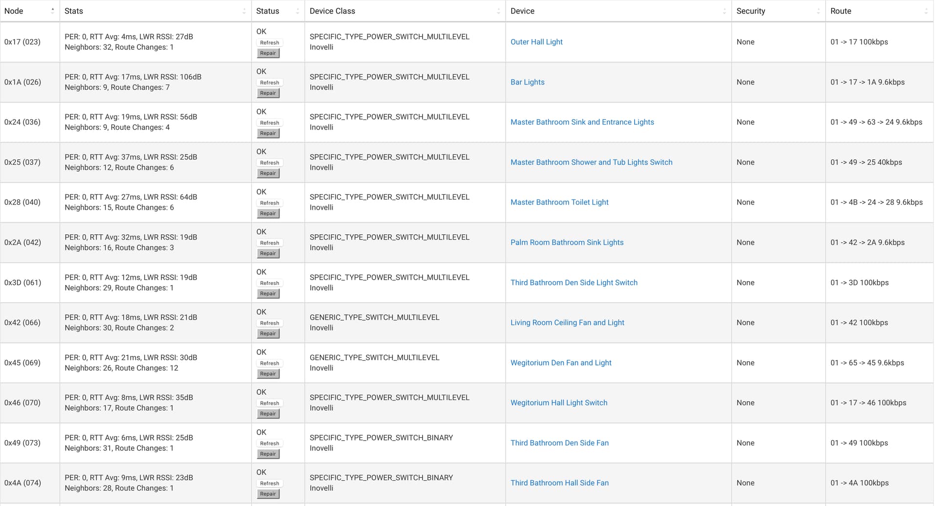

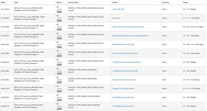

Here is a table showing the devices that went from faster to slower and vice-versa:
Here are charts showing, on top, the devices at 100, 40, and 9.6 while the bottom charts show the # of devices that are faster, slower or the same. You'll see that except for 1 day the # of devices that are now slower on the C-8 has always been higher than the # that are now faster.

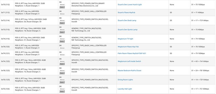

A quick scan of your ZWave details looks pretty good. Each device has more than a few neighbors and the RSSI is ok. RTT is low for the most part but not as low as I'd expect for 100k devices. From my own C-8 I have RTT of 1ms for 100k devices except battery devices and those are 4ms.
Looking at "Stuarts Key Fob" obviously a battery device that went from 100 to 9.6. On the C-8 it's got 1 neighbor and is using S0 which is known to be chatty, aka slower. However, it's not the slow you're looking for. S0 will cause 3x the packets (rule of thumb) and so it will take more packets to complete the exchange. 3x packets at 100k will probably complete well before even 1 packet at 9.6
Neither the C-7 or the C-8 handle those S0 devices during a join ideally. They will force S0 even when we don't want it. The only cure I know of is another ZWave stick as a secondary controller. However, since the C-7 didn't do better at this, I'm going to assume you had too much S0 on the C-7 as well and it's not the slow to focus on.
Next I looked at 0x28 "Master Bathroom Toilet Light" which has a RSSSI of 64 which is weak. I think 50 or more is going to cause an automatic drop in speed. I have one device at 50ms but it has a 4ms RTT and a speed of 100k, direct. You've got 27ms to back the weak RSSI

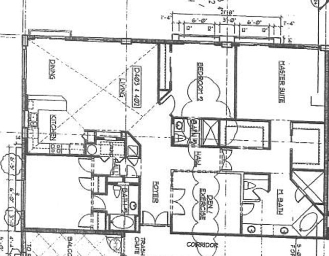

It is a 1 floor condo. I'm on the 4th, top, floor in the SE corner. So I have no one above me, or to the south or west. There is a unit below me and one to the the north of me. There is a corridor outside the east side of my unit so another unit isn't touching me on that side either.

7A Wegitorium Left Inside Switch. (on my floor plan that is the Den/Exercise room and the switch is inside it towards the bottom, just below where the double doors are shown. It is is a 2 gang metal box.
7B Master Bedroom Ruth's closet is the one on the extreme right in looking at the floorpan in the Master Bedroom. (looks like a backward "C").
3D Third Bathroom Den Side Light Switch is the little bathroom pretty much in the middle of the condo. The "den side" is the "top" side of that room, sharing a wall with Bedroom 2 on the floor plan. That is a little strange that it failed in that the hub sits on top of a hutch by the wall between Bedroom 2 and the Master Bedroom and it directly connects to the hub at 100.
The only one that failed on multiple tries (and even after the full repair when I tried to repair just it) was 6F. Stuart's Den Upper Hutch Light. That is also very strange as it is a plug that it sits on the floor almost directly beneath the hub and right next to Stuart'd Den Lower Hutch Light which is an identical plug. The upper (the one that failed) is directly connect at 40 and the lower one is directly connected at 100. I just tried turning the upper one on and off using both my Fibaro KeyFob and an Inovelli Red Dimmer that is in a 2 gang box just inside the door into the Bedroom 2 on the wall it shares with the 3rd bathroom. The light turned on/off virtually instantly. So, I'm not sure why it won't "repair".
Also, when the Z-Wave repair ran it said 6F was in Group 6. I don't know what that means. The Repair started out saying it was doing Group 1 and I saw a Group 2, but I didn't notice groups 3, 4 or 5. When I tried to repair 6F by itself it said it was group 1. While I have 49 Z-Wave devices it only tried 45, which makes sense as 4 of them are non-repeater button controllers (my 3 Fibaro KeyFobs and 1 Aeotec 4 button device).

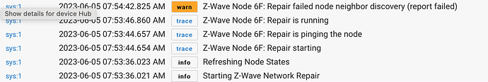

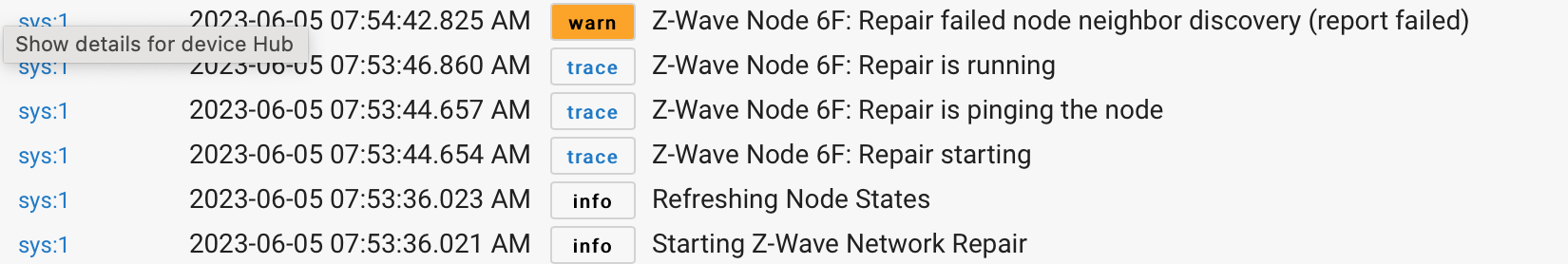

BTW, I don't think this really adds anything to it, but here is the log that gets generated when I try to repair it:
