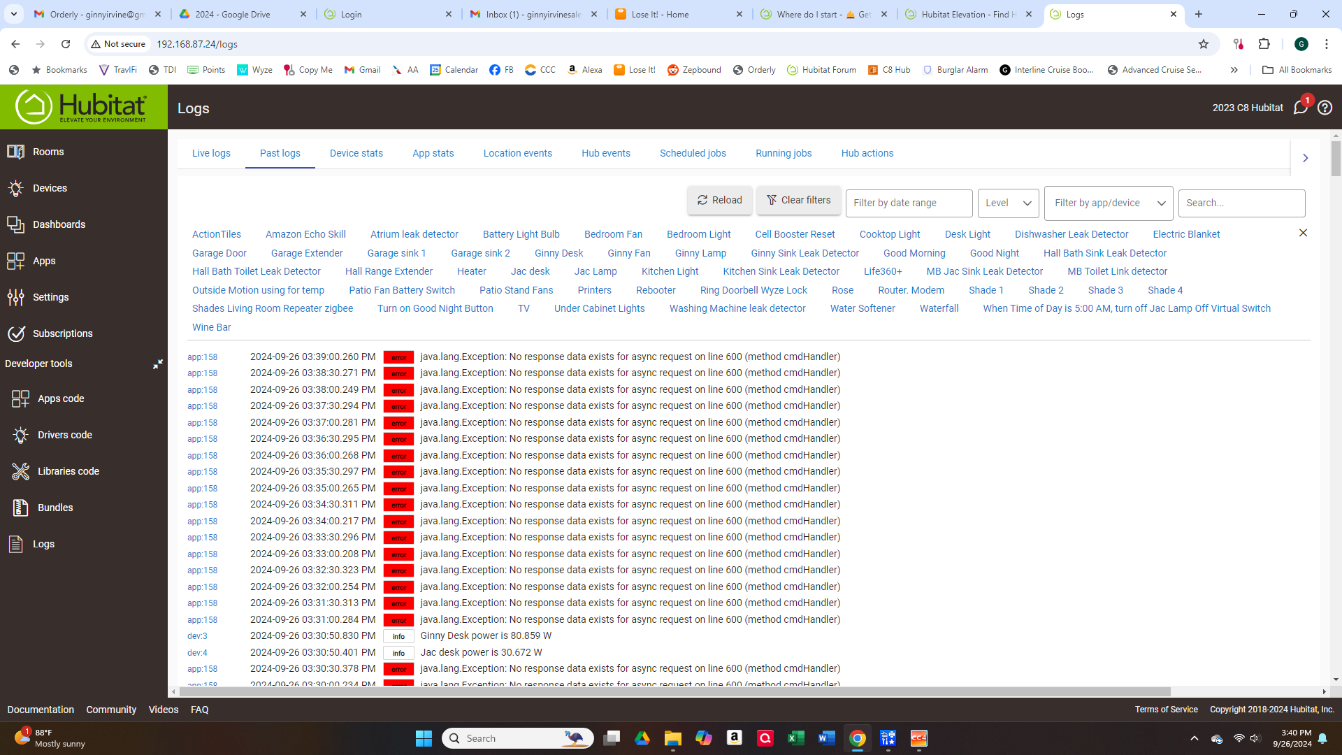

First let me say I tend to stumble around in the dark with this stuff. But I got something majorly wrong and I need guidance on where to start looking.
I have the Hubitat C8 and version 2.3.9.166
The last couple months, I keep having issues, things not responding, deleyed response. I got so feed up today it I had to make time to look well, under "Logs" I see this:
