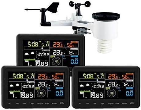

That's a good deal if you're looking for one with a display. Although I think I would still opt to use an additional temp/humidity sensor with it, since chassis heat build up is such an issue.

I see what looks like a version of the Ambient with an included colour display on Amazon too for not a lot more
I wonder if these really are EU licensed frequency versions.

I don't find this to be the case with mine.....I have a zooz motion sensor 5 feet from this chassis and the temps are always within 0.5 degrees of another. The Humidity reading is sometimes as much as 5% less than other sensors, but heat wise doesn't seem to be an issue.

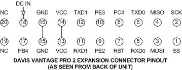

I also use a Davis Vantage Pro 2. I used an inexpensive USB to serial cable with some connectors I bought off e-bay to connect the weather station to my Linux server. I use the weewx software to log data to the "Citizen Weather Observer Program", as well as to record data in my influx database. From there I can graph the data with the same Grafana setup I use for my Hubitat sourced data.
Cable build information came from:
