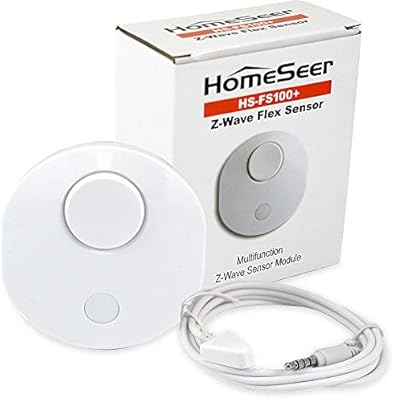

While the Samsung do seem really sensitive to vibration, you’re probably better to just put in one of these.

The HomeSeer light sensor indicated by @SmartHomePrimer is also a good idea if your washer/dryer have an LED indicator that turns on when they're done.
