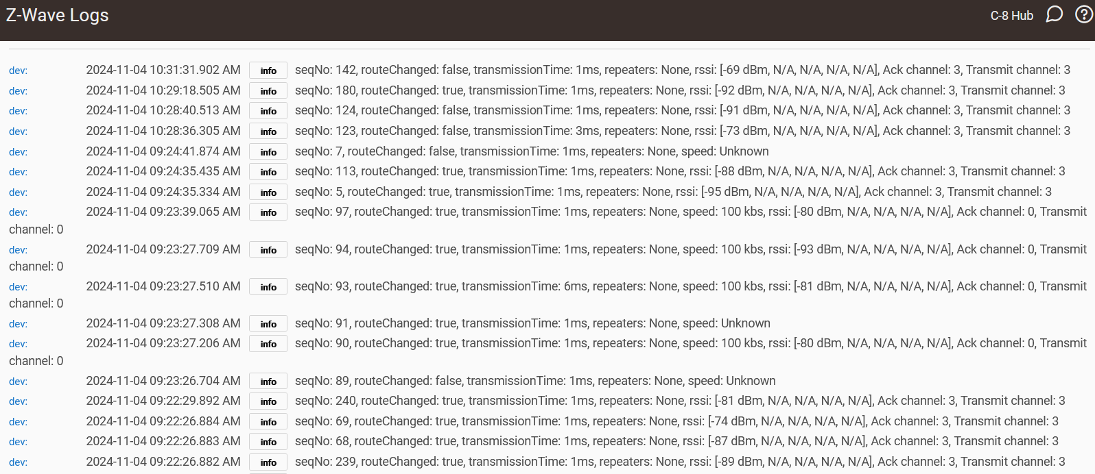

What Does "dev:" Mean In The Z-Wave Log?
I'm trying to track down a Long Range Z-Wave Ghost.
I'm seeing "dev:" in z-wave logs (example below).
Could this be the ghost in action, so to speak?
Would it provide any clues in how to identify and get rid of it?

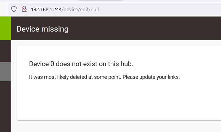

dev = device, clicking on the link should show you the device in question.

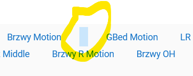

It's a blank on the z-wave logs page.
Just like dev:0, the hub.
If you click on info where does it take you?

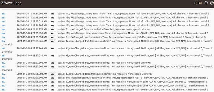

It's a clue, I guess.
It looks like there's activity:
I think DEV 0 is the hub.,.. @bobbyd can you confirm?
Did this ever get confirmed as the hub? I also see this and currently am debugging z-wave issues -- and would like to rule this out.
