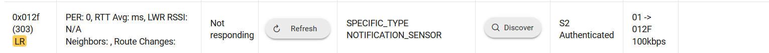

It doesn't show up on smartstart, and there is no way for me to tell what device it is referencing. I don't see anything missing, device wise, but I'll keep looking, I guess.
Is it still hanging around?
No, as I reset my zwave radio since then.
Usually just a reboot will take care of these now.
There is some sort of caching issue with LR nodes and stuff gets stuck in there.
I've tried a shutdown/power cycle once.
I'll try just a reboot.
Probably wont help if a shutdown did not.
Check the node number though after rebooting, see if it changes by chance. If smart start keeps trying to add some device it would use a new node each time.
Reboot with db rebuild didn't help.
The node number is constant: 012f (303)

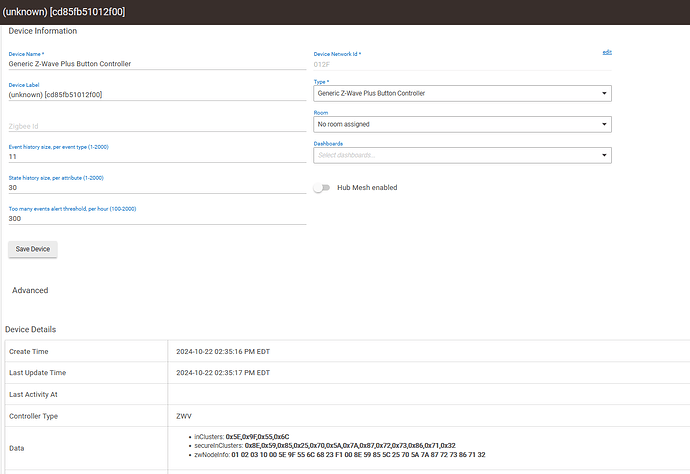

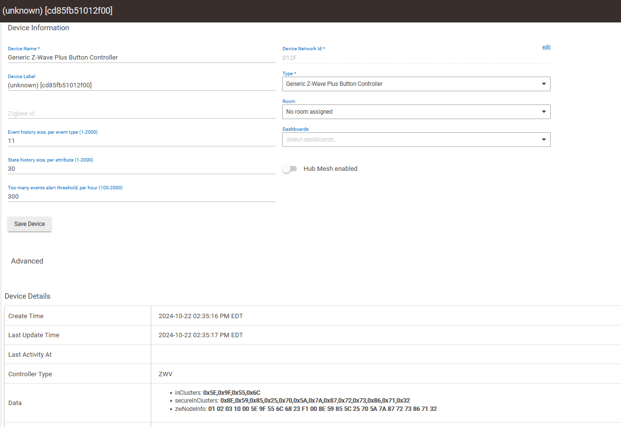

I'm back to the present. Interestingly hitting discover and/or refresh got me an "unknown" device. From a previous iteration, if I Remove it from the device page, it will go to Force Remove, and will just resume its ghost like appearance on the Z-wave details page.
Any suggestions?
Yes you would have to either do an "exclude" on them or factory reset. You can exclude devices on any hub even if not included on it, it will wipe out the attachment to a hub so you can include it again with doing a full reset on the device.
Correct.
Are you sure there is not a device on that node still? Usually the discover only works if a device responds, especially suspect since the clusters info populated. Unless it is cached in the radio. Although I did have this happen on a regular node on anther hub to me not too long ago, so could be a current platform bug.
I'm not sure of anything-maybe "Refresh" only did it...I don't really know.
