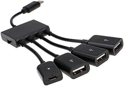

Seems like the multi port OTG is worth a try...
Plug both external sticks into that and see what you get. Then report back to us, of course :smiley:

@csteele The usb hub does work but the C5 will only recognise the external Z-wave stick, not the Zigbee stick... so you are forced to repair all of your zigbee devices. Luckily for me this was doable as I have 24 and they are all in accessible or not too hard to access places... however for Z-wave... I absolutely cannot afford to re-pair them as I have over 100 and some would require a builder to come over to get access to them
