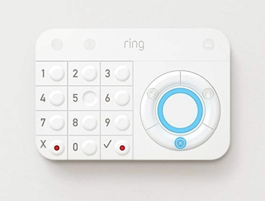

Or the Ring Alarm keypad? It's zwave. I have one brand new. @mike.maxwell if I ship the Ring keypad to you, could you get a driver? Then ship back the keypad? Actually I have the motion and the repeater, never used them.
