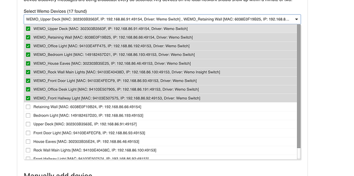

@jason0x43 Hey I just caught up with this and updated all of the drivers and app, When I run the app, I see a lot of dupes or what I think are dupes. Do I need to add them or is it unnecessary? Retaining wall is the one where it looks like its finding a different MAC address but the IP/Port are the same. I still have a couple that are not found but I don't think there is a fix for that. Happy to send you one of those as well since I have an extra.

The duplicate devices are happening because, unbeknownst to me originally, WeMo devices have two MAC addresses. One is (usually) received in SSDP messages, and one is listed in the devices UPnP setup data. I had originally been using the SSDP one, but given that users were having issues with SSDP in newer devices, I switched over to using the one from the UPnP setup data. Devices are identified by MAC address, so that changed the device IDs. So, the newer device entries are the better option to use in the long run.
