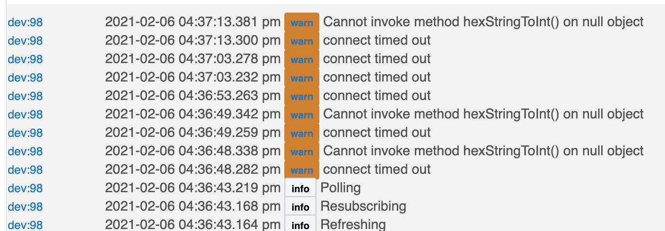

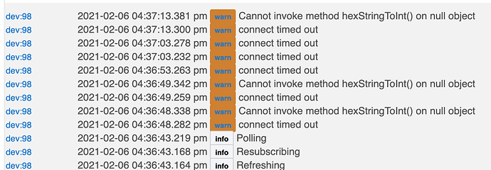

I have a variation of the null error on my Insight Switches. I tried turning it off then on again, and here's the log:
It comes up every turn on/poll/refresh event.
Check if you're using the latest version of the Connect code (last updated 2021-02-03, 09:30:57-0500). The most recent update has some fixes related to string conversions.

And it's still reporting, although today I'm also getting connection timed out as well?
OK, latest update.
The hexStringToInt() is now intermittent, and the connection timed out warning just stopped happening a few hours after I posted :man_shrugging:
