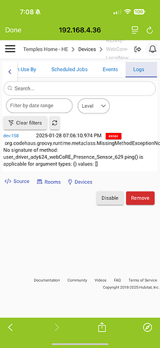

That has never worked for me since making the IDE local… although I’ve always wished it would. This is what I get when clicking “open dashboard”…
