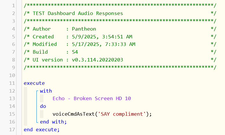

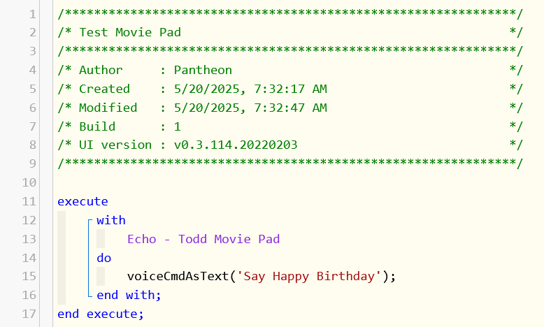

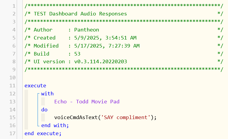

This is probably not worth the effort to pursue. I just noticed this behavior and really just mentioned it in passing. Please don't spend much/any effort on this, but here is the process...
  1. Create this piston with an Echo Speaks pad device (Todd Movie Pad) and Save.
TEST the piston....the voice on the Todd Movie Pad says "happy birthday", as expected.
2. Open another webcore instance and edit the above piston. Change the device to a different Echo Speaks pad (Broken Screen HD 10) and Save.
TEST this piston...I was expecting the second device (Broken Screen HD 10) to announce "happy birthday" but it came from the first device Todd Movie Pad.
3. Edit this second piston again and Save, making no changes.
4. TEST this piston again. Now it announces from the expected pad (Broken Screen HD 10).
