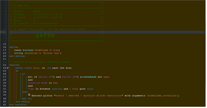

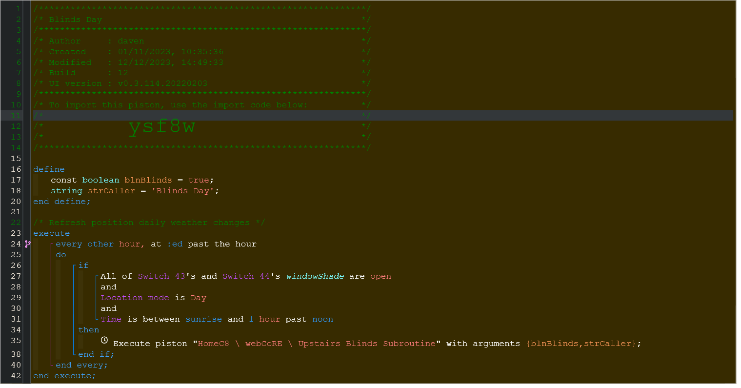

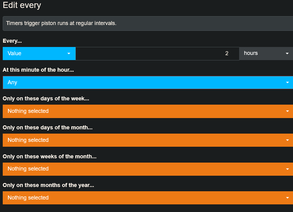

I see when I edited the seconds it said Any not 0 as I thought I had selected.
I corrected and it looks ok so, "Any" produced :ed

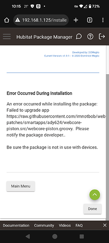

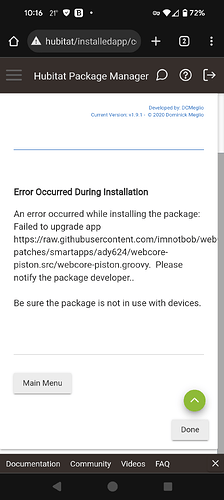

Having issues updating and upgrading webcore.
I'm doing this through HPM but it doesn't seem to matter and keeps failing attempting to upgrade or repair.
I am having same issue. I tried a repair and that gave me the same issue. I then manually imported the webcore, the webcore piston, fuel stream and storage.
HPM still shows I need an update. One thing I noticed, in doing a manual save of the webcore piston, it took a long time to complete. It always bombs in the HPM update at the webcore piston. Could the long save time be causing this?
I just tried one last update on HPM and the same thing happened.
It seems the timeout associated with HPM is too short. I have started a discussion with the HPM developer, but it appears we may need help from Victor in regards to raising the timeout
So in the interim either do not update, or update the files manually (which is also discussed in the thread show below)

I've tried to install webcore-piston.groovy and I got this message:
So, I believe that the problem is with HE software itself.
Hope this information helps.
EDIT: C-7 firmware 2.3.7.14
NEW EDIT 2023-01-08
The above error occurred when I tried to update the driver manually, downloading the code from github and trying to save.
