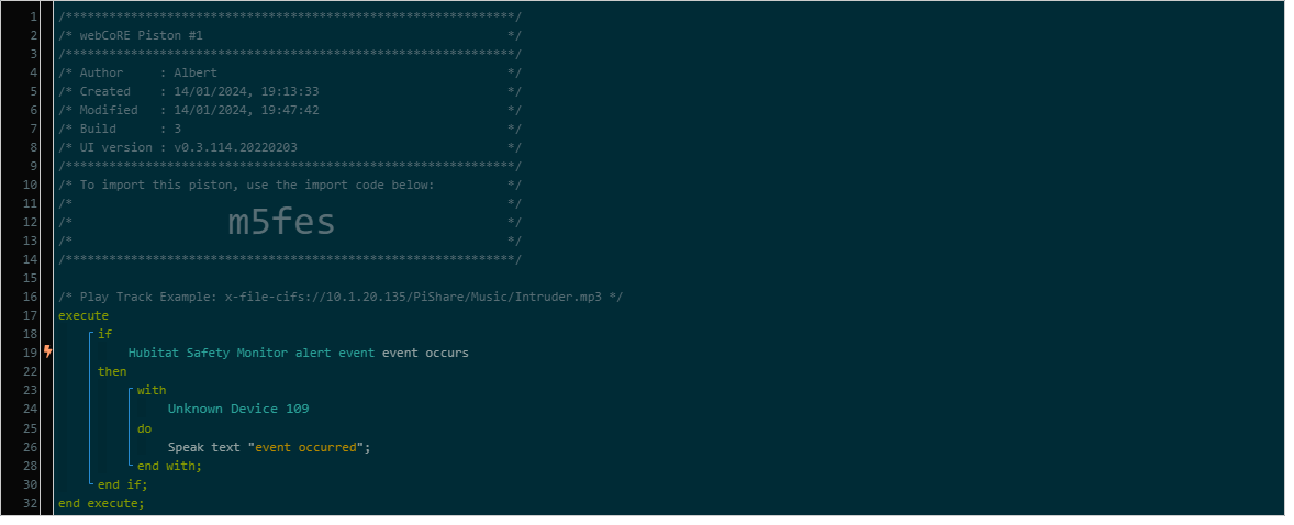

Updated to 2.3.7.145 on my C8 and it looks like some code has been changed to HSM.
I am now unsure what my last working version was it was a few months ago that this occurred and I only recently got time to look into the issue.
With webcore previously i was able to use the HSM alert event "Intrusion Away", and "Intrusion-delay"
but it looks like the only alert events that are pushed through are the armed and disarmed alerts.
Can you tell us how we can get these intrusion delay and intrusion triggers working again with webcore.
Below is a quick piston I did to checking it HSM even executes the trigger anymore, and it never triggers on any intrusions.
Really need this working again. If you can get with the webcore people and get this resolved. and just let me know its being worked on and maybe after its been fixed. Willing to test as needed as I run the user version of webcore. not sure if the firmware needs to be updated to support this again.
Please don’t cross post. webCoRE for Hubitat Updates - #1932 by albertjmulder
Look in your Location Logs, mine appear to be combined with the mode, i.e. intrusion-night.
I posted a fix for alert subscriptions today, if you run user install you can hpm repair (or manually install if on recent beta releases)
