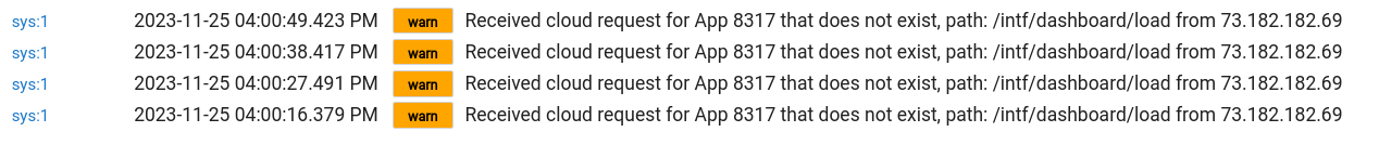

I removed webcore yesterday, just noticed that I'm still getting pings from the online portion about every 10 seconds. How do I stop this?
